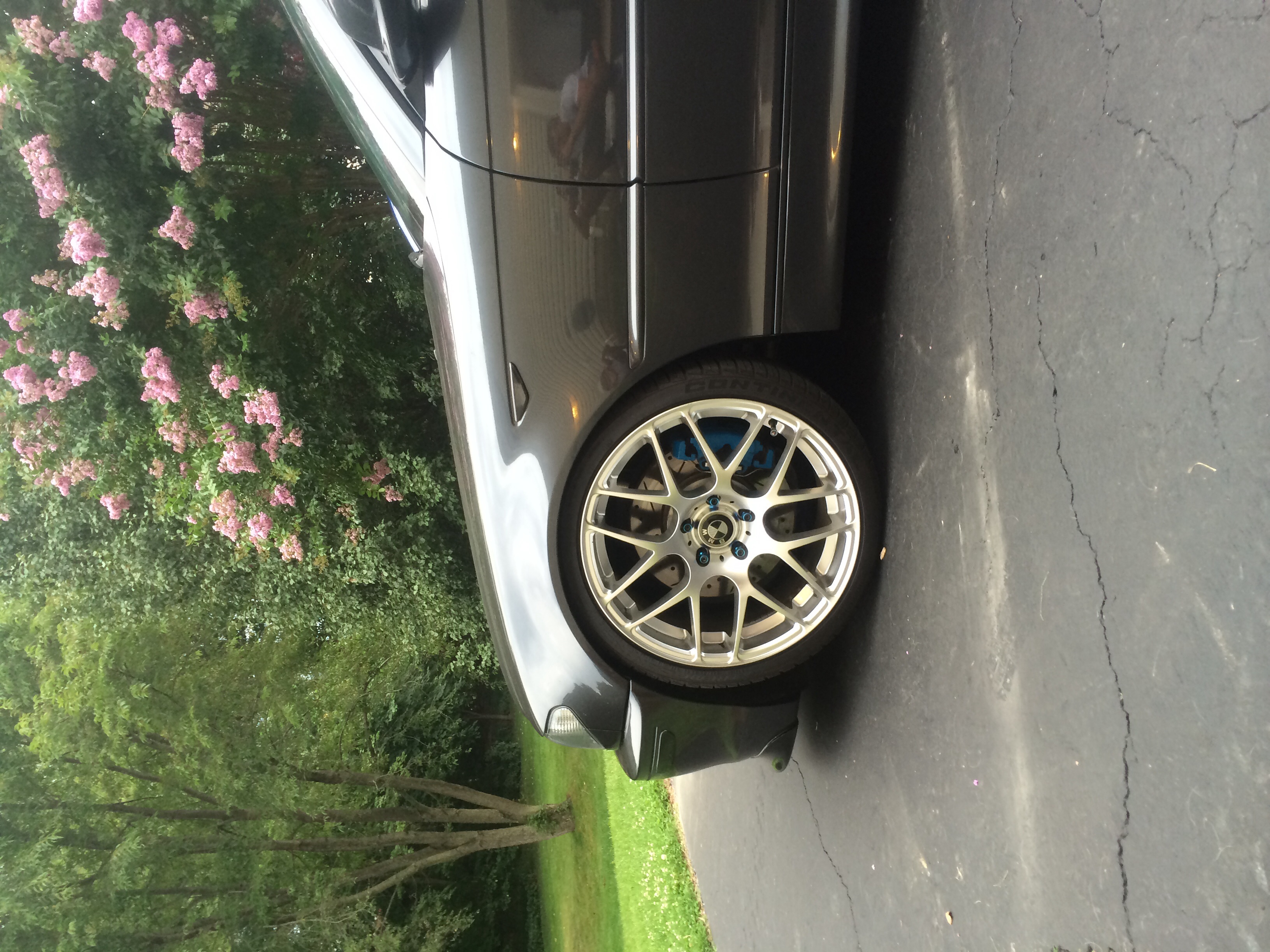

And then lowered on PSS-9’s
http://www.zhpmafia.com/forums/attac...5&d=1407671004
I been wanting 19" Apex arc8 since Bruce said they are a great fit.
going to a lower offset wheel, say ET38, increases the track width by 24mm.
and i run the 3mm spacer on the back to bring the square wheel setup offsets 'in line' with the stock ratio (so i effectively have increased track width in the rear by 30mm, and 30mm in the front).
in a perfect world i would run 9's or 9.5's in the rear on a 265/35/18, and one day i might, but i would have to run the 18x9.5 ET58 ARC-8s to avoid running into fender clearance issues... but then i might have shock clearance issues, so i'd likely need to run a 10mm spacer... i haven't measured yet. i do run into traction problems with the 245's in the rear, especially with the LSD, because it makes me do stupid stuff. otherwise 245-width PSS' are totally adequate for 235hp. :)
Got it.:thumbsup
I hope to do the LSD eventually... Just not in the budget now though. With the recent Hotchkis F&R bar upgrades I can break the rear loose with a little throttle, so I think an LSD and some wider rubber (275mm) in the rear will round the car out nicely. The trick will be getting the right combination of offset and fender rolling to make it work. I predict a 9.5" wheel at ET38 should clear the shock and fender with a little fender rolling. This is on a non-lowered vehicle, of course.
on a non-lowered vehicle, i think a 9.5" ET38 wheel would stick out past the fender. i think. :) that said, it's an incredibly aggressive fitment, lowered or not - and mega fender rolling would be required. i am going to be doing some very minor fender rolling to allow my 8.5" ET35 wheels to fit without rubbing - imagining another 12.5mm with wider rubber sticking out... no way would it work (for me). :)
Sorry - don’t know why I wrote ET38. I meant ET45 for a 9.5” wheel in the back.
