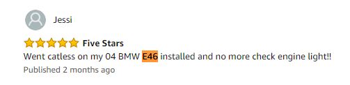

According to the amazon reviews it has worked, i will confirm that at the end of the month :)
I've heard of at least one other person getting it to work but it was a struggle...

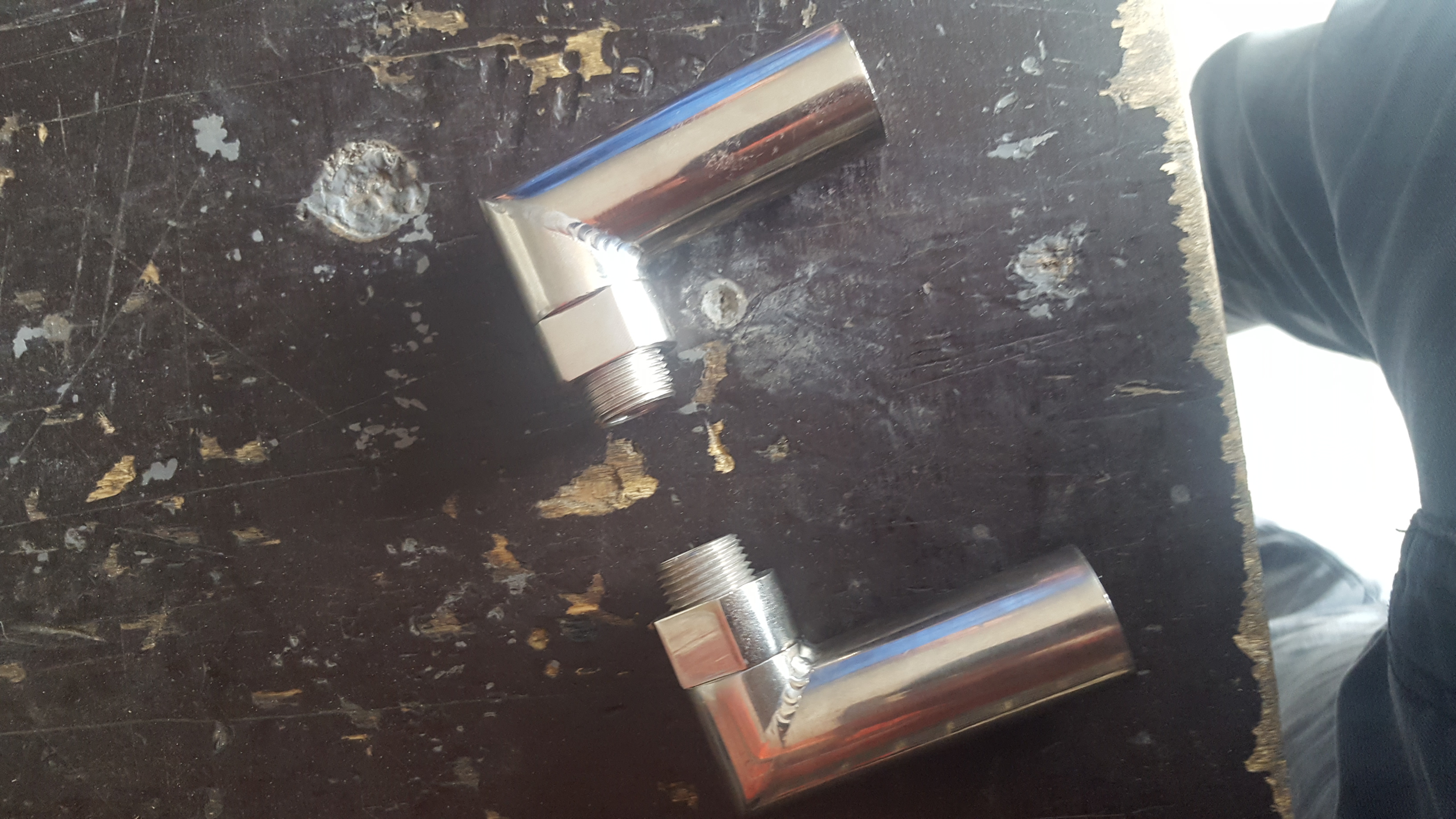

I can confirm they work. I installed a pair of 90deg angled extenders on my ZHP with catless headers (in the rear-most bungs). It is a bit of a struggle to get them to fit, lots of initial loose fitment until you get the angles just right since the space and clearance is tight, and after a few test fits, you'll be able to figure out what angles the extenders need to point. Just remember that these headers are nothing without a tune. I went with Eurocharged for my tune, and have since added a big bore throttle body, and the response is much, much better compared to stock. I have a set of underdrive pulleys waiting to top it off, and that should be it for NA bolt ons.

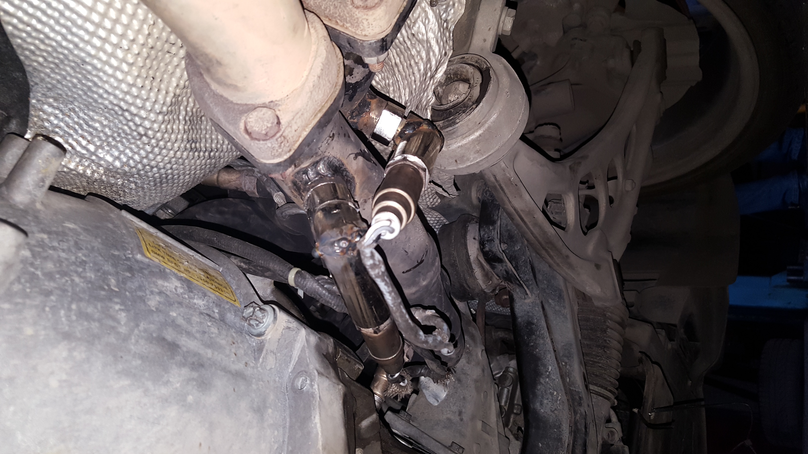

I installed the spacers for the O2 Sensors.I had to cut into half it would screw because i had modified the rear hole.
The car runs great, i also did the adaptation erase of everything. The only problem i have are the throttle body boots, they bend when i accelerate. Most say it is due to the boot quality. I will check that tomorrow i'll install another pair. As for the headers torque increase is humangous :D as for the acceleration and HP wise can't test is fully due to the boot mentioned above. Another thing CEL light hasn't showed up since then :) but when running obd2 scanner it reads rear banks lean and stuck. Maybe due to the spacers leading to incorrect values but no CEL and engine runs smooth as rear O2 sensors don't contribute to AFR as i thought. The only purpose is to check catalytic efficiency.
