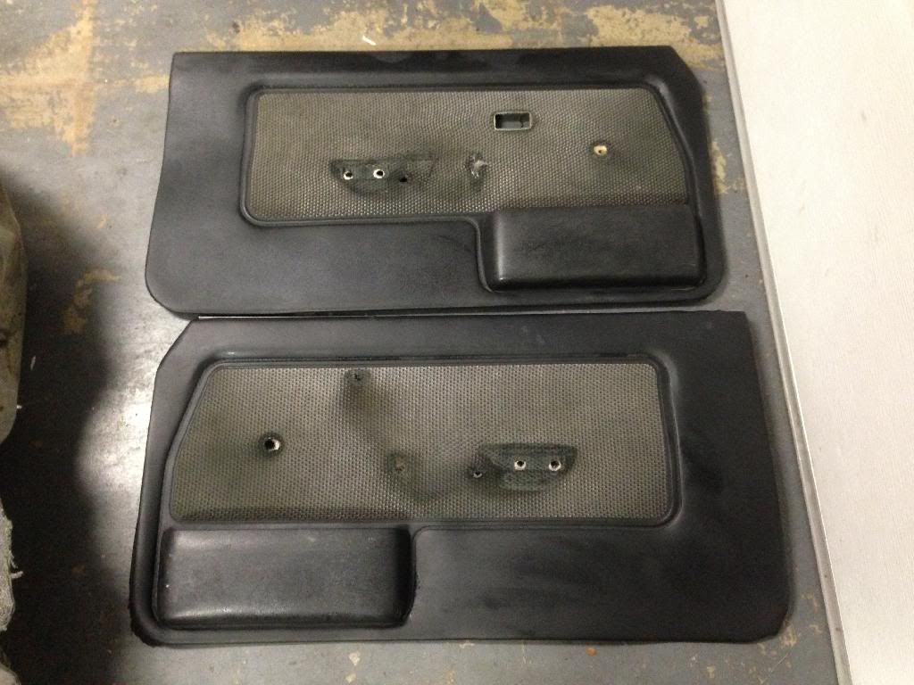

Door cards to match the Recaro's (will have to clean those up too)
http://i29.photobucket.com/albums/c2...0331E4109D.jpg

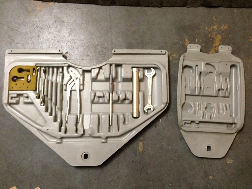

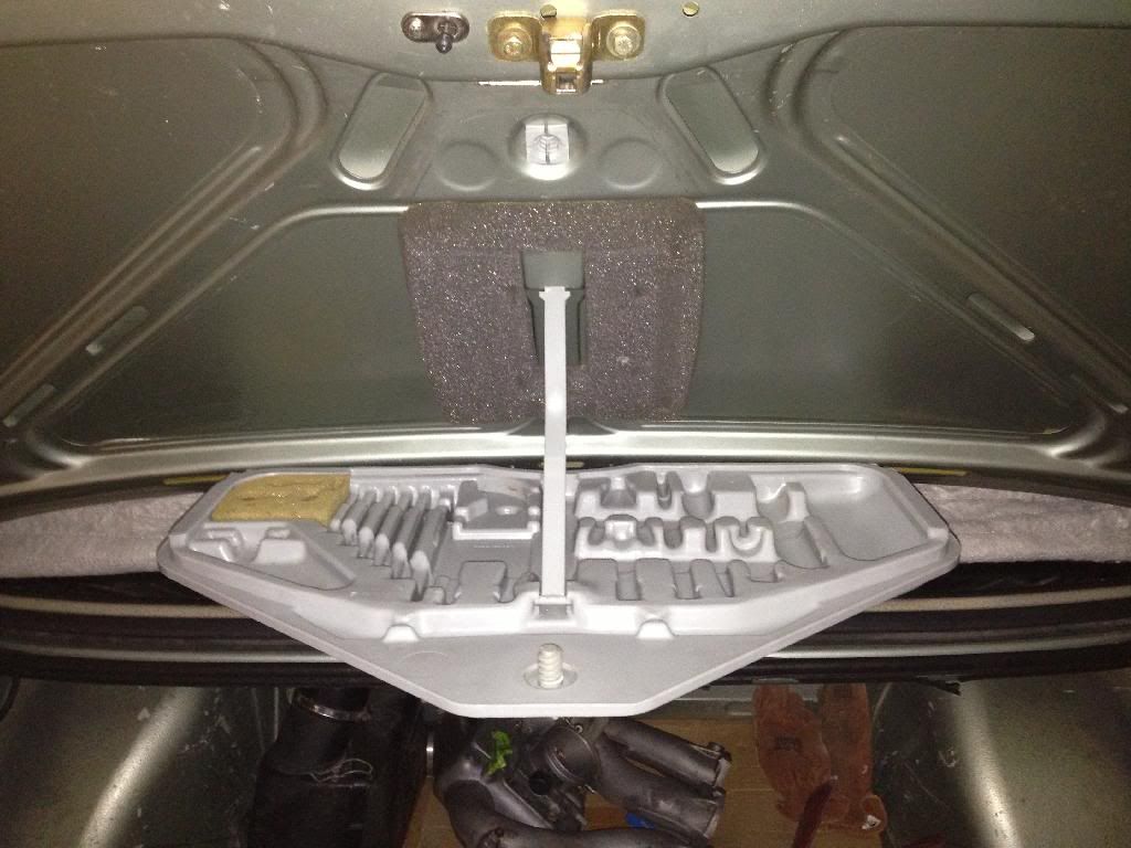

Large tool kit to replace my small one
http://i29.photobucket.com/albums/c2...FBFEE76FD6.jpg
After I took that pic I realized only the spark plug wrench fits correctly, I'll order the correct tools
http://i29.photobucket.com/albums/c2...B2D5F62F28.jpg
Tools and new foam cost $167 from ECS, I'll call Carl and see if he has any in stock at his shop since he gives me way better pricing

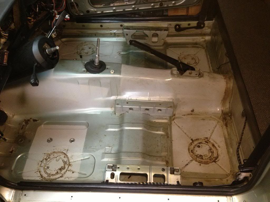

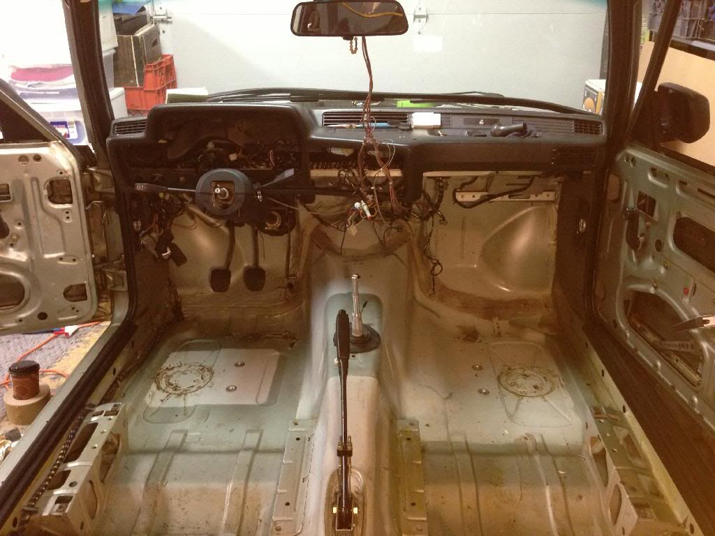

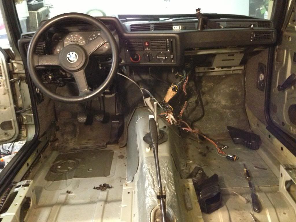

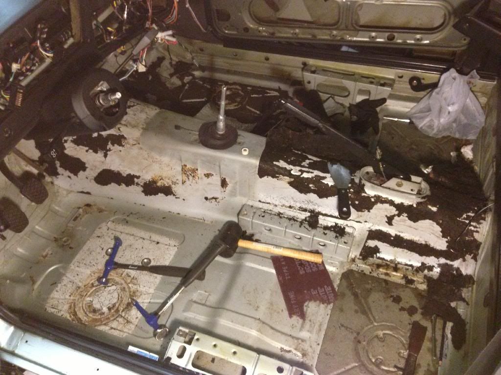

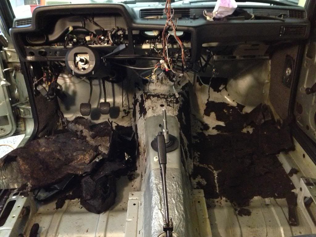

So I pulled up the carpet, pulled the sound deadening foam
http://i29.photobucket.com/albums/c2...653EA7B779.jpg
Began removal of the tar shit (super annoying)
http://i29.photobucket.com/albums/c2...CC6887D728.jpg
http://i29.photobucket.com/albums/c2...E32D82DAE8.jpg
Finally got that done last night
http://i29.photobucket.com/albums/c2...927B4641BF.jpg
http://i29.photobucket.com/albums/c2...13959F3E95.jpg
I'll be prepping this with a layer of Rustoleum to be safe, then this stuff will be installed
http://i29.photobucket.com/albums/c2...1404744C3A.jpg

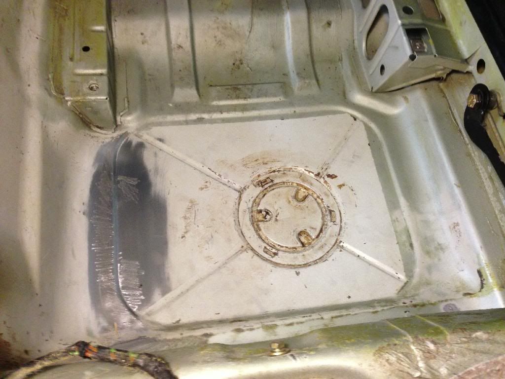

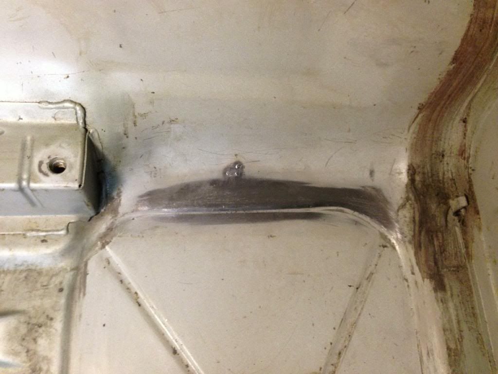

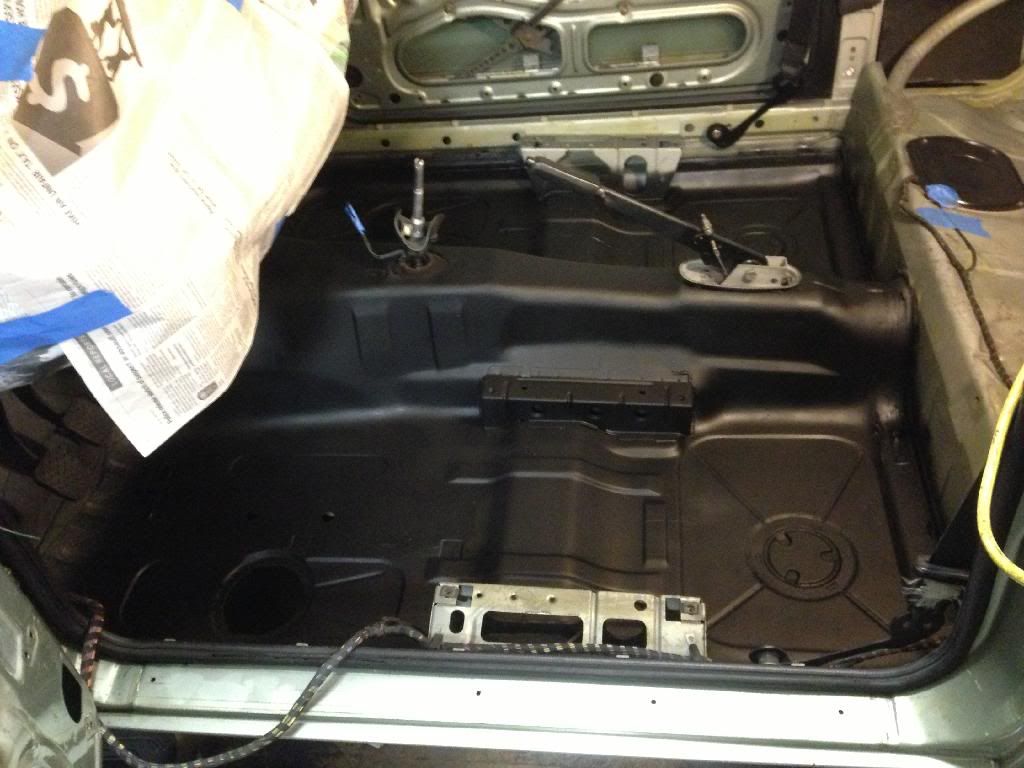

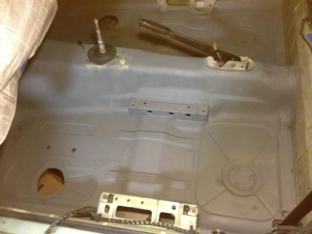

Today I finished cleanup of the interior
Got rid of all the surface rust
http://i29.photobucket.com/albums/c2...E956DC218E.jpg
http://i29.photobucket.com/albums/c2...912F6E907D.jpg
http://i29.photobucket.com/albums/c2...F85C45758D.jpg
Then came Krylon Rust Tough Enamel
primer
http://i29.photobucket.com/albums/c2...ED496651F4.jpg
http://i29.photobucket.com/albums/c2...D8B1DF378F.jpg
1st layer of paint
http://i29.photobucket.com/albums/c2...F0610D46C7.jpg
I'm gonna let it sit for an hour before I spray another layer, then I'll start with the sound deadening

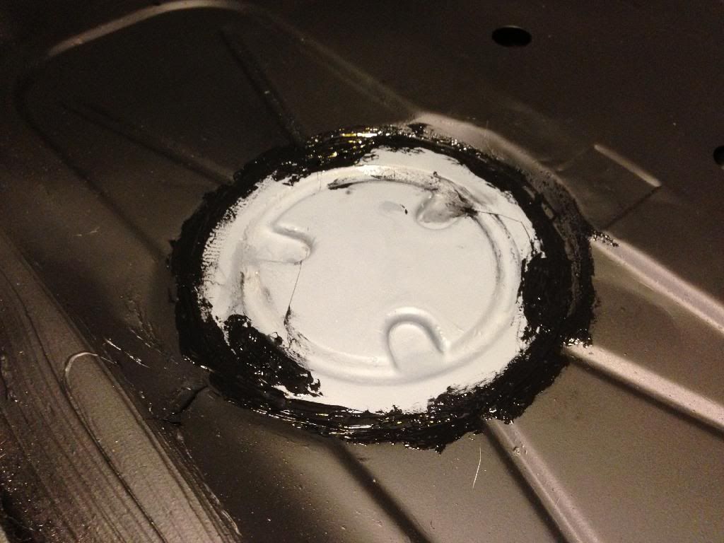

Right now I'm sealing these back up before I spray another layer of paint
http://i29.photobucket.com/albums/c2...85BE840213.jpg

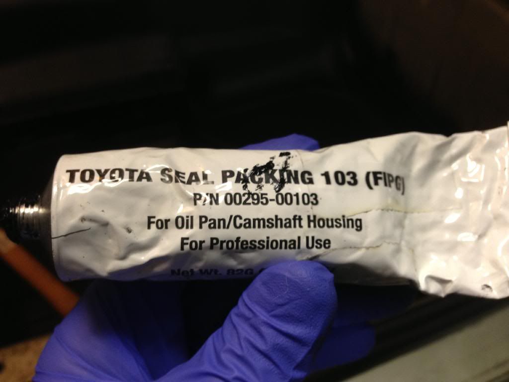

And in case anybody wants to buy some, this is by far the best RTV around
http://i29.photobucket.com/albums/c2...6A3A99214C.jpg
Just go to your local Toyota dealer and ask for that pn
What's special about it?

Dario, it's a special formulation of Permatex made for Toyota. I've never had any issues with it so I keep using it. Basically years ago I needed to do something with RTV and Carl told me that's the only stuff he uses. If after 40 years of working on BMW's he decided on this it's good enough for me.

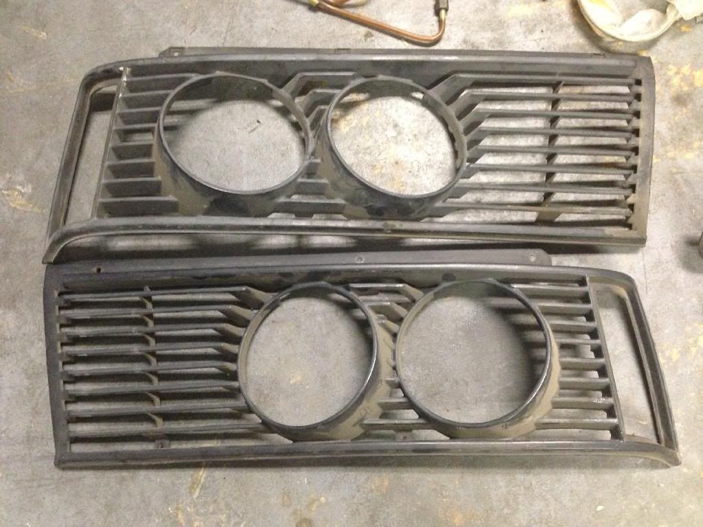

yesterday I picked up some random parts I needed
non-cracked grills (mine had some slight issues, replacing because I might as well do it now)
http://i29.photobucket.com/albums/c2...5F412F61E9.jpg

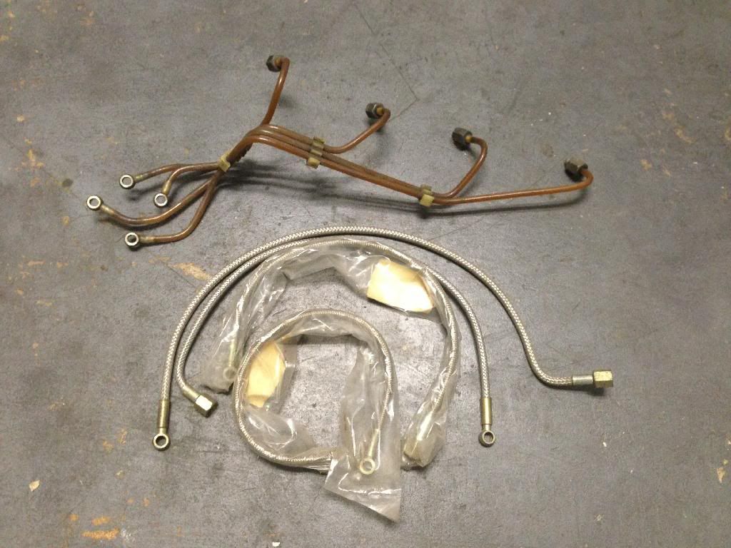

NOS VW K-Jetronic braided fuel lines to replace those nasty 30+ year old plastic ones BMW used (got them cheap since nobody buys them, they were at a local VW shop)
http://i29.photobucket.com/albums/c2...2122BCF49E.jpg

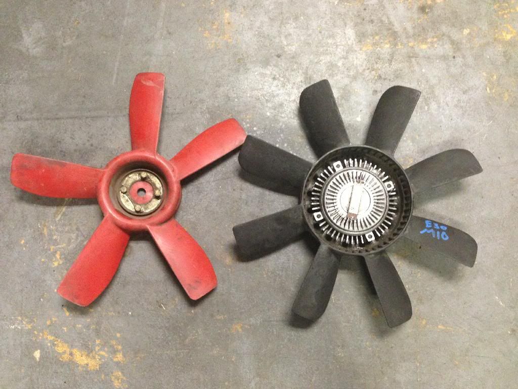

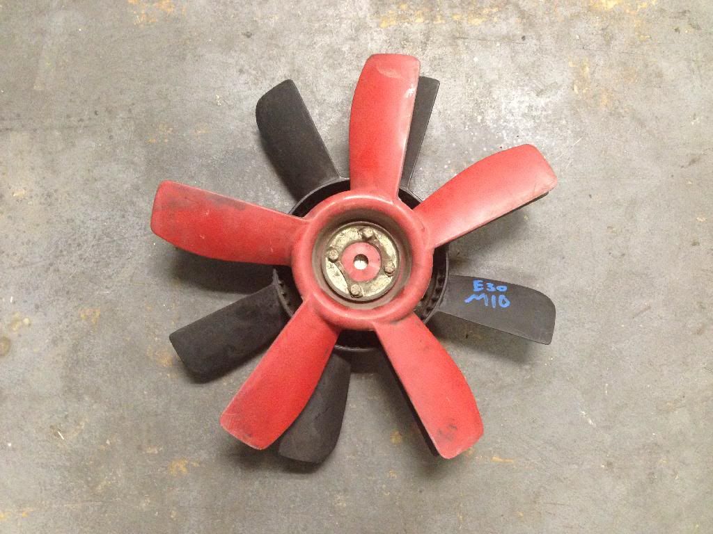

E30 M10 8 blade fan w/clutch to replace my 5 blade static fan
http://i29.photobucket.com/albums/c2...AEB5A2CAFB.jpg
same 400mm size
http://i29.photobucket.com/albums/c2...4F56F49149.jpg
If any 2002 guys on here want my 5 blade fan to replace their 4 blade one let me know, otherwise I would definitely recommend the E30 wp/fan upgrade as you free up some horsepower at RPM's when the clutch disconnects and the fan spins freely
Is that red fan some kind of defective one? No way that thing is balanced properly...the angles are completely wrong LOL!!
Hahaha, 1970s tech bro...
Made with crayons and a slide rule while drinking beer ;)
So it's really crooked and not an illusion? That's ridiculous.
Sent from my GS3.
It's fine, that's actually well designed for the tech available at the time. Here's a Mercedes patent that explains it better:
Here's a less understandable explanation from Hitachi:Quote:
The unequal spacing angles minimize noise produced by the fan assembly. The blades are positioned at a radial location along a blade span by unequal setting angles which increase the efficiency of the fan assembly.
US Patent # 5,681,145
Quote:
A wheel or rotor with a plurality of blades arranged at irregular or unequal pitch angles circumferentially of a disk, a hub or the like, wherein the characteristic level e.sub.k representative of the order-of-harmonic characteristic of blade pitch is defined by where ##EQU1## Z=a number of blades k=1,2, . . . and n; n.gtoreq.Z .theta..sub.j =the angular position of the tip or root of each blade defined in terms of a central angle subtended at the center of a circle, which is the axis of said wheel or rotor, by an arc extended from a reference point on said circle to said tip or root of each blade on said circle, j=1,2, . . . and Z; and the characteristic level e.sub.k satisfies the following conditions ##EQU2## where e=-13.14 log.sub.10 Z+99.70 k=2,3, . . . n.

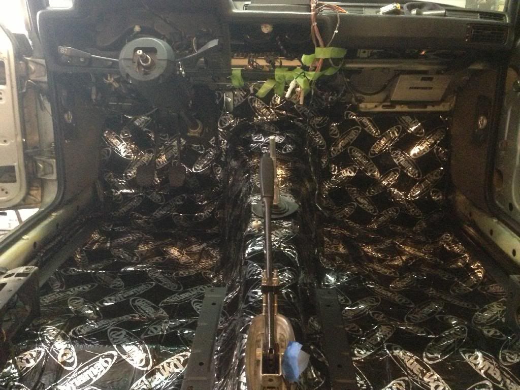

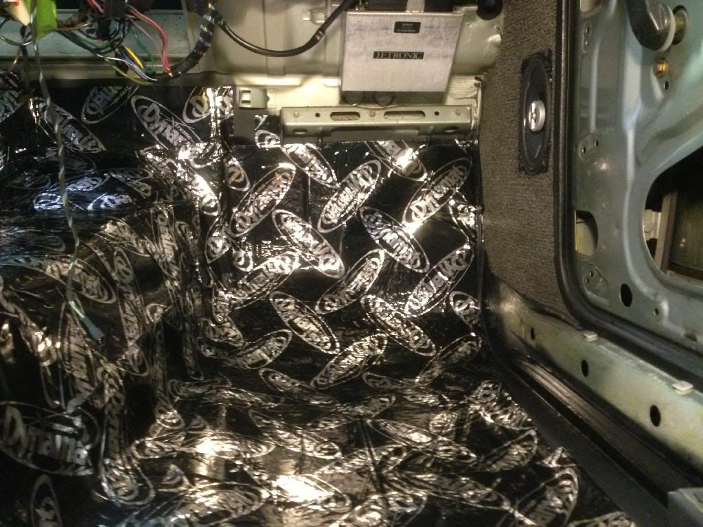

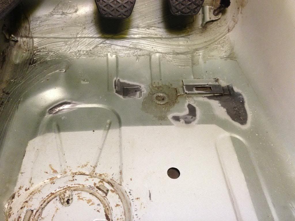

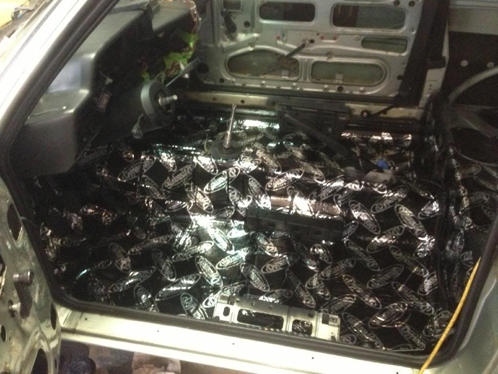

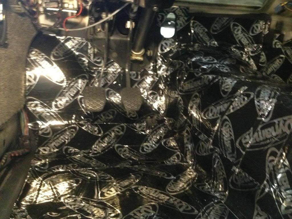

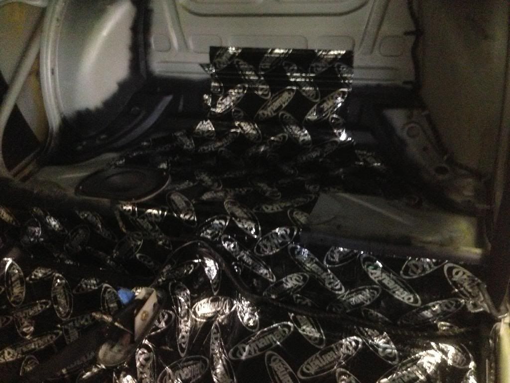

Dynamat installed
http://i29.photobucket.com/albums/c2...FE7E1015FD.jpg
http://i29.photobucket.com/albums/c2...B3EC6554ED.jpg
http://i29.photobucket.com/albums/c2...04080F53FA.jpg
http://i29.photobucket.com/albums/c2...53EF101CB7.jpg
http://i29.photobucket.com/albums/c2...105E3B26F6.jpg
I need a few more sheets, I should've probably bought the mega pack instead of the bulk pack (72 sq ft vs 36 sq ft). Not sure if I want to buy the bigger pack and use what's left on my 2002, or just stop at a car audio place in town and pick up a few sheets.
Next step is Dynaliner and Dynapad.
