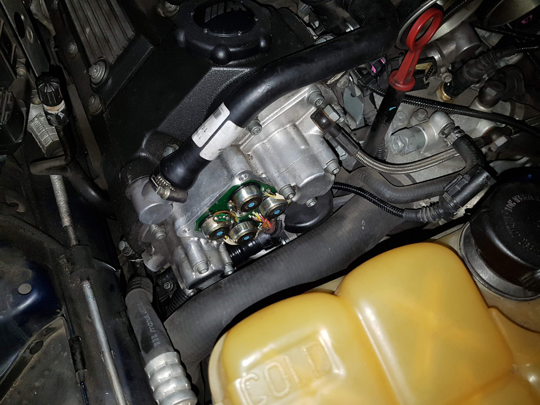

Did some preventive maintenance on the M5 as well by servicing Vanos solenoids.
Vanos boards removed from the engine.
https://s22.postimg.cc/eu5xzqlht/20180710_202505.jpg

Removed old O rings and mesh filters. Activated each solenoid with 9V battery and thoroughly cleaned them with brake cleaner and compressed air. Slapped new O rings and reassembled everything on the car with new gaskets for the cover.

A vital part of maintenance to keep the beast running perfectly.
