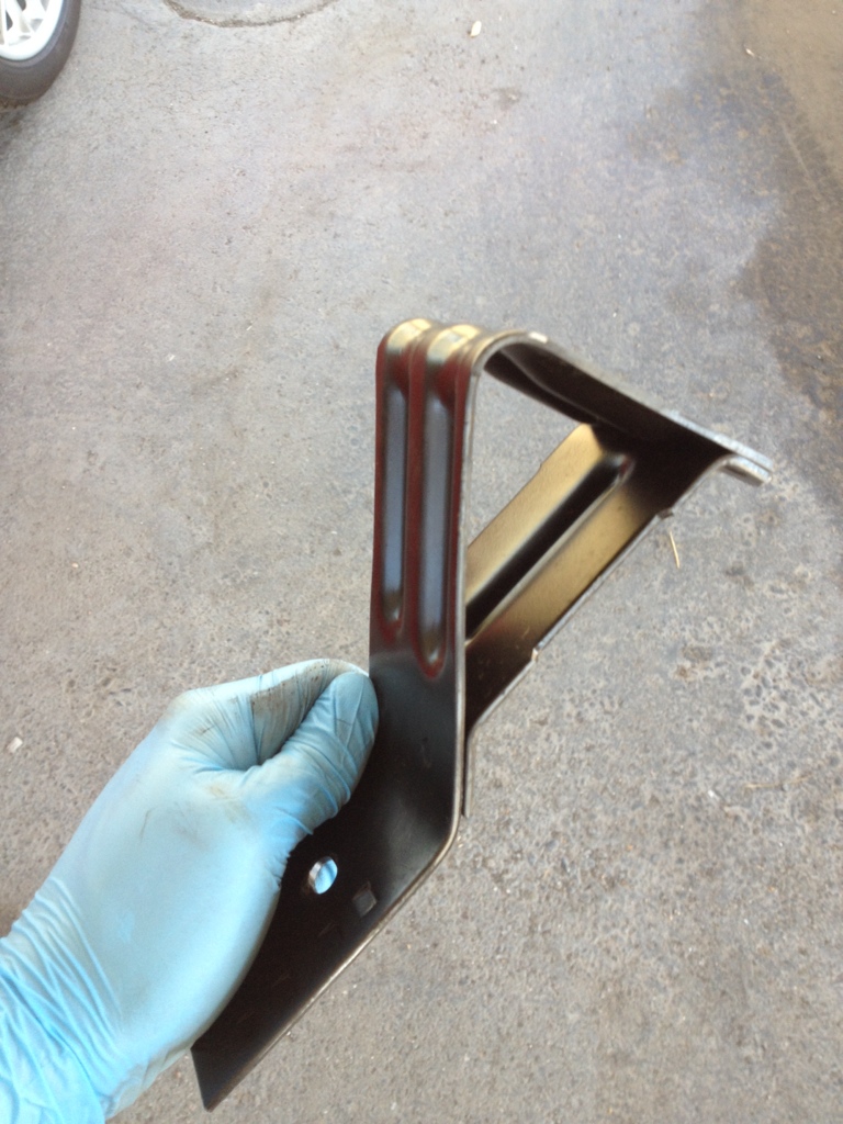

What uhh...what's this? It's bolted to the frame near the jack. Looks like a simple stopper to put under the wheel while it's jacked up?
That's exactly what it is, a wheel chock

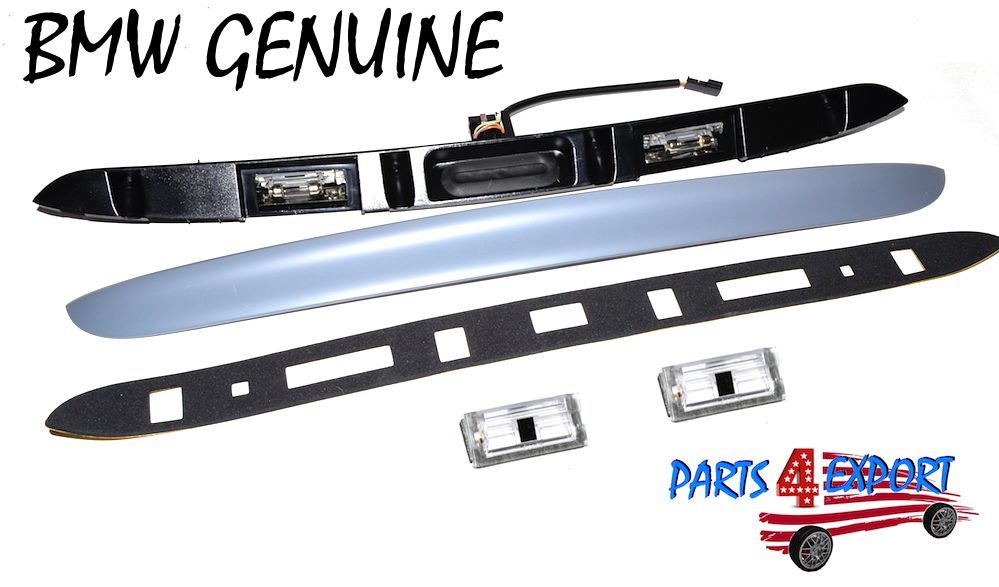

Ok. First gremlin that needs to be fixed IOT pass VA state inspection. the right livens plate bulb is out. Looks to have melted at some point. I'm not sure if this piece can be swapped or not. Can't seem to find it on realoem.
Left side works.
Any ideas?

I found a threat that recommends running wires from the other side and another that said just replace the whole $90 part.
You can buy the new piece and separate the painted piece and install that instead of paying for new paint.

Thanks guys. I've been trying to separate the painted cover but man it doesn't want to come loose. Anyone ever done this? I can't find a DIY.
Attachment 15116
Hairdryer and a sharpened screwdriver. There are six clips holding it on. Work from the ends into the middle.

Got it. Dropped the trunk liner and disconnected the trunk grip mechanism. Heat gun, flat tip and non-marring pry tool did the rest.
