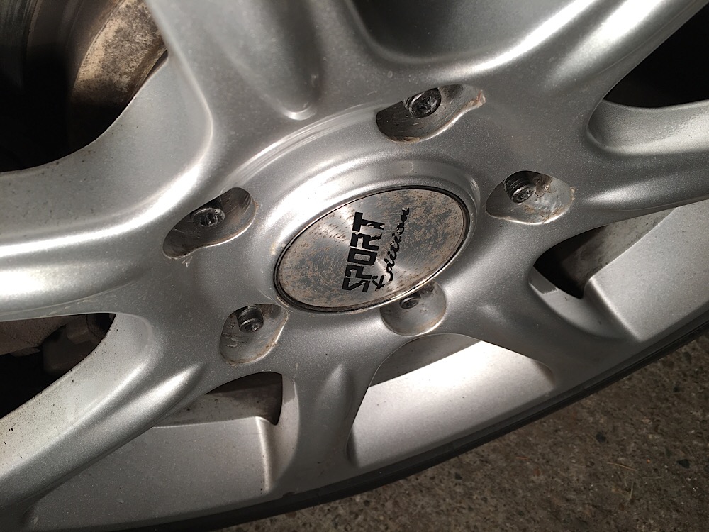

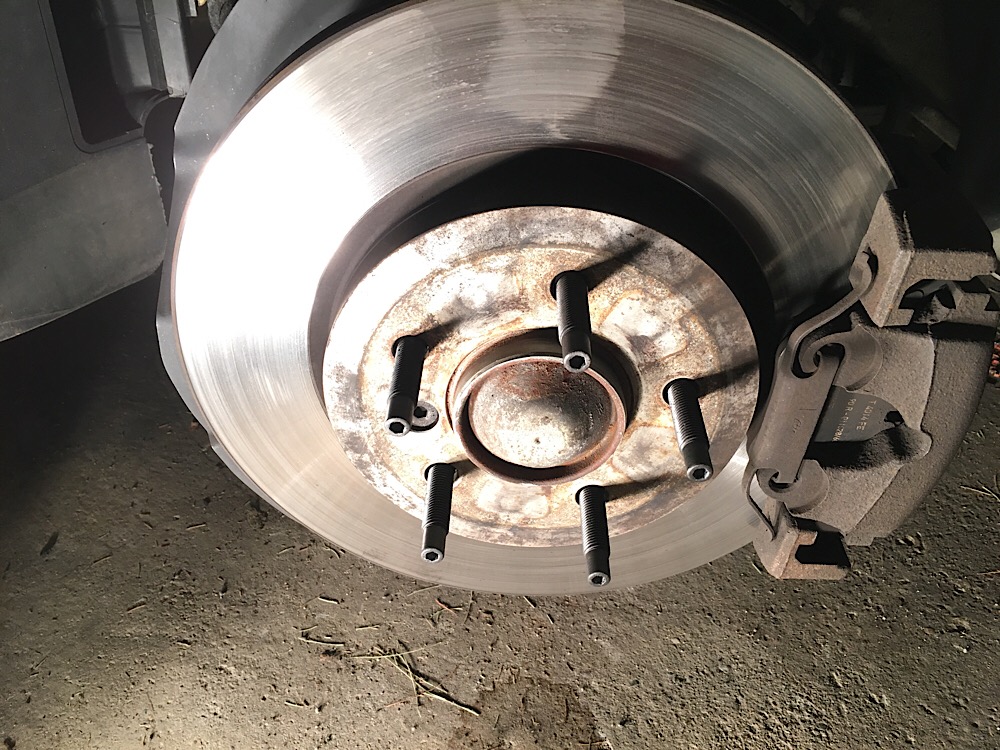

Did a wheel stud conversion this morning...
Attachment 32588
I like the fact that these don’t stick way out. (Pardon my shitty winter wheels.) :)

Thanks for the confirmation Trevor! They’re going on Sportline 8s 18x9.5 ET45 wheels, which hopefully will be in hand by the end of the week. Fronts will be 235/40/18 on 18x8.5 ET45.
I can’t remember if I needed to just unscrew the rear bumper clip that is responsible for hooking the rear bumper to the rear fender. But even when it’s off, there is no sign of bumper droop. Just shave that stud down and you should be dandy.
