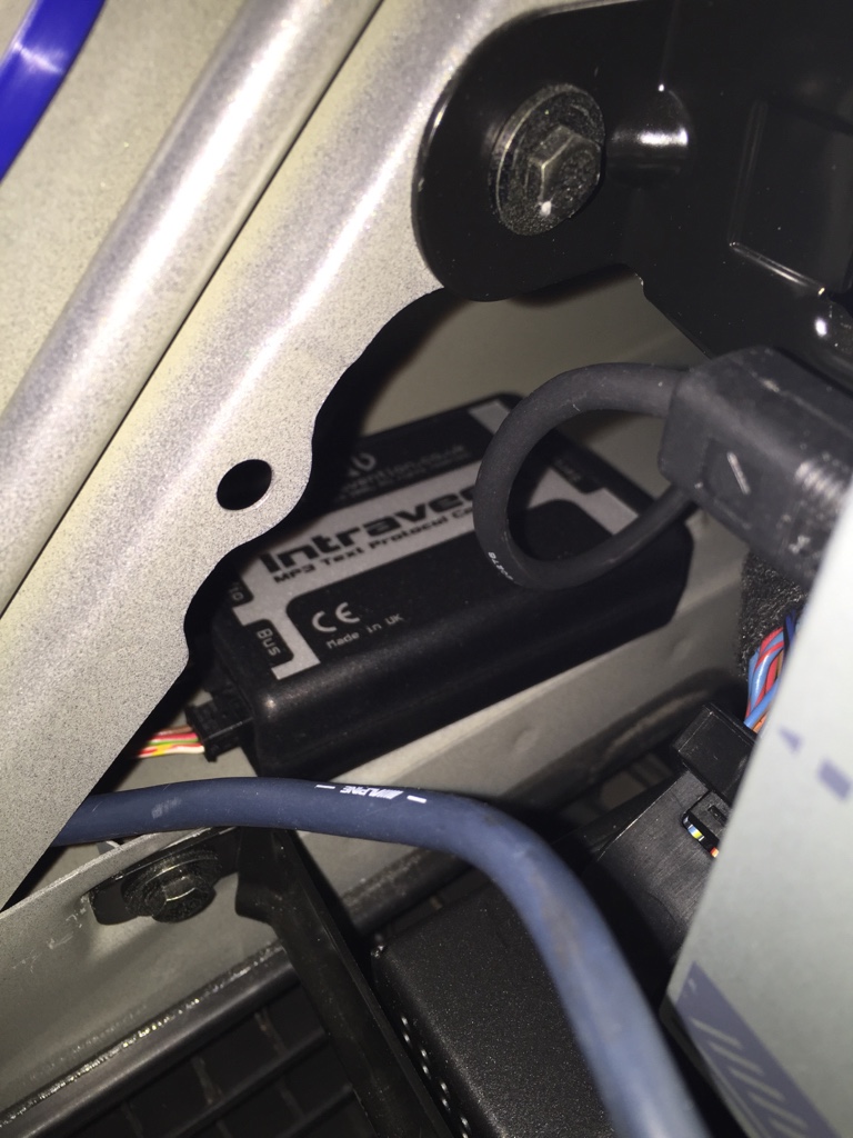

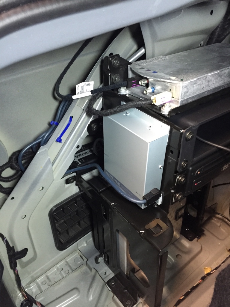

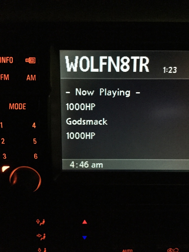

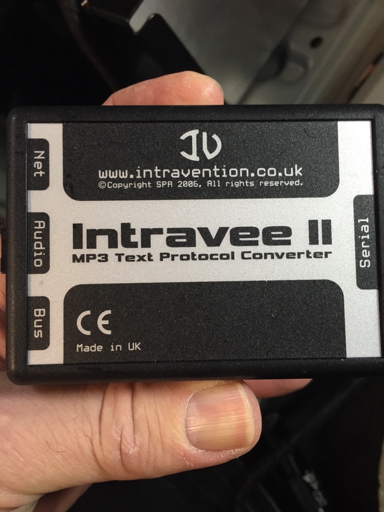

Bought Benny's Intravee II and Alpine KCA-420i to use with my factory Nav. Installed it last night and it's Awesome! Thanks to Charlie for telling me all about this setup. Very easy to install.
Attachment 17812
Attachment 17813
Attachment 17814
