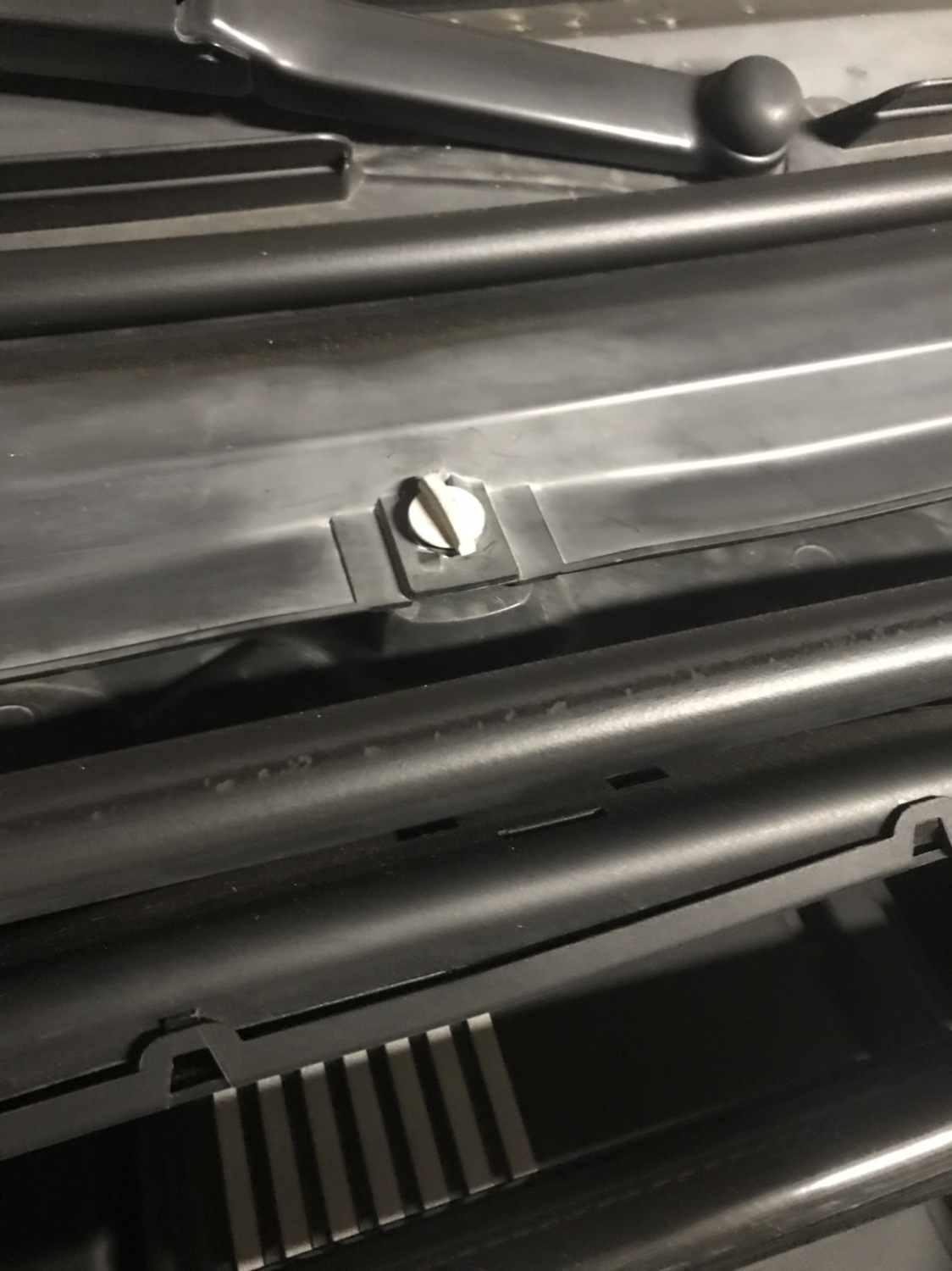

Got some new spring clips from the junk yard for both ZHP and ZSP.
Before
Attachment 35600
After
Attachment 35601

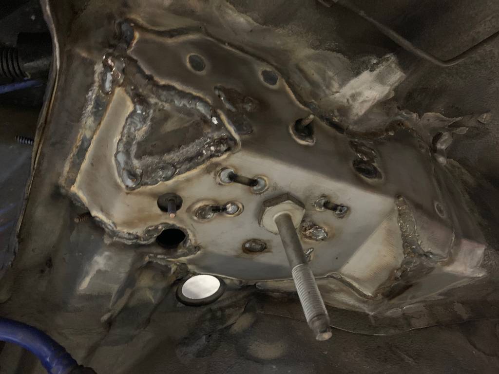

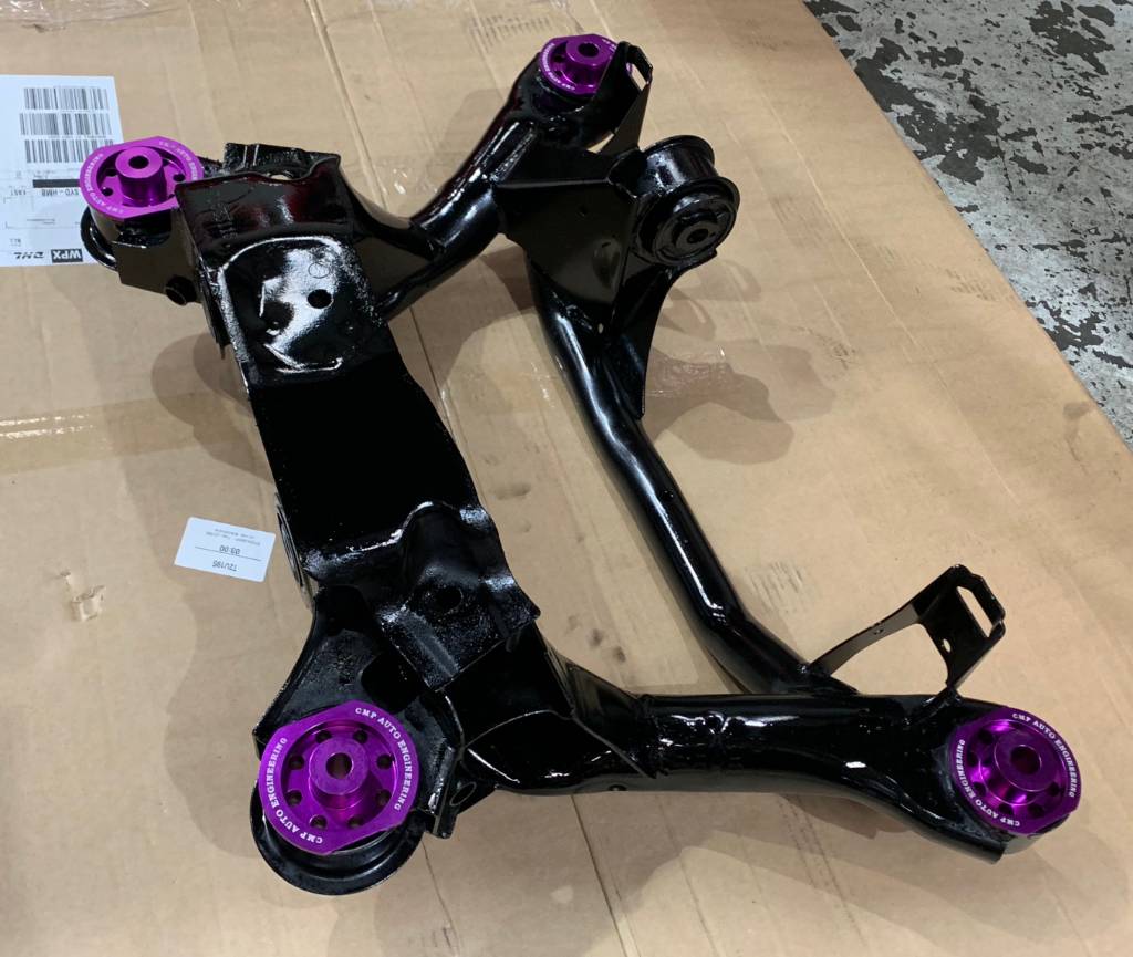

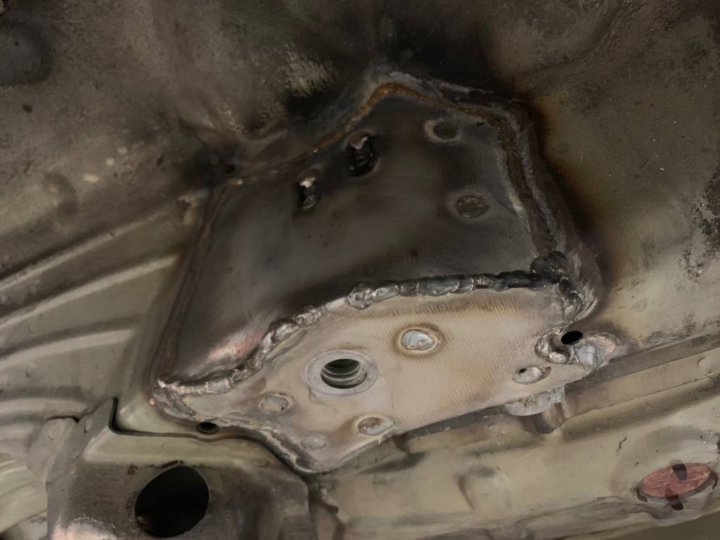

Subframe work is done (stage 1 at least). Need to drive it more this weekend but first impressions is that it feels much more stable and solid in the rear. Less roll when under load and less squatting (could be due to work subframe bushings being replaced with solid). A mild increase in NVH but I wouldn't say it's enough to be a drawback.
Photo when I went to pick the old lad up. Photos as well of process.
I went with CMP Auto plates and subframe bushings. OE diff bushings. Attachment 35635Attachment 35636Attachment 35637Attachment 35638Attachment 35639
