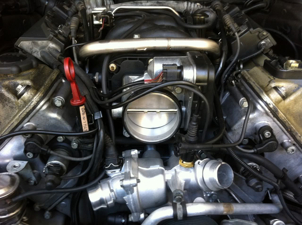

^wow. The M62 is pretty similar to an S62.
Are you doing a M60 manifold swap on that car?

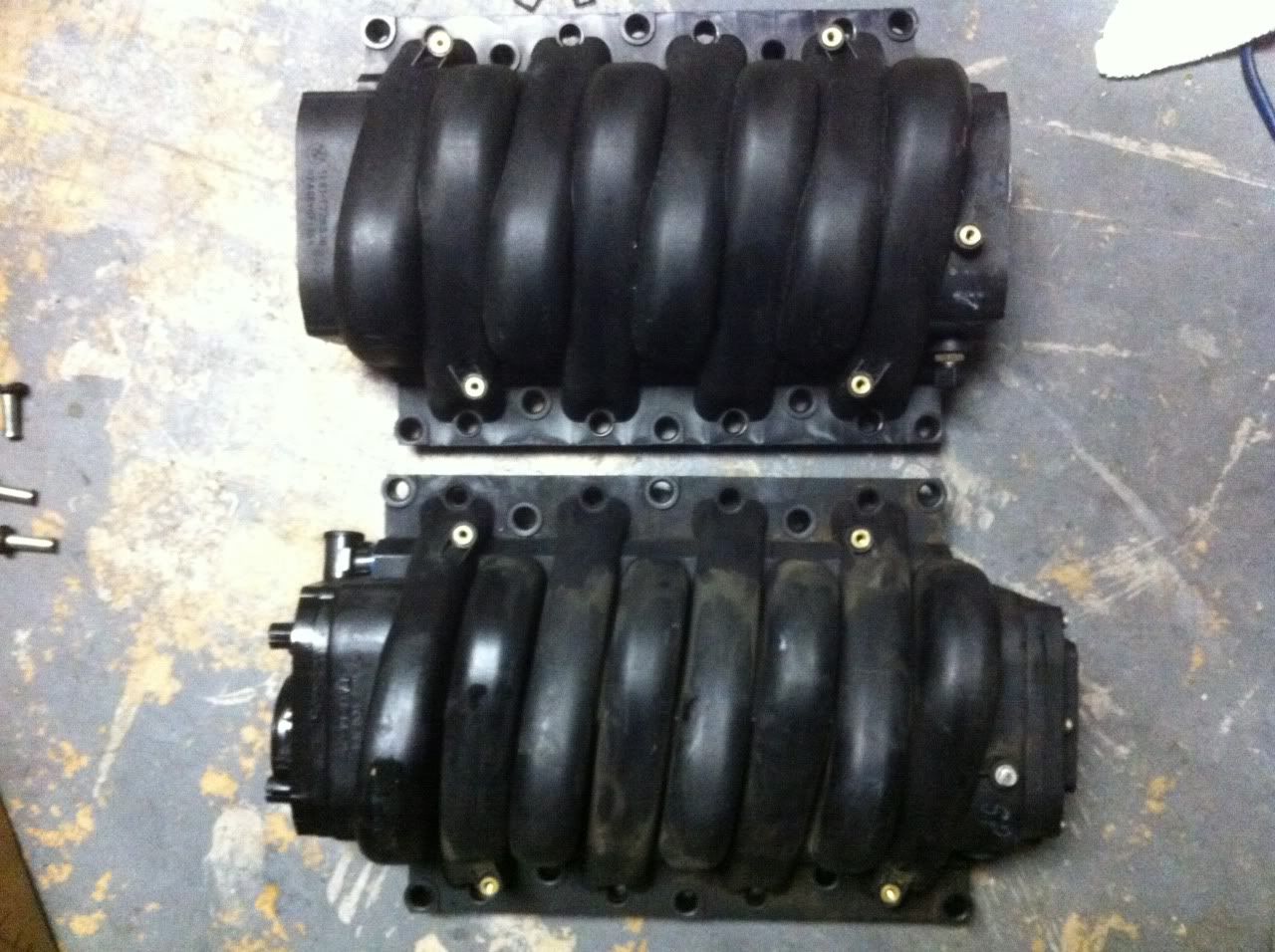

yup - along with valley pan gasket, new OSV + seal, cleaned the hell out of the throttle body + new seal, lots of new vacuum lines, and full coolant system to round out the job.

non-VANOS on top:

already did it once :(
I just pulled the water pump back out and I could realign the pipes
