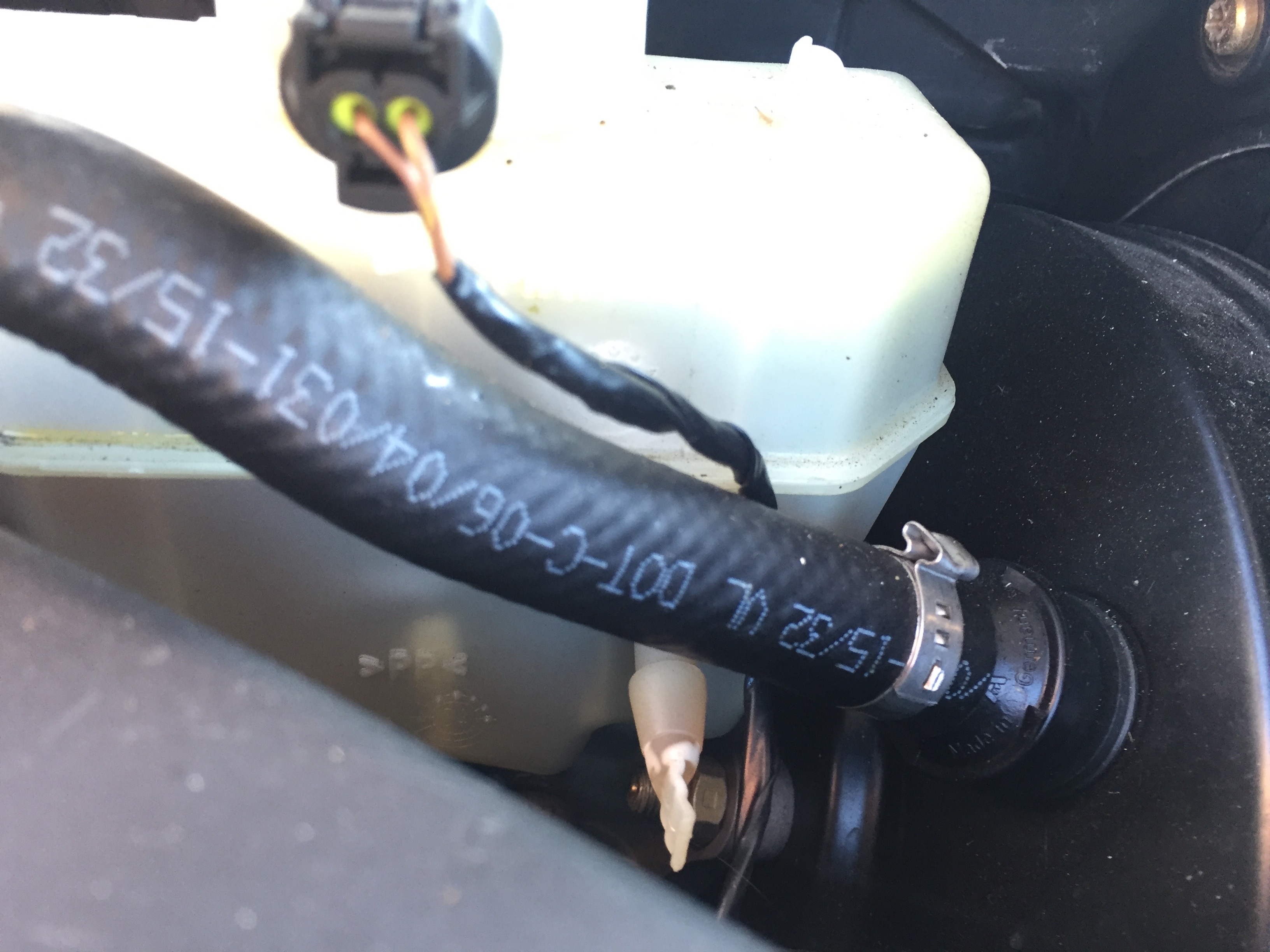

Is this little "nubbin" on the side of the brake fluid container normal? Why is it there, if so? It just reminds me of those plastic straws with honey in them...
Attachment 23446

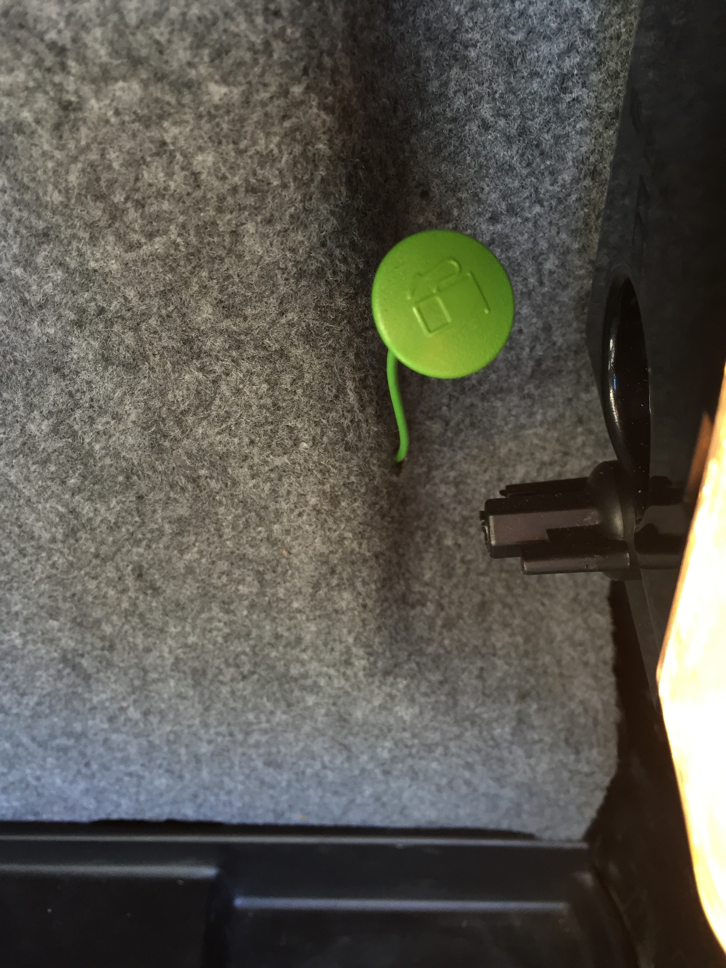

I assume it's related to gas but what's this little green thing in the right side of the trunk?
Attachment 23456

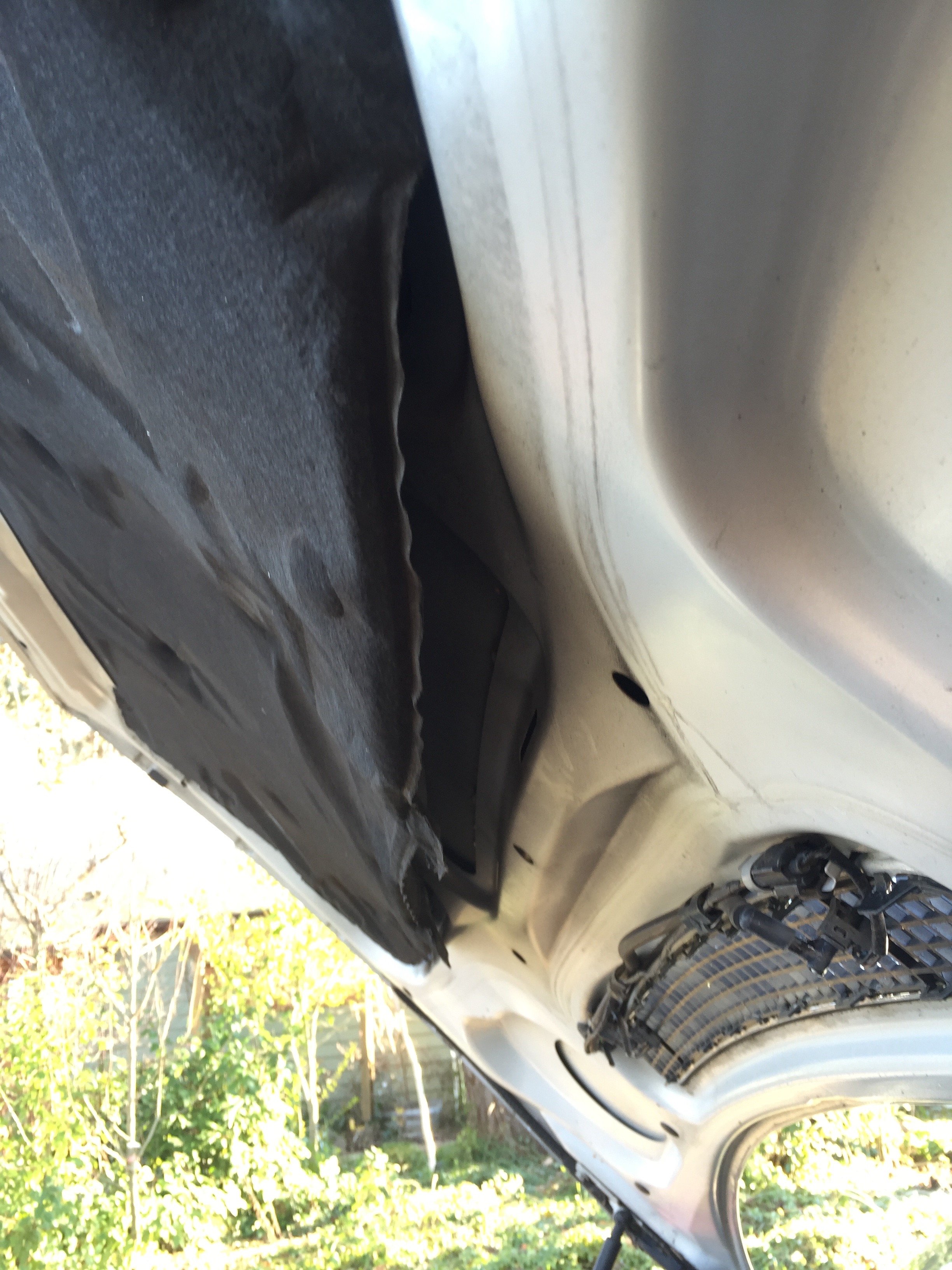

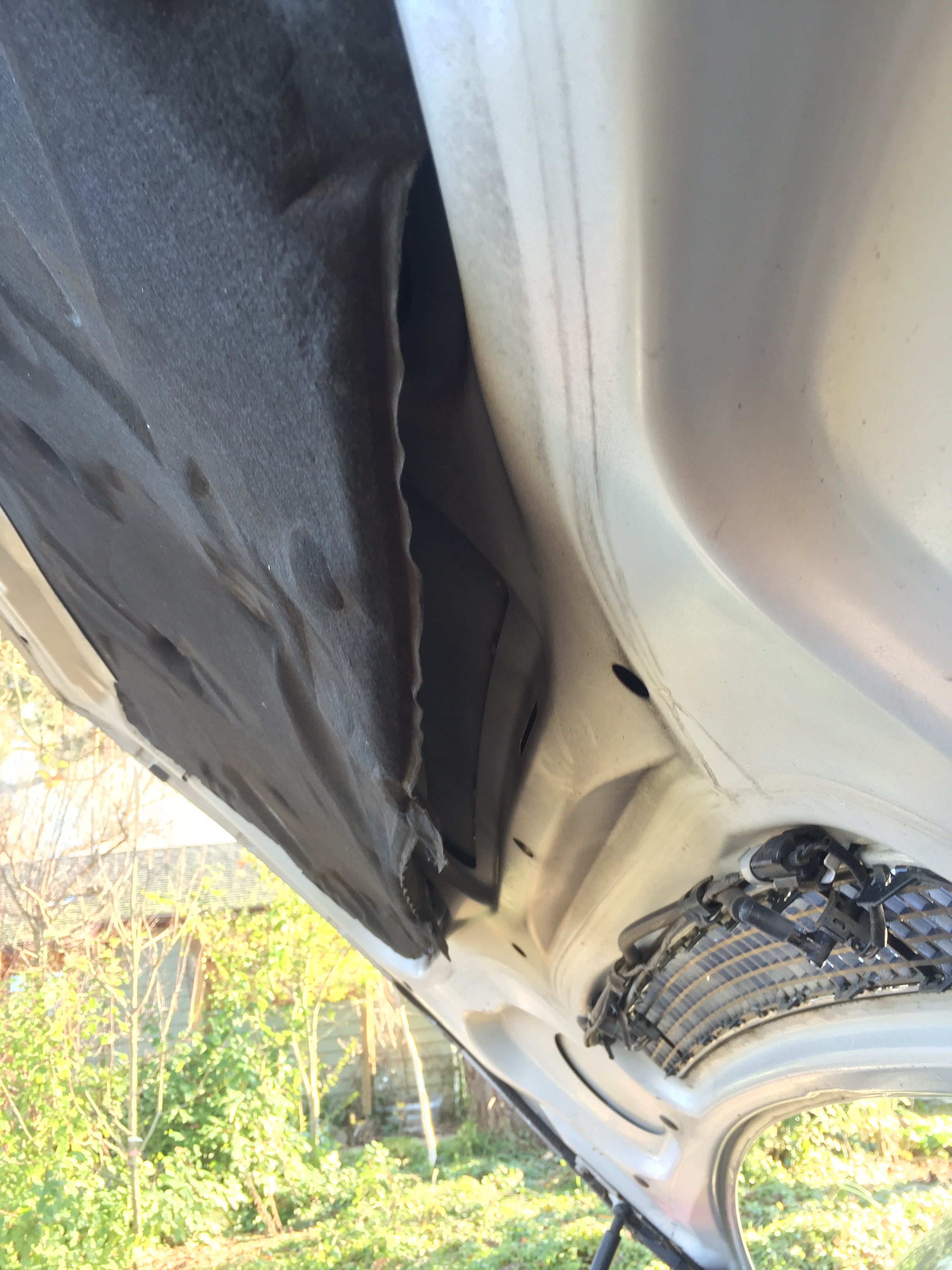

4)
Should the heat buffer under the hood sag this much, or can something be done (those tabs don't just stick back in where the should), or should I replace it?
Attachment 23454
Attachment 23453

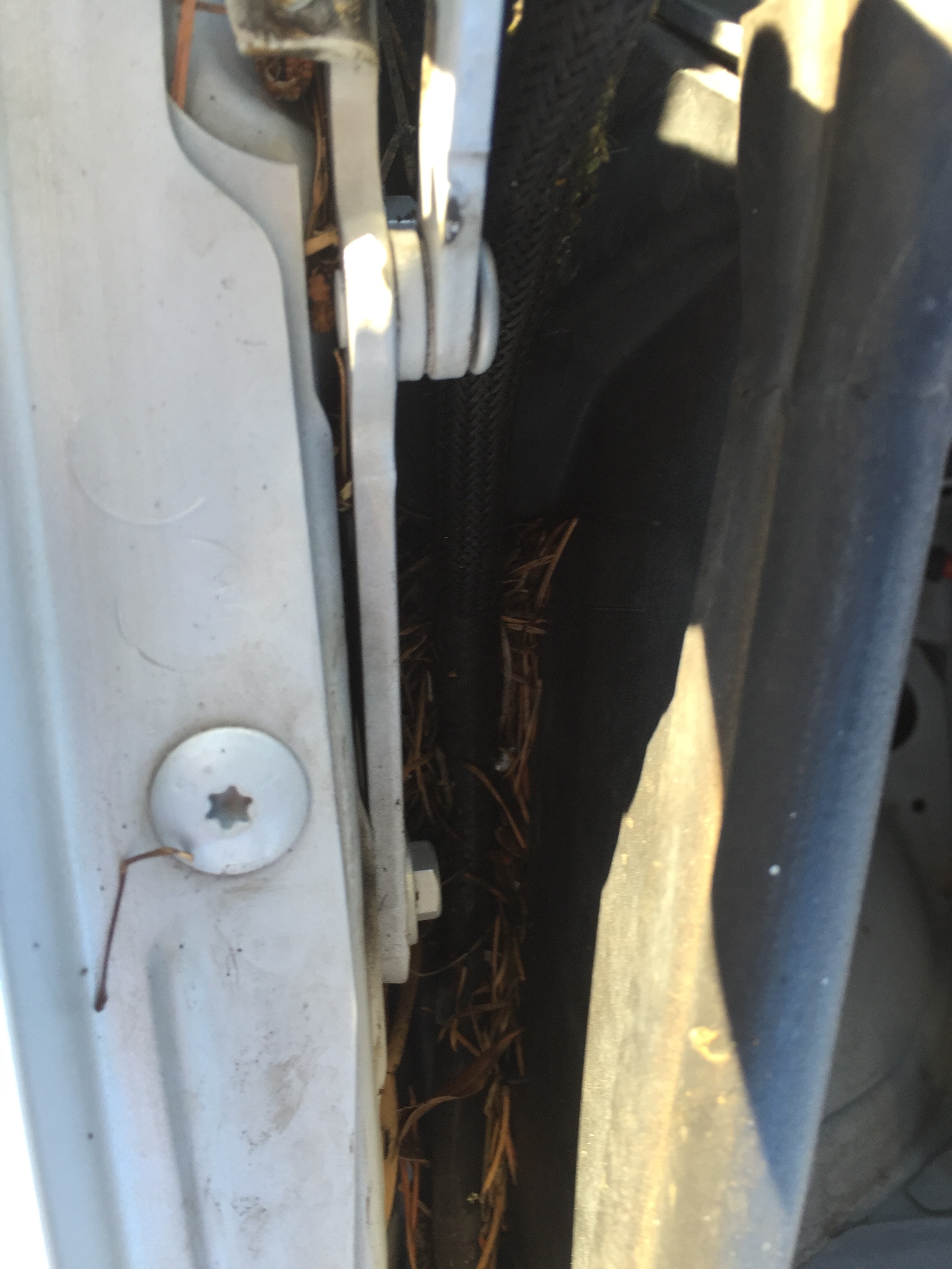

7)
Do you all just use a shop-vac or something to clean this area near the hood hinge? Both sides are filled with a nice inch or so of rotted leaves and dirt...
Attachment 23449

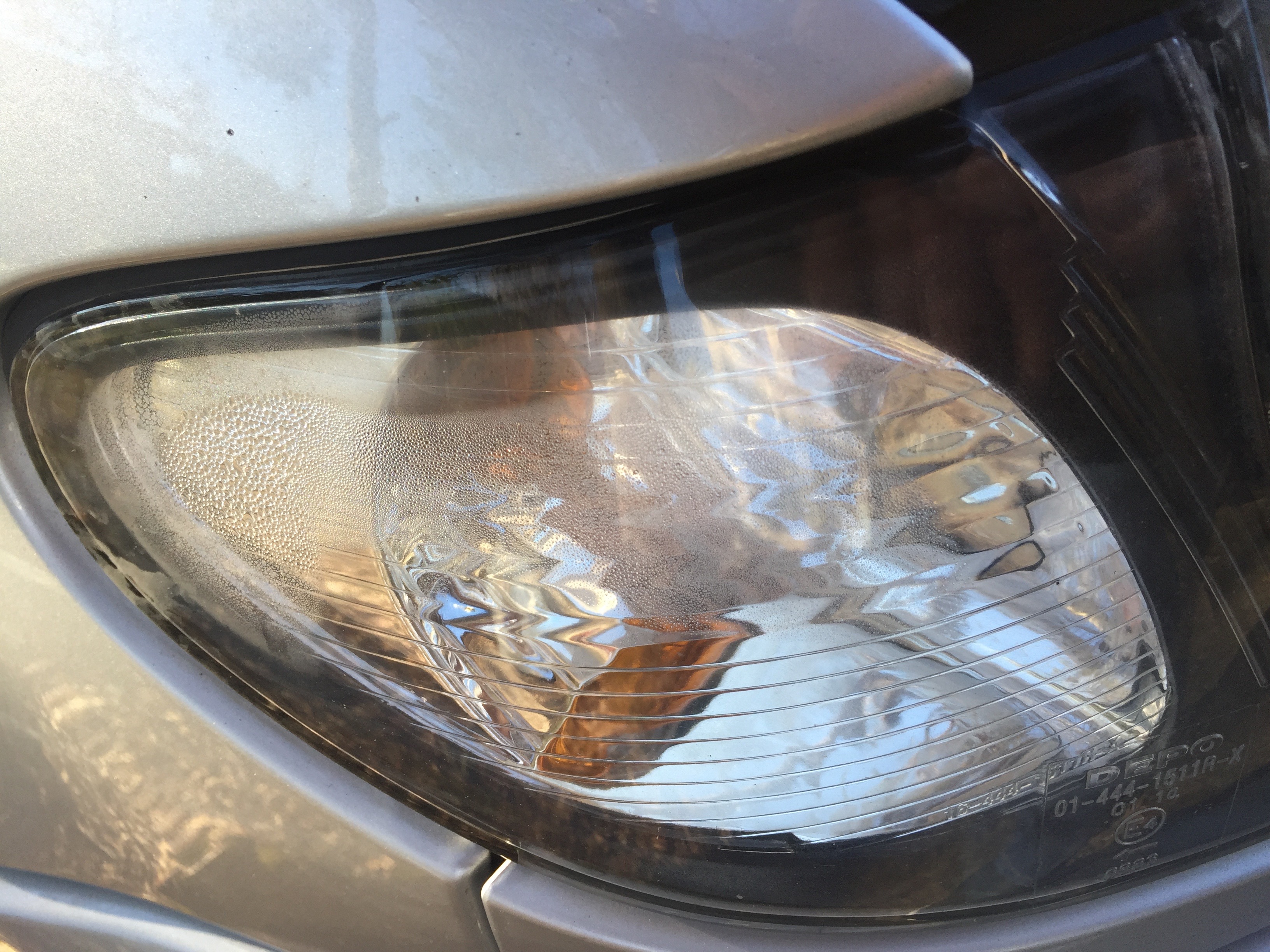

Turn signals are permanently foggy, since I got it. Thoughts on what to do? Can I pull them apart and dry them, or is it more complicated than that?
Attachment 23448

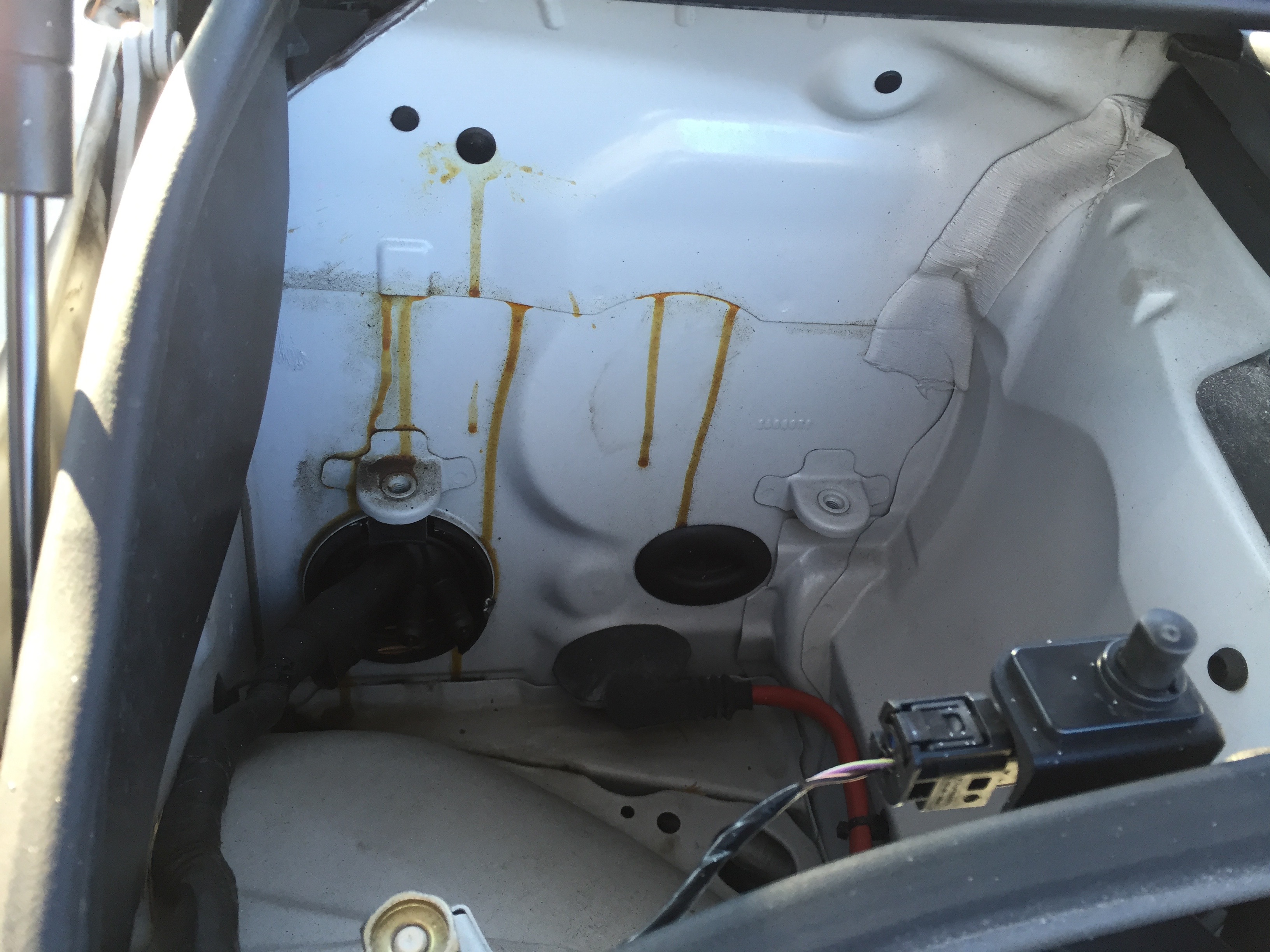

10)
What are these odd brown drips inside the empty box under the hood? Clean or leave them?
Attachment 23443

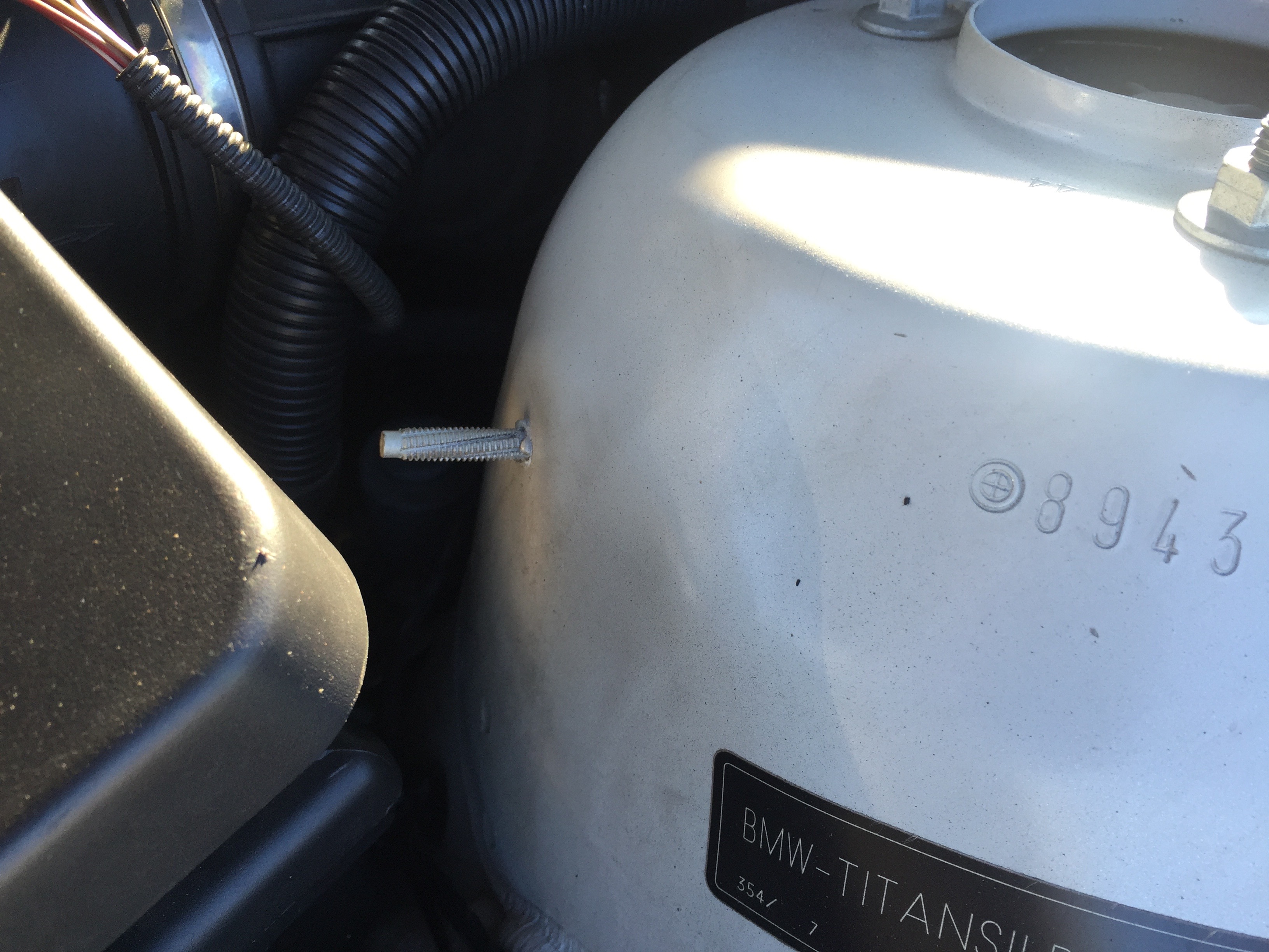

WTF is this odd screw thread protruding from the front left strut tower? I don't see the same on the right.
Attachment 23444

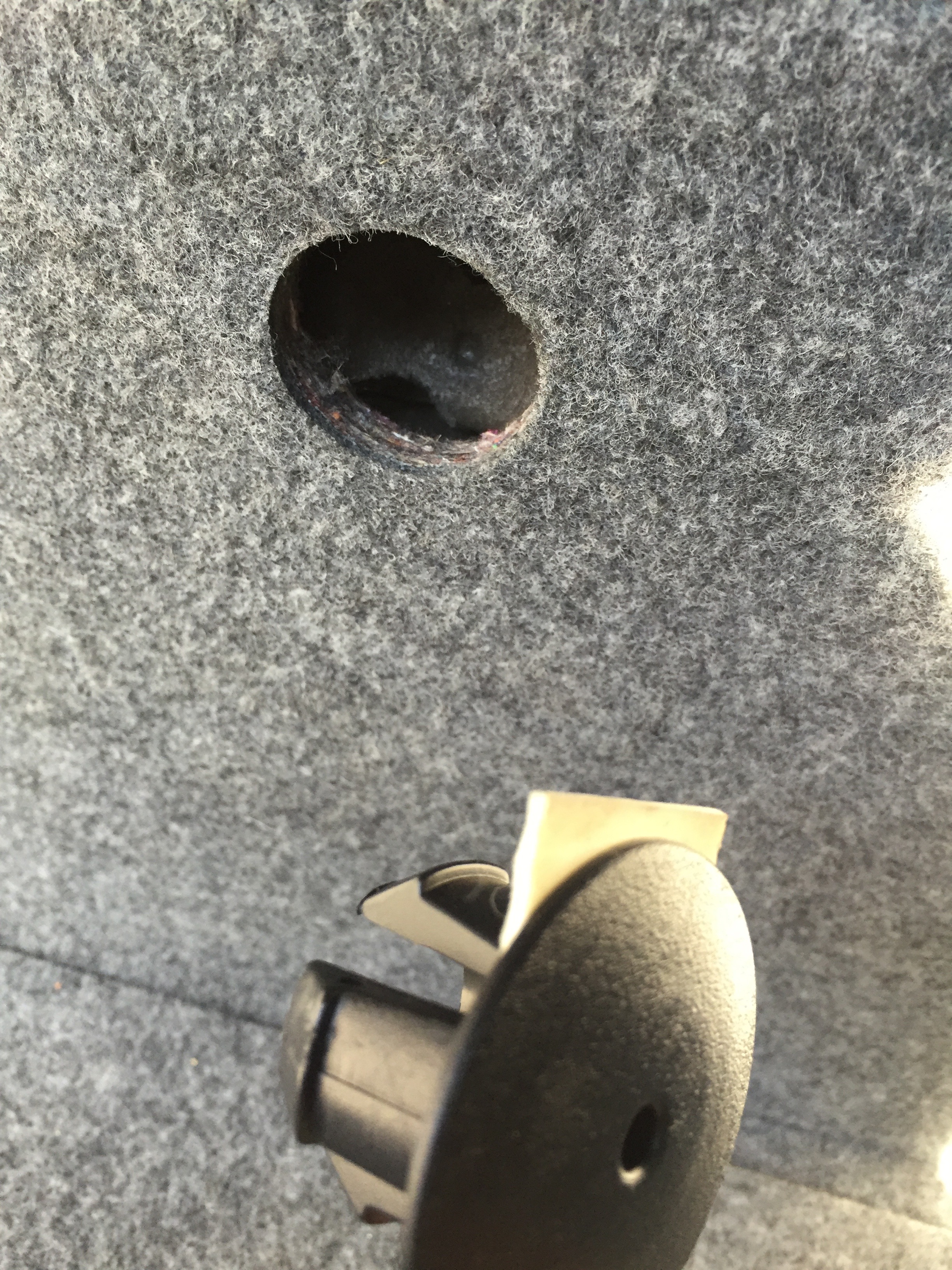

12)
Does this plastic cap fill this hole in the trunk wall, facing the back seats? It doesn't stay in there. Why is there a hole there in the first place?
Attachment 23457

1. Not sure.
2. It'll allow you to open the gas door from your trunk.

4. May have to replace anchor screws, or remove the liner entirely.

7. Yes. Brush and shop vac.
8. You'll need to buy new corners. Gaskets/seals are permanent to housing and cannot be replaced.

10. Leave them or remove. Most here have them. I think it's residue left over from South Dakota deadening material install?
11. It just a piece left over from manufacturing I believe. Someone else confirm.
12. Unsure.

1. If you had a manual it would feed the clutch slave cylinder.
11. It's there just to jack up your hand every time you mess with the airbox. Either that or some other country has something attached to it.
