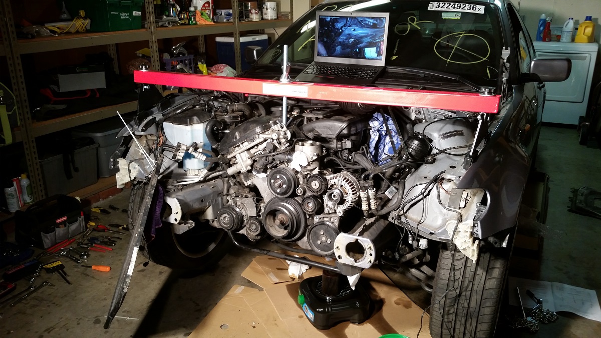

I just bought one of these this past week to do my oil pan gasket and it worked great. picked it up at a local Harbor Freight in Orange County for around ~$100 out the door after tax. Held my motor in place for 2 days while I dug into the oil pan gasket project. Was a lot of labor, but not necessarily hard, if you have the right tools.
