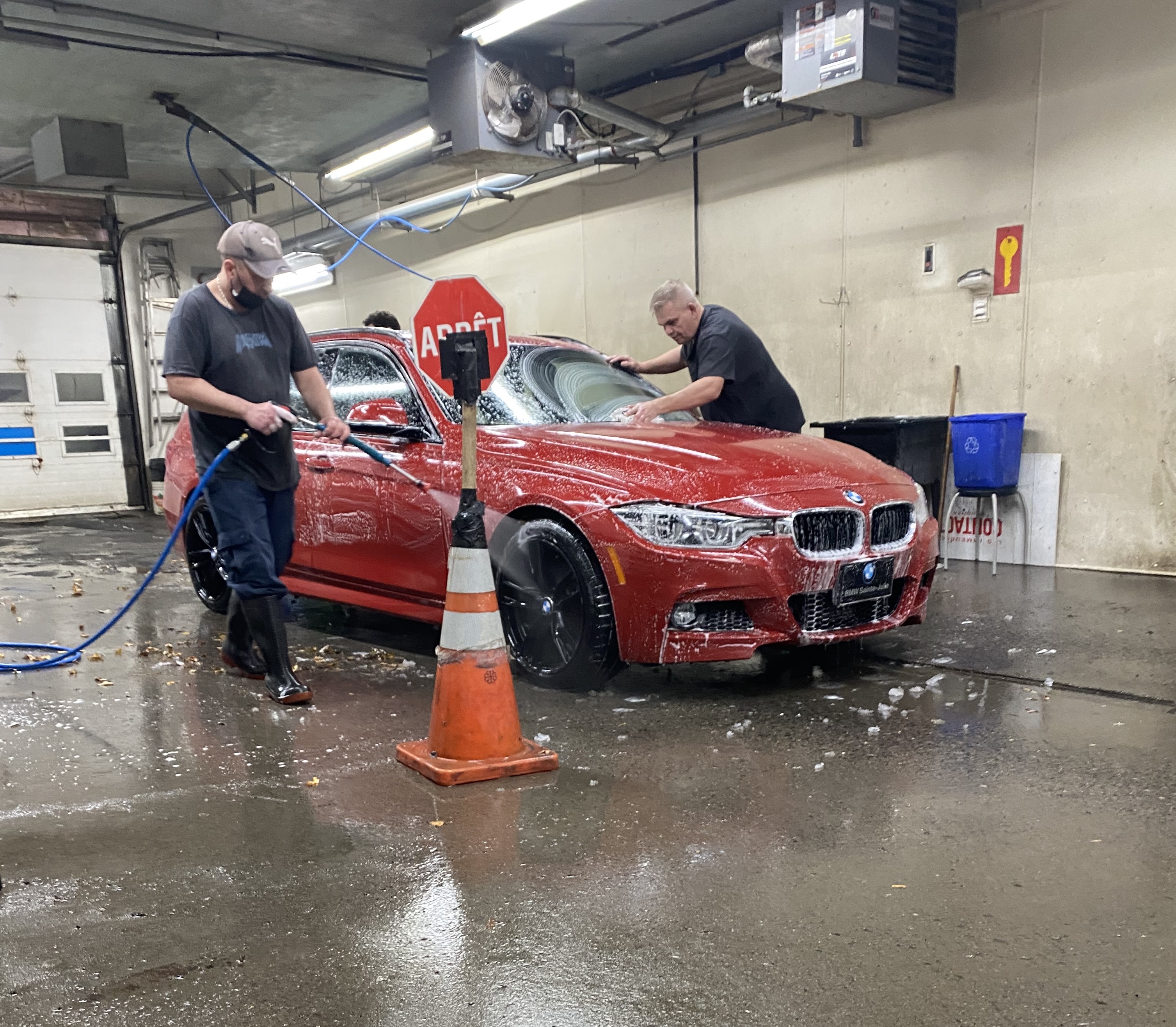

Mid-winter salt cleanup on the touring. Was well overdue.
Attachment 38807
Attachment 38807
