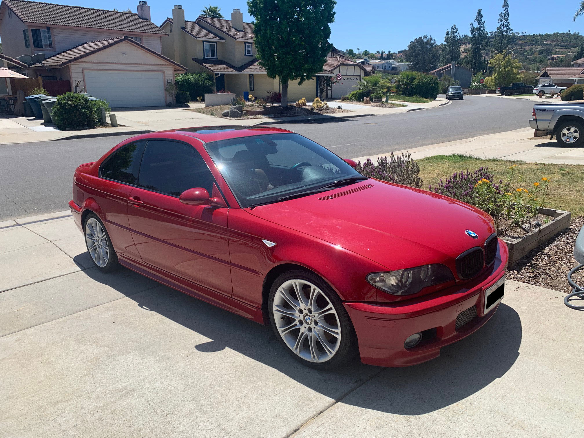

The side moldings (mouldings?) on my Imola Red 330Ci '05 ZHP had peeling clearcoat. Since BMW doesn't sell these parts painted anymore I was going to be way over $1,000 buying new parts and painting or sanding and painting in Socal - at least that was the case everywhere I tried to get an estimate.
Because the purpose of these things is to prevent door dings really I decided to try a wrap on them. The closest color I have found (so far) was 3M 2080/1080 "Gloss Red Metallic". It's a -slight- shade off from the original worn 2005 paint (imagine any paint might be to a degree as well) and has a bit more of a metallic sheen to it than Imola red does. But for this application, I'm pretty happy with the result and curious to see how it holds up.
This was the exact stuff I used https://www.amazon.com/gp/product/B0...0?ie=UTF8&th=1 ... Application was to sand and smooth out the old rails, clean with rubbing alcohol peel and stick and heat gun. Total cost $18.99 for 6 rails.
Thought I'd post in case anyone else had any interest in giving this a try. It's not -perfect- but am pretty sure it's a better result than I'd have gotten painting myself.

That's a good idea. And nice work!!

Nice job. But there is no way that shit costs $1000 just to get repainted. No way, I would have been able to afford having it repainted like twice + 1 more cause had to move to M3 side moldings.
edit:
got a quote from my bodyshop and he said it would be $300 to repaint. That's how much I figured it would be. Is that 1k for new parts + paint?

I think SoCal (San Diego) is just a total ripoff. But the old ones were blistered pretty bad so would have either had to sand them and paint or buy new parts and paint. Both prices were similar. If I could have found a shop to do all 6 for $300 I would have! I went to two places in person and was frustrated so did a Yelp message thing where you get lots of quotes at once and sent pictures and didn't get a single quote from about 10 shops that was less than $1,000. If someone has a specific recommendation in this region I'm all about it though! Hell I'd have driven to LA if I could have gotten a reasonable quote.
