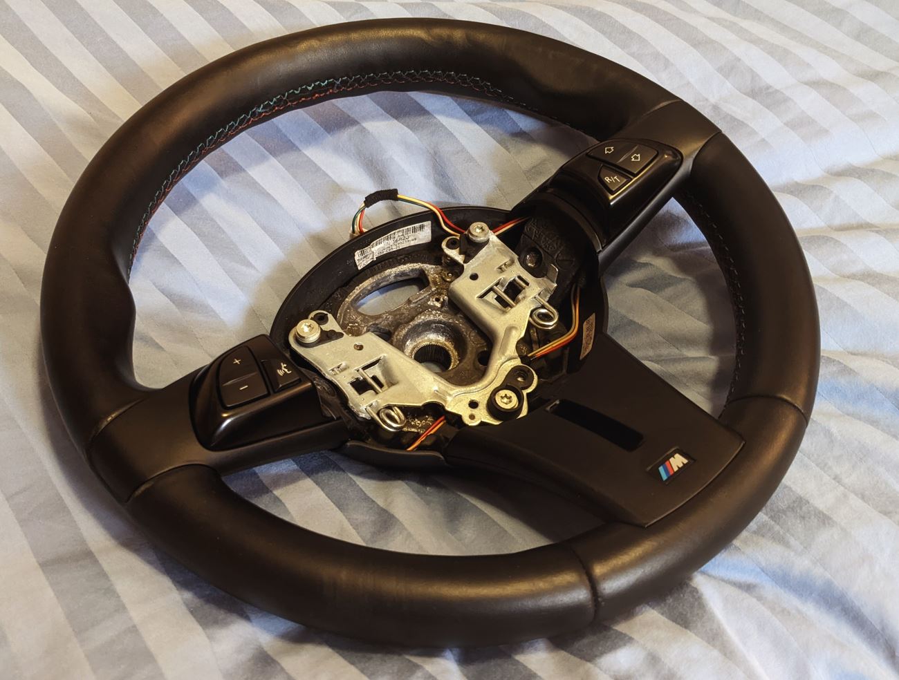

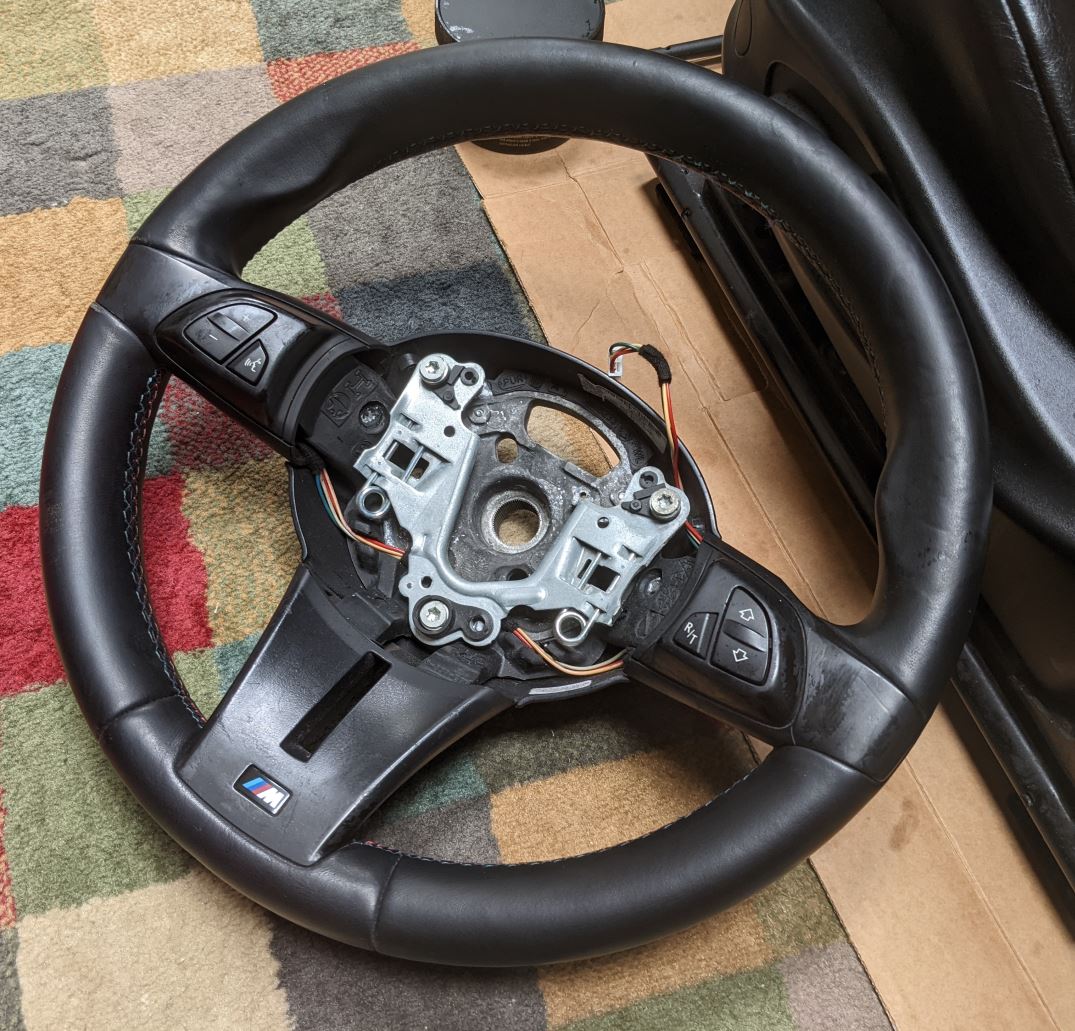

I refreshed a Z4M steering wheel I will be trying out with the ZHP.
(1) I cleaned and re-conditioned the Nappa leather (leatherique), used a heat gun to get rid of many of the creases/wrinkles in the 1-2 o'clock region.

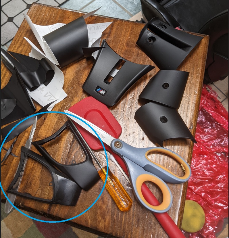

(2) Disassembled the steering wheel and wrapped the worn trim in Matte Black vinyl. Originally the entire trim is in a rubberized matte texture (aka plastidip) - which rubs off extremely easily. Just cleaning it will rub parts of it off.
Half-way through, I decided it would look better if the trim was matte black and button surrounds were gloss black, so I went that route. Couldn't be happier, good contrast - plus gives the wheel my own personal unique touch!
The trim pieces on these things are terribly cheap and their anchor points/clips are extremely fragile which I didn't expect. I ended up taking the thing apart, finding all of the broken pieces, and re-gluing them on. I would not want someone re-wrapping the wheel, they'll just break everything upon disassembly - it's that bad. Took 2 days total with the conditioning and things breaking (time for glue to cure).
This might just may replace my M sport steering wheel. It's a tad smaller in diameter:
BMW E46 M sport steering wheel: 14.5" outside diameter, 12.0" inner diameter
BMW E85 M sport steering wheel: 14.0" outside diameter, 11.5" inner diameter
Attachment 39197
Attachment 39199
Attachment 39198
