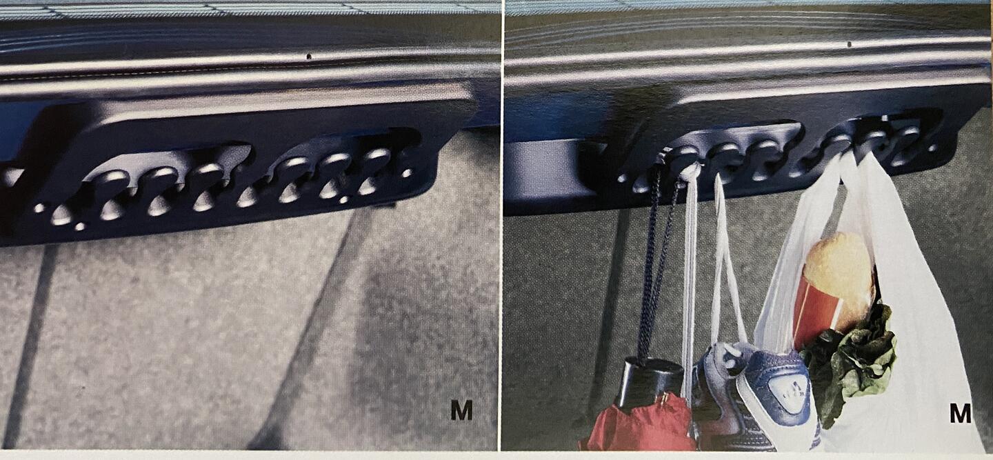

What do they screw into? Is there a spot on the body for these?

Yes, four holes in the older style (pictured below) - three holes for the newer version.
https://nam3forum.com/forums/filedat...?photoid=42658
The BMW part appears to be NLA, but the MINI part is the same thing.
BMW - https://www.turnermotorsport.com/p-1...uine-bmw-part/
MINI - https://www.turnermotorsport.com/p-2...uine-bmw-part/
