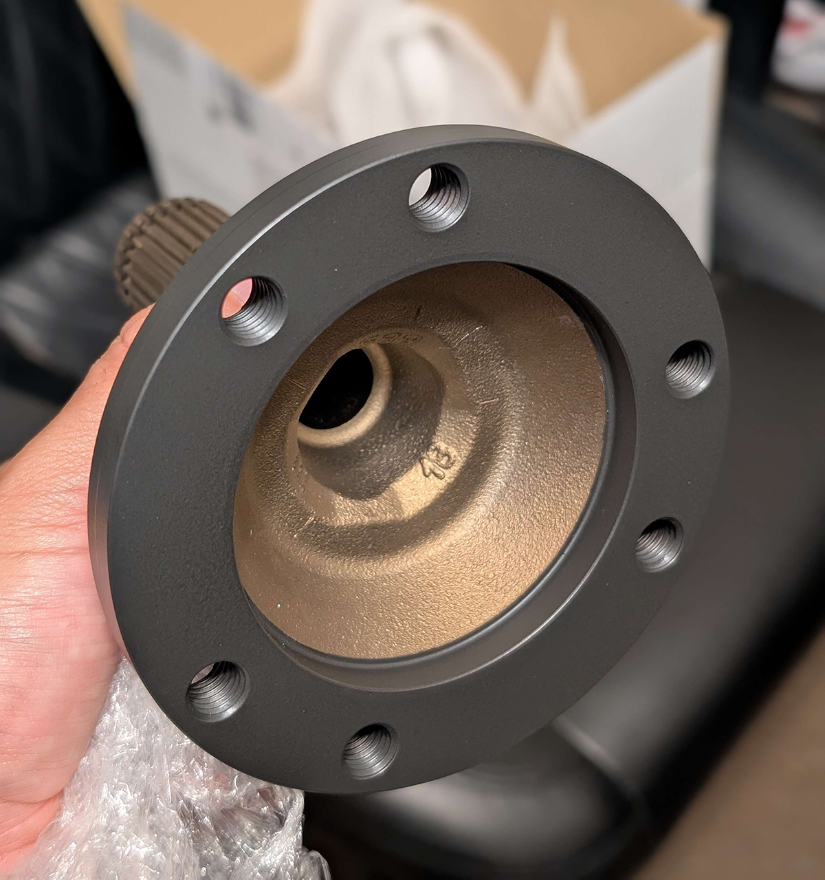

WPC treated output hubs back from the coater.
Attachment 40805
Attachment 40806
Beautiful pieces.

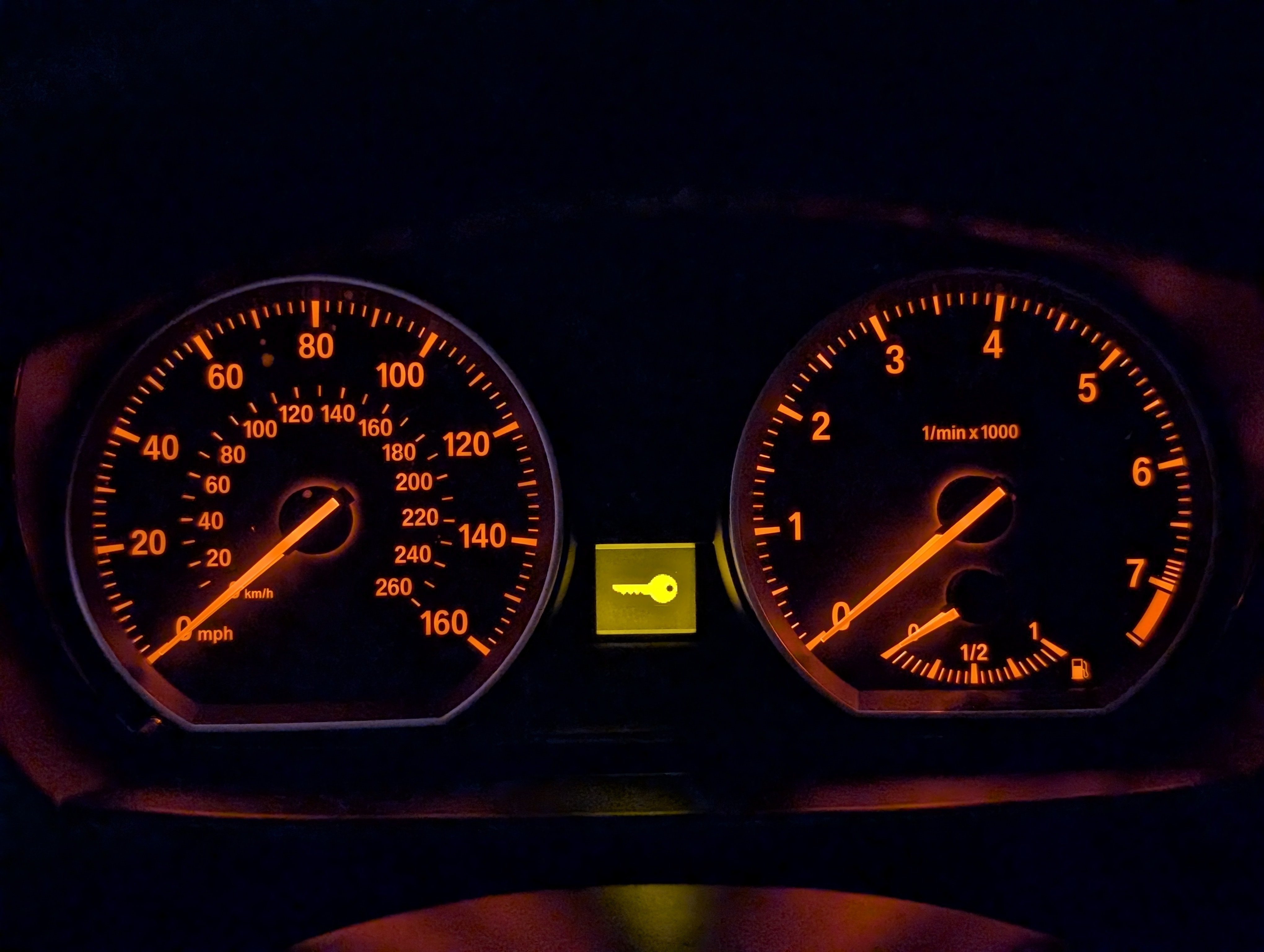

Received the new cluster from Dimitri for the 128.
Attachment 40807
what does the old one look like?
Here's the factory cluster.
Attachment 40808
