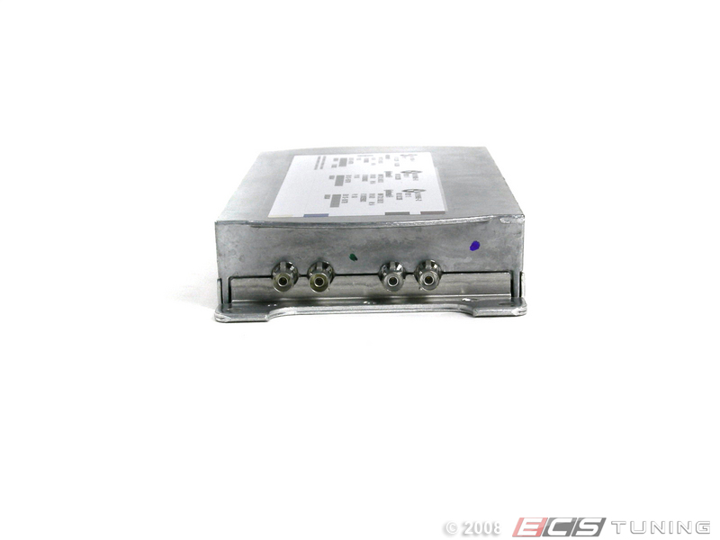

This is what mine looks like I believe.
This end is facing the rear of the car.

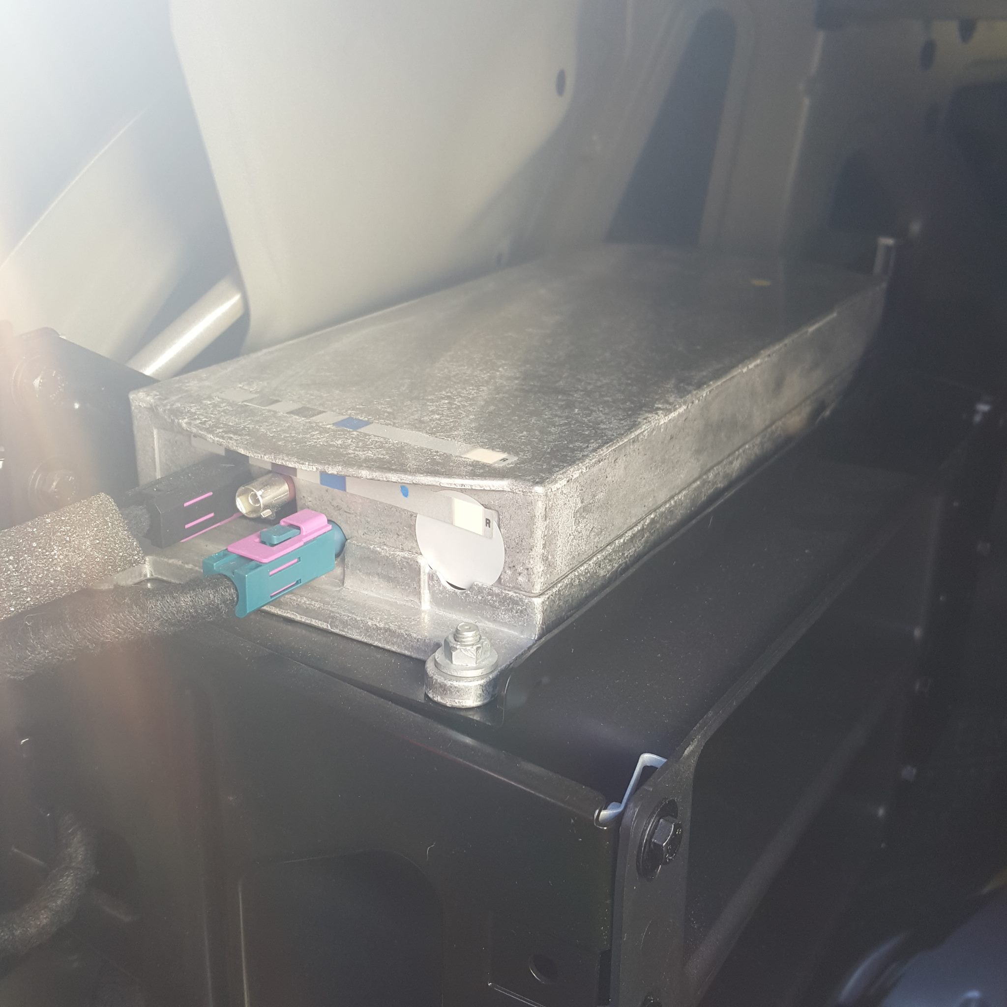

I think you have bluetooth as well. Look in your owners manual for a card like this:
Attachment 24699
It should also have a manual like this:
Attachment 24700
The bluetooth receiver is on the driver side of the boot, behind the lining. Should look like this:
Attachment 24701
The next question is how to reset it. Every time I try to go through the pairing procedure it starts dialing using the original owners phone number, which is out of service. It takes me to a Verizon error message that repeats but it doesn't let me rest it or pair.

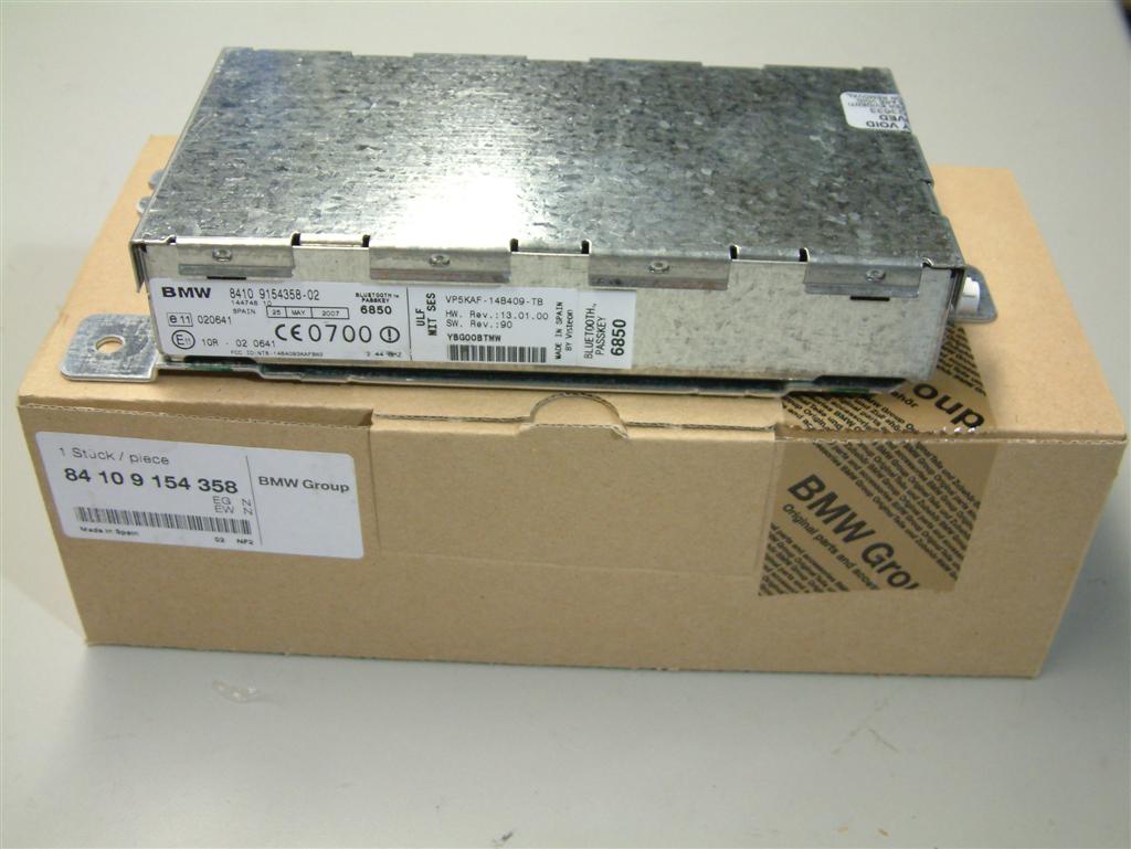

Negative, that is the bluetooth module. theres two different types. This one is the TCU and is the standard bluetooth module for vehicles with BMW assist.
The ULF is the standard module for vehicles with nav:
Attachment 24702

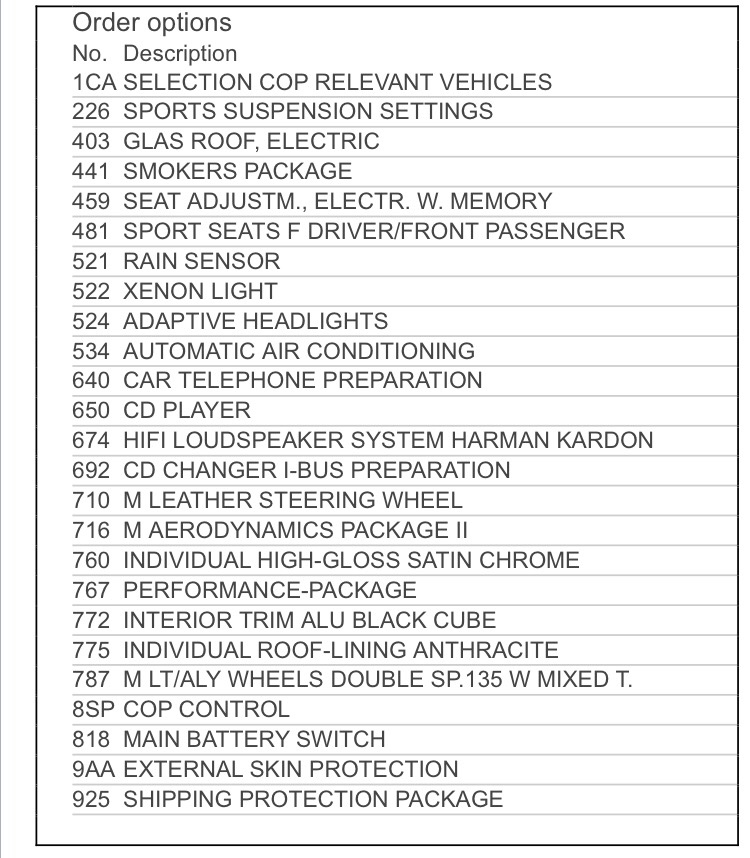

I don't think I have BMW assist based in the vin decoder but I do have the same module as you in the same location... Now I'm confused... Here's a pic of my option list-
Attachment 24703
Im guessing that the PO installed it...
