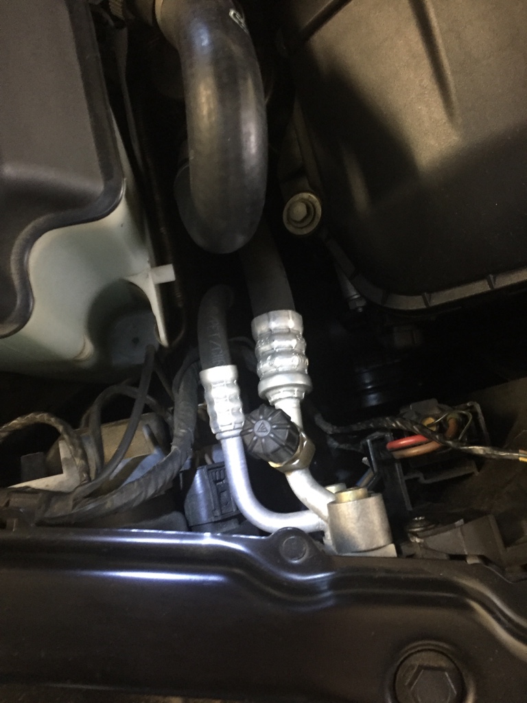

What are these hoses for? Looks like it connects to the radiator and goes behind the engine on the exhaust side.
Attachment 25182
AC? Not sure. Normally metal fittings means AC I thought
Definitely AC. Note the star-shaped black cover on one side.
I will be proven wrong...
yep! AC
