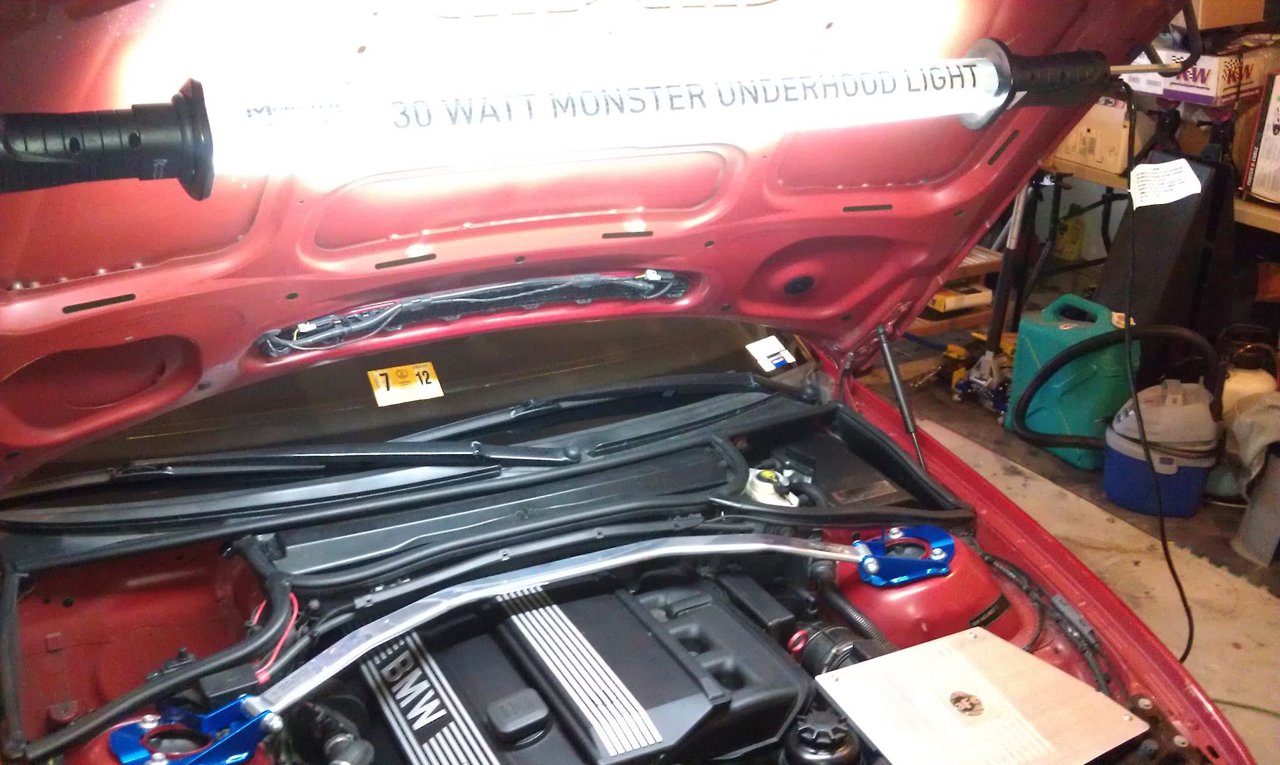

PC'd and waxed back 1/3 of car. Organized garage. Tested out Monster Light (the one I got from SnapOn dealer) for first time.
