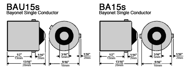

I did some more research and found the contact points for each type of these bulbs:
The 7507 (BAU15s) has 150 degree contact points. The 1156/7506 (BA15s) are the same and have 180 degree contact points.

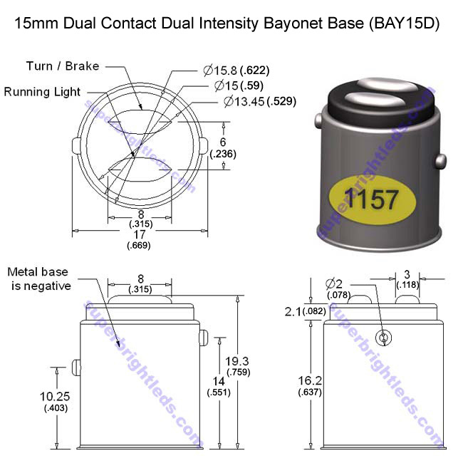

1157 is dual filament and has 180 degree contact points but they are not at the same vertical height.
Attachment 18096
So 1156/7506 (BA15s) are interchangeable.
7507 is the only one with contact points at 150 degrees and is NOT interchangeable with the dual filament 1157 bulbs.
It seems most e46 came with 1156/7506 sockets for the corner lights and a few with the 7507 like mine. So I think I will end up just shaving off a contact point from the 1156 bulbs so they will fit. I was confused what the differences were so just in case anyone else was confused I wanted to post this.
