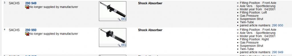

Interesting, looks like Sachs has discontinued those as well.
Attachment 37142
According to Sachs, the replacement for your new shocks is 317-539 and 317-540. I wonder what the difference is between those and the 317-541 and 317-542.
What's interesting is that 317-539 and 317-540 replace the 290-949 and 290-950 (Sachs Super Touring).
Attachment 37143
But the 317-541 and 317-542 replace 556-873 and 556-874 (Sachs Advantage).
Attachment 37144
That would suggest that they are different, but they do share the first three digits in their part numbers. This might suggest a certain similarity but I would have to ask Sachs to clarify for a clear answer.

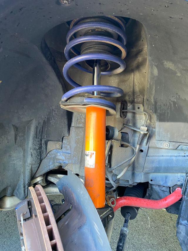

I finally got a chance to install everything this weekend. The process was pretty straightforward since this is like the 3rd time I've done the full suspension on this car (don't even ask). The only issue I had is that it was impossible to stack front the spring pads like I hoped. The spring seat always ended up crooked, so I just went back to the normal setup. Many thanks @ZHPizza who let me borrow his non-deadly spring compressor. Made the install so quick and easy.
I also used this opportunity to check for subrame mount cracks. My car is a Feb. 2004 unit, so no structural foam. The wheel well seams are all fine and the area around the subframe bushings is good too. I did have a medium sized crack at the left rear inner fold though, so it's definitely time for a reinforcement sooner than later.
Attachment 37204
As you can see my old setup was looking very sad. It has 35k miles and a lot of abuse behind it. Several Tail of the Dragon trips and other twisties, at least a dozen autocross events and a road trip through the deep south (some of those New Orleans potholes are endless pits), just to name a few.

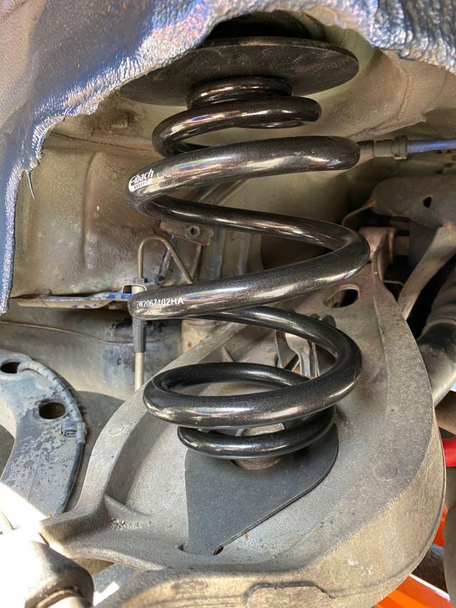

The E36 M3 rears are thicker but surprisingly also slightly taller than the Konis. My old rubber RSMs were in good shape. I think they are Lemförder so those get a thumbs up from me. The Bimmerworld RSMs are definitely a nice step up though.
Attachment 37197
I also installed the rear reinforcement for the lower spring perch. Makes the rear a little taller than I'd like but those rear Eibach springs are crazy stiff compared to the H&Rs. Speaking of, holding both springs side-by-side for comparison really cemented my disdain for H&R. The Eibachs are basically half the weight. They are so light, the car must have lost at least 10lbs! It's hard to explain, but compressing the H&Rs feels "jittery." They just feel cheap in every aspect. The Eibachs on the other hand feel so nice and premium. I will definitely steer clear of all H&R products from now on. The Eibach spring rates are also interesting. The fronts are extremely soft, softer than the H&R fronts. The rears, like I mentioned, are extremely stiff, much stiffer than the H&R rears. I haven't pushed the car much yet but in theory this setup should drastically improve driving dynamics as the Eibach setup would favor oversteer, unlike the H&Rs which favor understeer.
Attachment 37198
