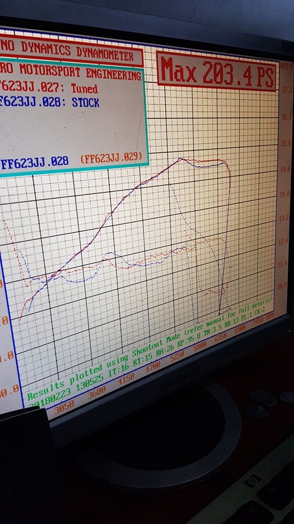

Badd news the spacers for o2 dont cure the SES. Light it came twice this week.

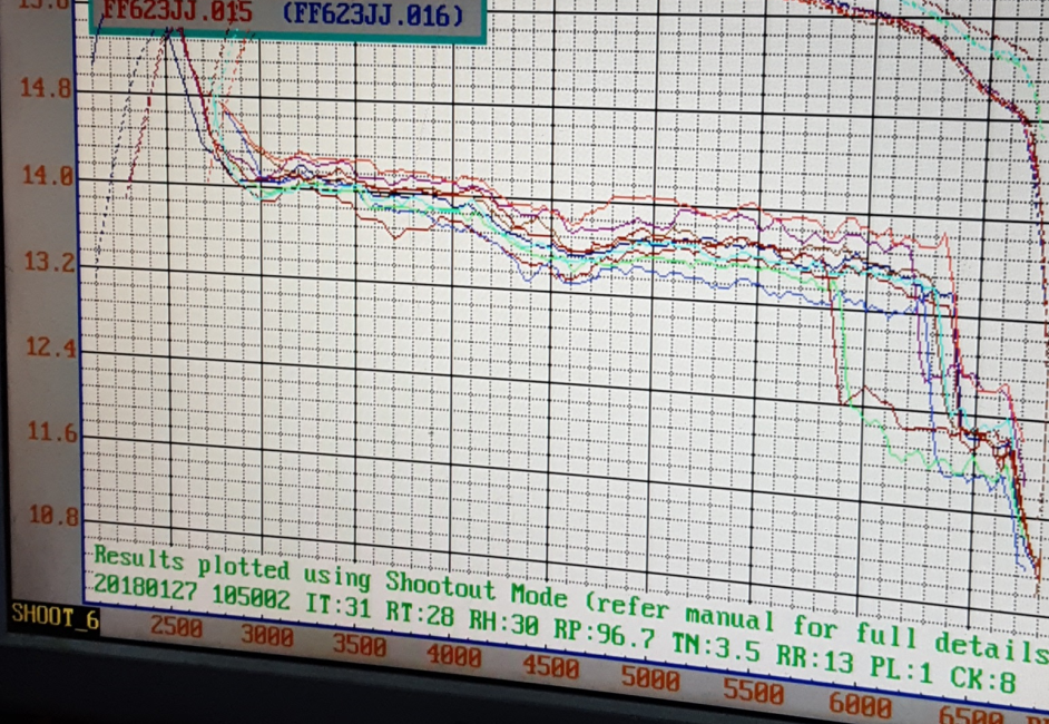

Long time no post. I have removed the headers because it messed up with my AFR, providing that I ordered from ebay, the post cat banks didn’t clear so I relocated them to another spot, and I also had to seal the pre cat bank one because it hit the other header and I was unable to mount the cat sensor, so I had to drill another hole to fit it. Unfortunately drilling another hole that was not the same height and was positioned not similarly to the other pre cat sensor messed with my AFR and the car couldn’t rev post 6000 rpm in 5th gear, there was just not enough power.
Note that pre cat sensors are in charge/reponsible for fuel/air mixture

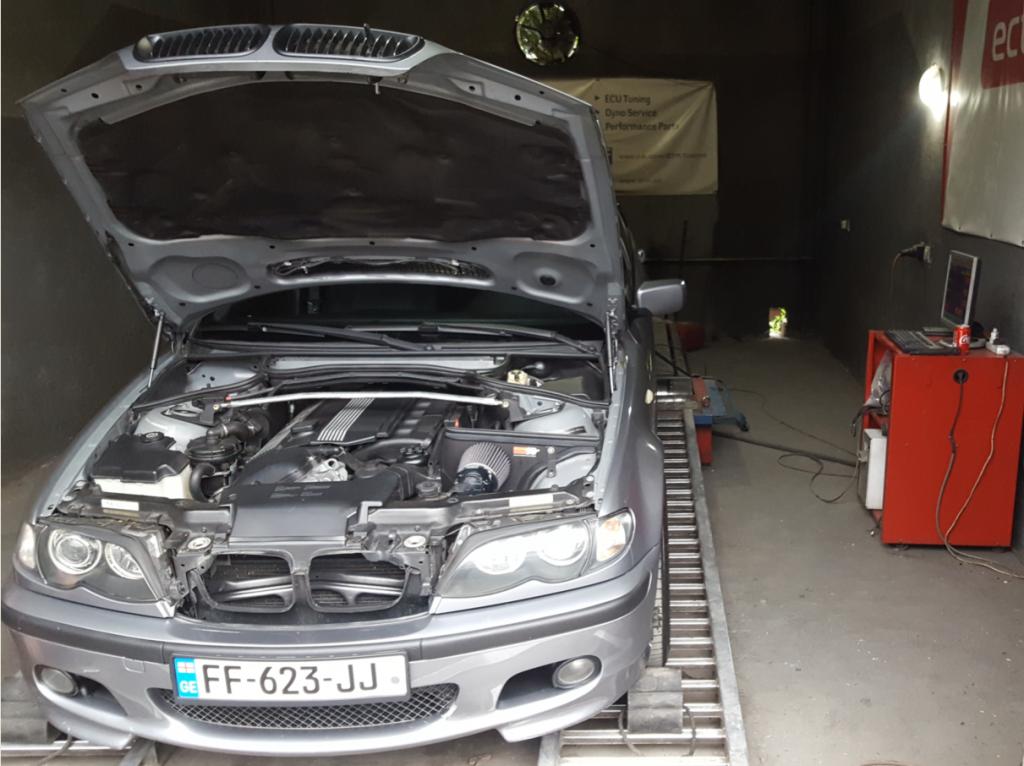

I also went and dynoed the resulted with K&N intake. I wanted to compare before and after K&N gains, which by the way were impressive. Before I installed the K&N my car showed 235 HP at the crank. With K&N the car showed 248 HP ! A big gain of 13HP at the crank, So the K&N air filters really work. The torque was 297 lb/ft and now is 328 lb/ft this is a massive gain for torque, but i think decated manifold with K&N really brought up the power + ZHP cams
At the moment my car specs are:
1. Decatted exhaust manifold
2. K&N filter + Custom Intake

As you can see from the dyno AFR results from 2300rpm – 4000rpm the AFR stays between 14 ratio which is lean. From 4000rpm – 64000rpm stays at 13.5 which is normal. Because the filter induces more air the DME needs tuning to keep the 13.5 ration constant. After I install the headers I will get it tuned.
As for the problem at 1500 rpm i think it is due to the AFR needing tuning, if i unmount the MAF cable it solves itself, when unmounting the dme provides rich mixture that is why it stops the problem. As i said earlier i will tune the dme after i install the headers.
