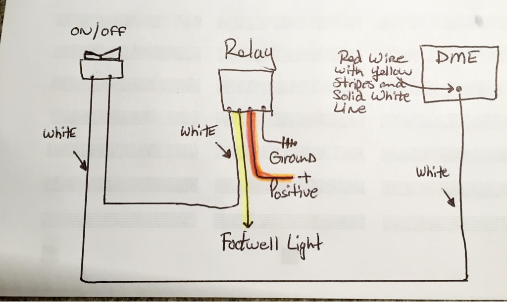

Here Ya go Sean. Sorry it took so long to make this. Wiring diagram for angel eye on/off switch.

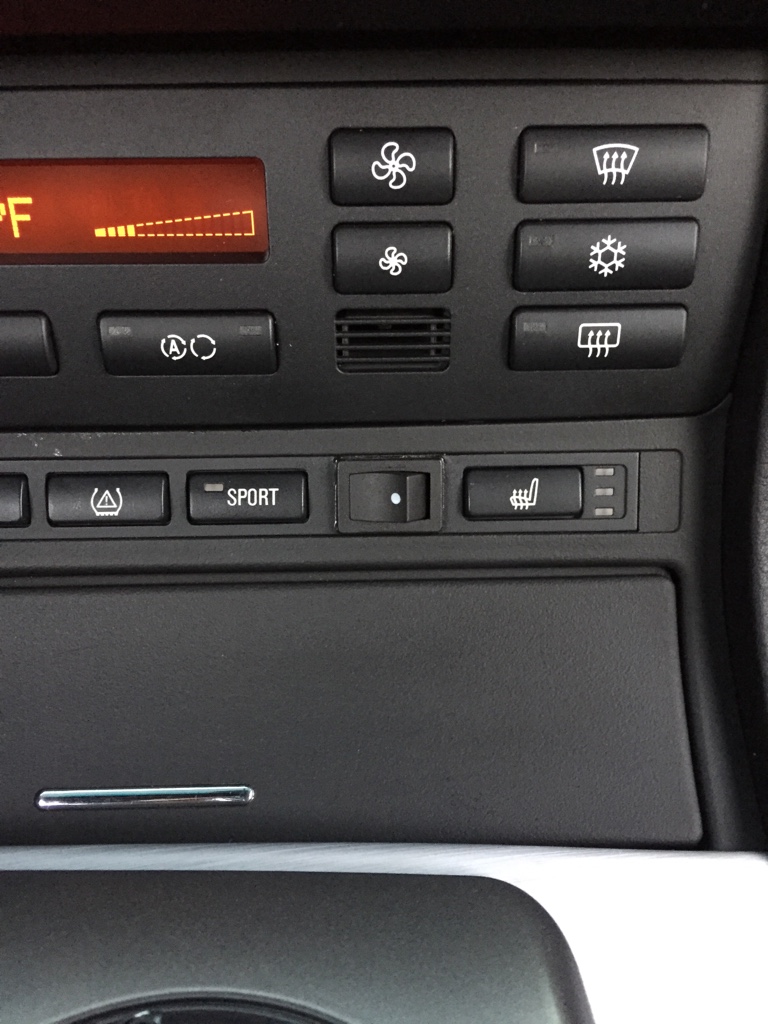

Ok got the "UltraGauge EM Plus" installed with some R25 film to match the dash lights. I decided to put it where I had it in my ZHP. Easy to see and you can access the buttons on the back for scrolling thru pages of data and menu options.
Looks awesome Gary!!!
Thanks Charlie. :thumbup
Pretty cool. I've always been intrigued by the p3gauge but can't justify $300ish for the coolant temp and some other data that I probably wouldn't use very often. This seems like a pretty decent solution. Thanks for the wiring diagram as well :thumbsup
