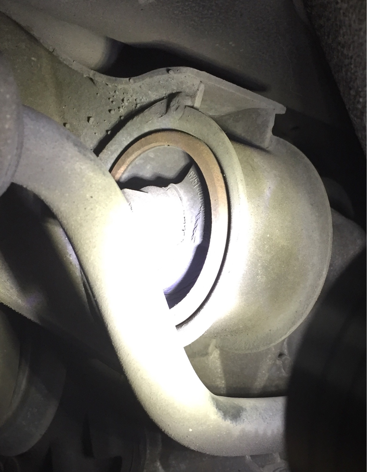

It's hard to tell as I can't zoom in on the pic but the outer right side looks to thin to be a washer and an aluminum washer against an aluminum surface doesn't make a lot of sense
Interesting. Not sure what the purpose is but I'm sure they have a good reason
Yes, a copper washer goes there. I bought an Elring one from FCP when I ordered the rest of my cooling system, Elring P/N 242.608.
Looks to be the same shape and thickness of what you have "stuck" there...

What if you tried something like dental floss to try to pry up under it?
Well I got it off and it's definitely an aluminum washer. Dealer washer is also aluminum. Either material probably is fine.

How's my diff bushing look?
Slight crack on the right, maybe?
Attachment 26466
