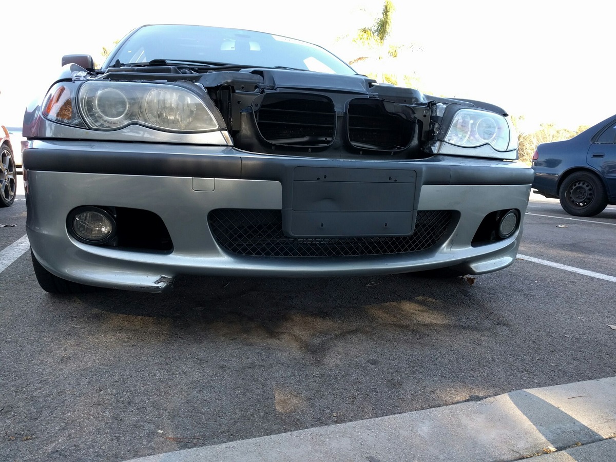

Attachment 27642Attachment 27643
Just kidding, welcome to the Forum. There are a few different ways to adjust how the hood sits. There are also a few spots, that even in a low speed collision, could have been damaged and would prevent the hood from sitting just right. I will go snap some photos for you and can give you further details if you PM me. I was just in an accident with my ZHP and I am just about done rebuilding it.
On the core support, known as the front panel, there should be these black rubber nubs sticking up. You can twist them to raise of lower them. This would be the first check. Let me know if that isn't it and I will take some photos of areas for you to inspect for damaged. Check my build thread too if you want some photos of the front end.
EDIT: About the air bag, I hit a car going somewhere between 20 and 30 mph (There car was still moving some) and my airbags didn't deploy. Thank god as one of them is quiet literally a frag grenade.
Honestly it doesn't look that bad from the pictures and I'm as OCD as they come.
PM sent! Thanks again!
My OCD for cars has gone right out the window at the moment. Bumper is beat to hell on my car and one of my fenders is a lttle out. O and no hood, sooo.. I will get it much better eventually, which may mean a new bumper too.
