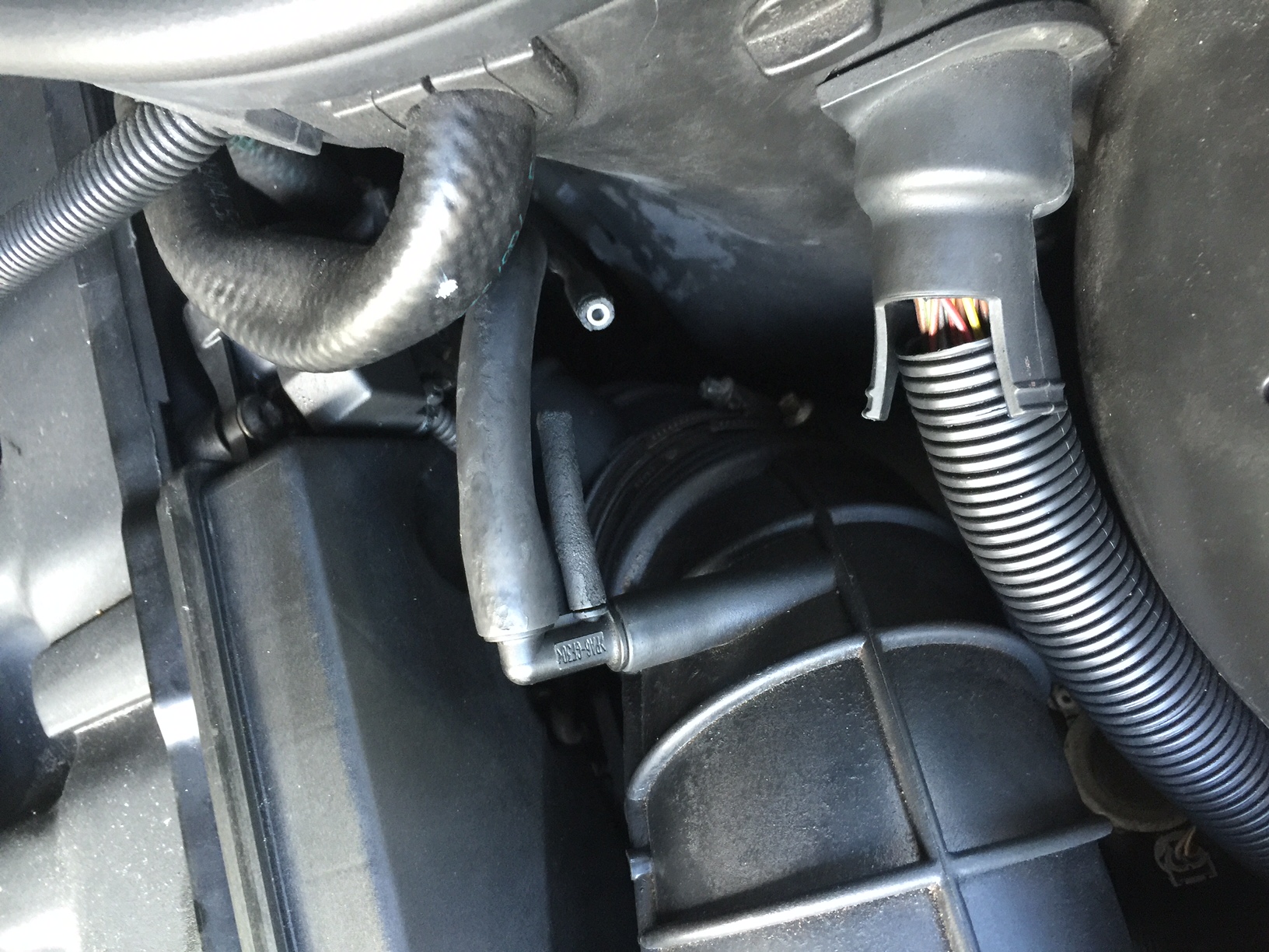

Just swapped the coils and had the codes read again, still a cylinder 1 misfire. What should I check next? Is it possible that a broken F connector line from the intake boot could cause this (although I would have expected a lean code from that not a misfire). It just broke when I replaced my DISA a couple of days ago and before that the car was running fine...
Attachment 23528
