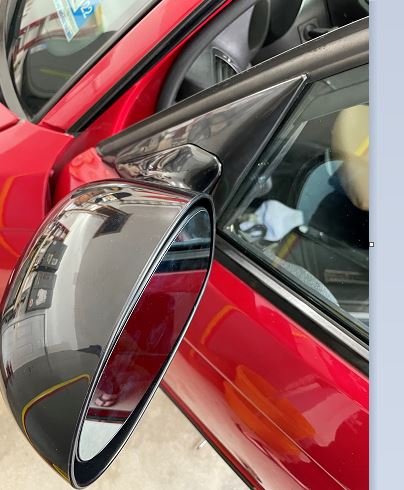

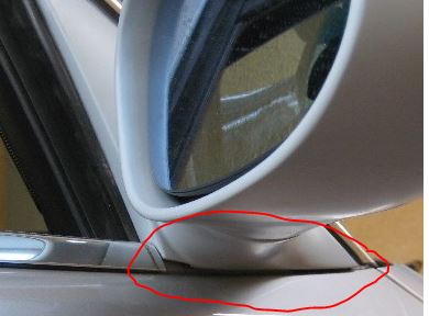

I've done the shaving/drilling and whatnot, but it still seems like you still have the gap at the base of the triangle, because the M3 housings have a different triangle shape than the door mounting triangle as well as that aluminum strip that shows. I believe I've read people just put like silicon to seal the base of the triangle and trim the aluminum strip so it doesn't show past the hypotenuse of the m3 mirror base. Do you have a closer picture of what it looks like mounted to your sedan, specifically the base?
I have done this mod to my last ZHP following the Rogue Engineering DIY exactly and found no issues mounting my OEM M3 side mirrors to my doors. There were no gaps that you are talking about. I have pictures in my Imola ZHP project thread.
Click on the Imola ZHP project thread link at the bottom where my signature is and go to page 31...
If pictures don’t come out I will have to dig for them when I get home from work…
