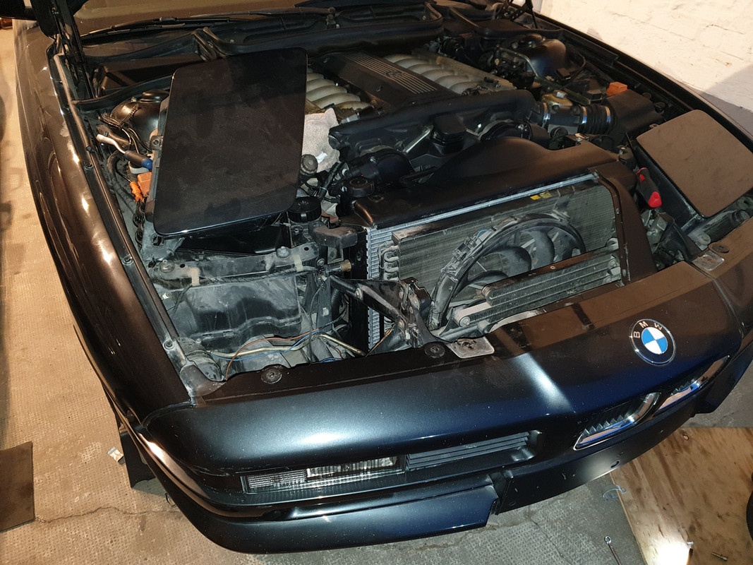

Final update on the E31!
I went the extra mile and fixed the last piece of the puzzle on this car: the A/C.

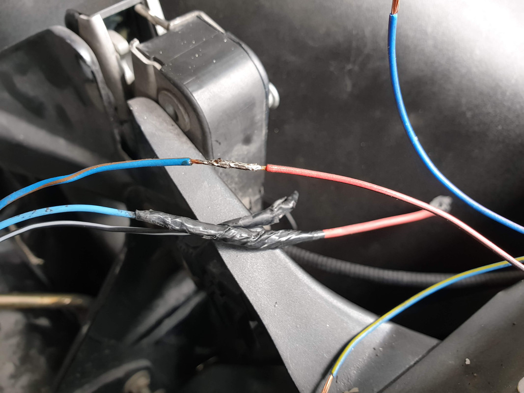

If you followed along then you might remember the wiring fiasco that I had with this car. Well, the lunatic with a knife did stop there and the madness continues with the A/C compressor.

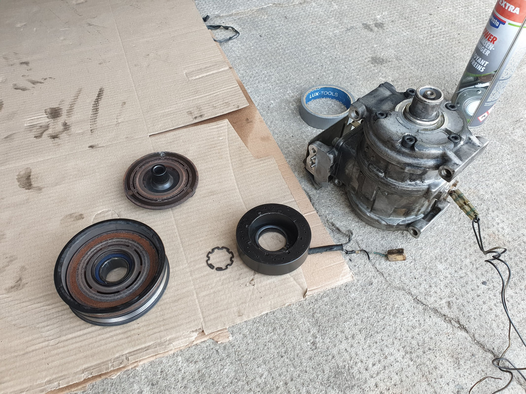

I always knew something fishy happened with the A/C compressor but in the spirit of not losing my mind, I decided to ignore it for the time being. However, I also knew that the day for further investigating will come and here's the outcome.

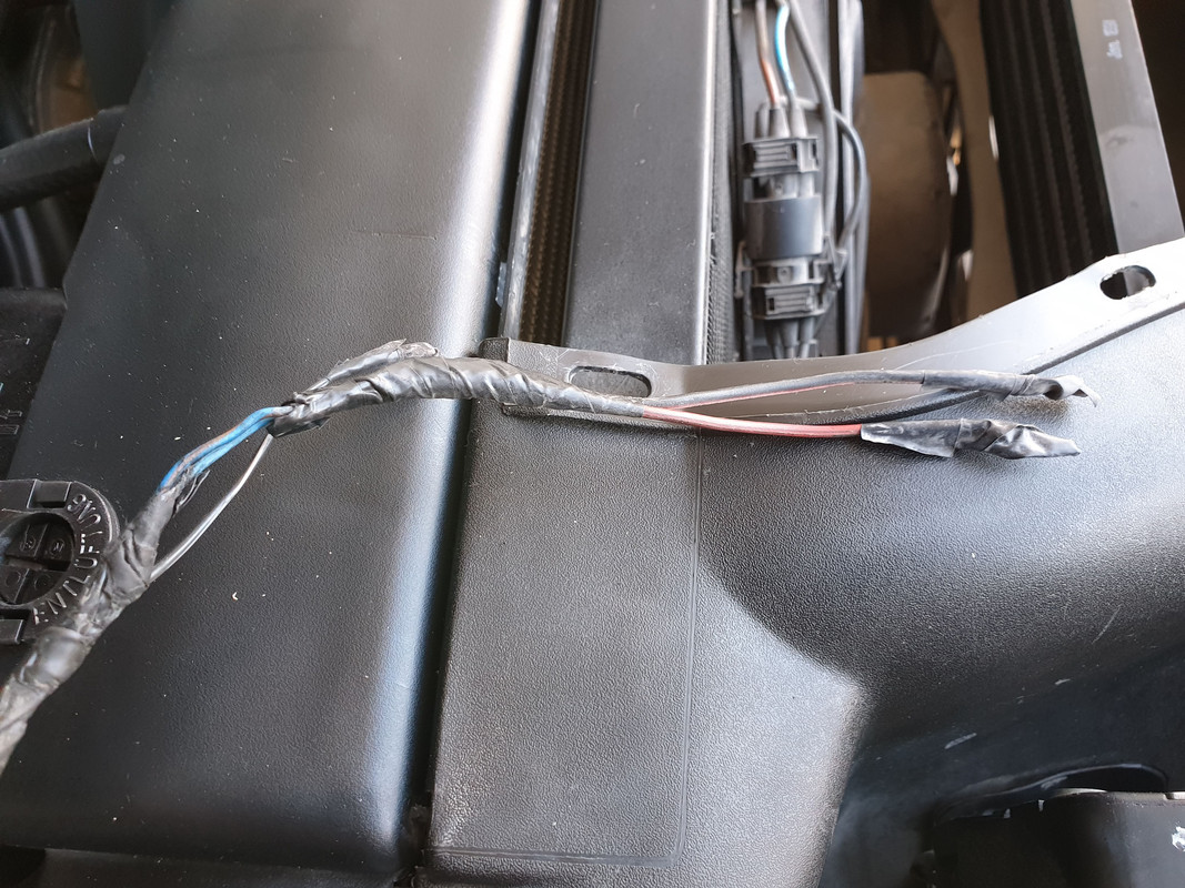

Remember those 3 chopped off wires I couldn't figure out what they were for? It's the connector for the compressor.
https://i.postimg.cc/5NYrMQ64/20190627-185744.jpg
Butchered compressor. All of the wiring on it was destroyed, I have no idea what they were trying to achieve here nor do I want to know.

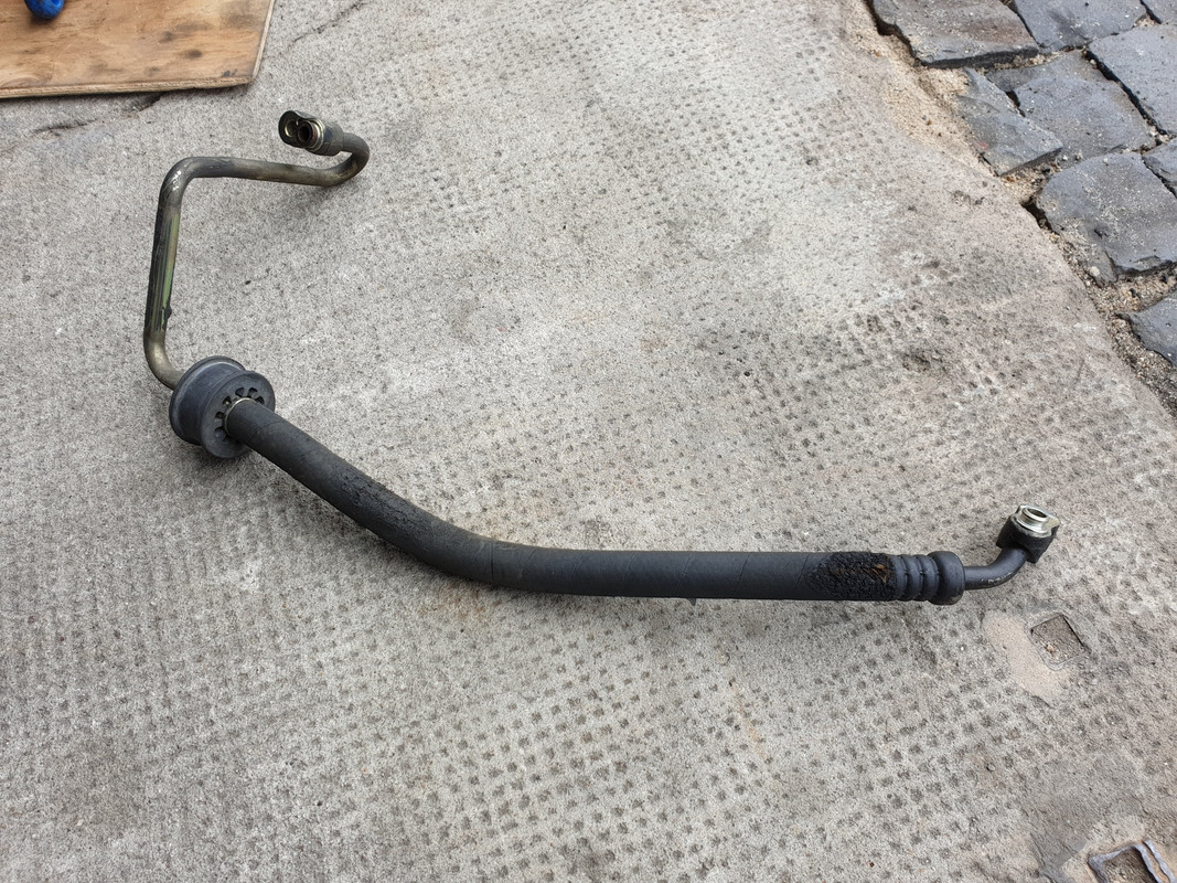

Chewed up line going from the compressor to condenser.

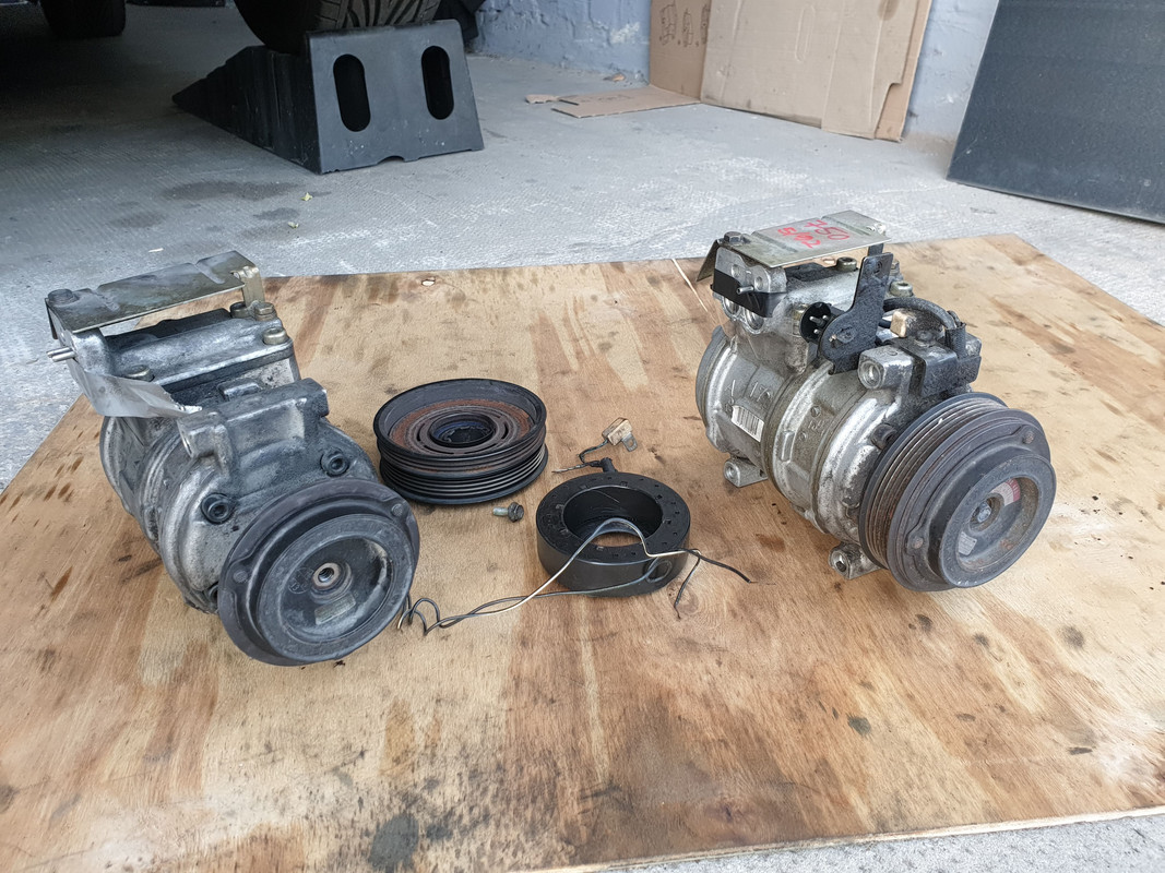

The only logical explanation that comes to mind is that there was a rodent that had a thing for wiring in that corner of the car since there are no signs of accidents there (all of the plastic trim is original). Then an even bigger human rodent came along and played electrician.

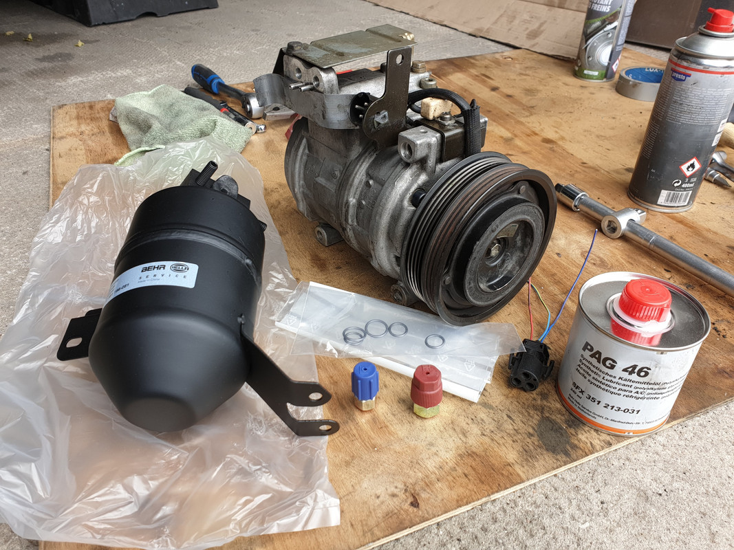

I ended up buying a cheap used E32 750i compressor and transferred the wiring from it to the compressor that I removed from the car. My compressor seemed overall in better shape than the used one I got so I went that route.
https://i.postimg.cc/Kv51xf4F/20190709-194832.jpg
One finished compressor along with other bits I needed to convert the system from R12 to R134a. Added correct amount of synthetic oil to the compressor.

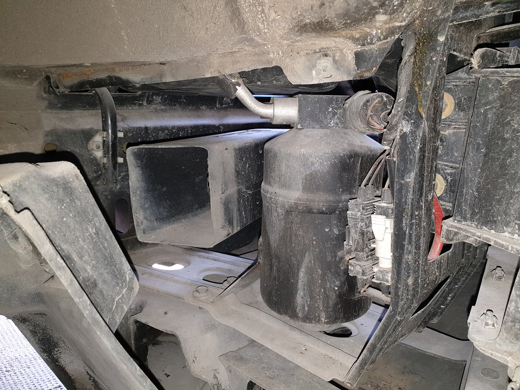

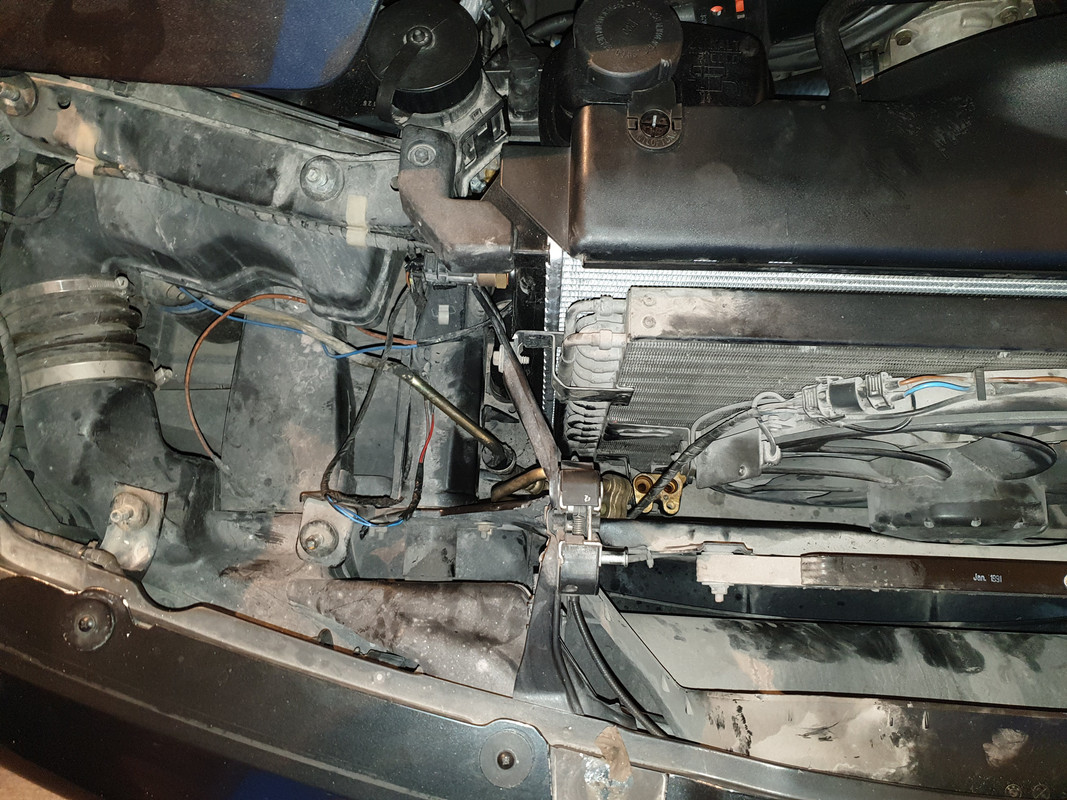

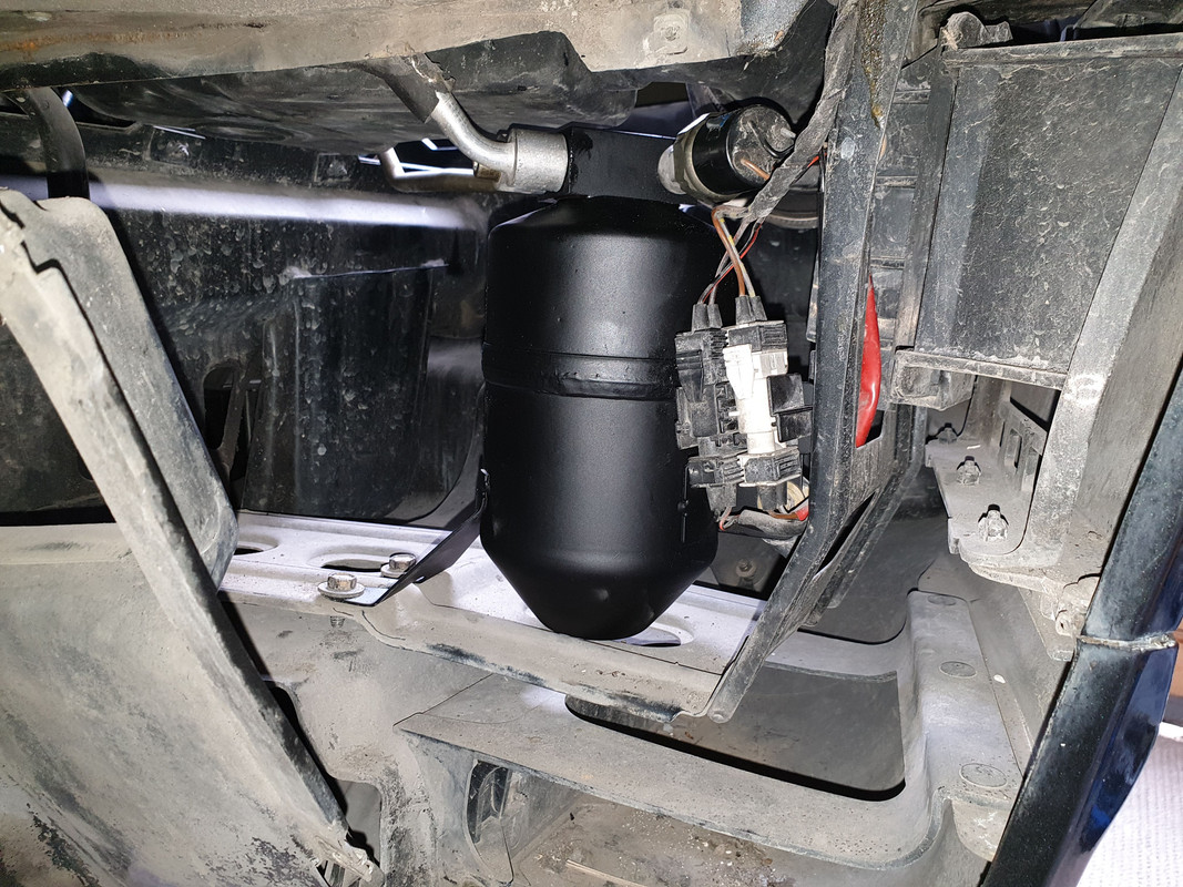

I had to dissemble a good portion of the car to replace the bad A/C line and get to the dryer.
https://i.postimg.cc/zDsQ8w6d/20190709-220122.jpg
https://i.postimg.cc/XY3DyjVd/20190709-220126.jpg
https://i.postimg.cc/rF5Pm0Lq/20190709-220132.jpg

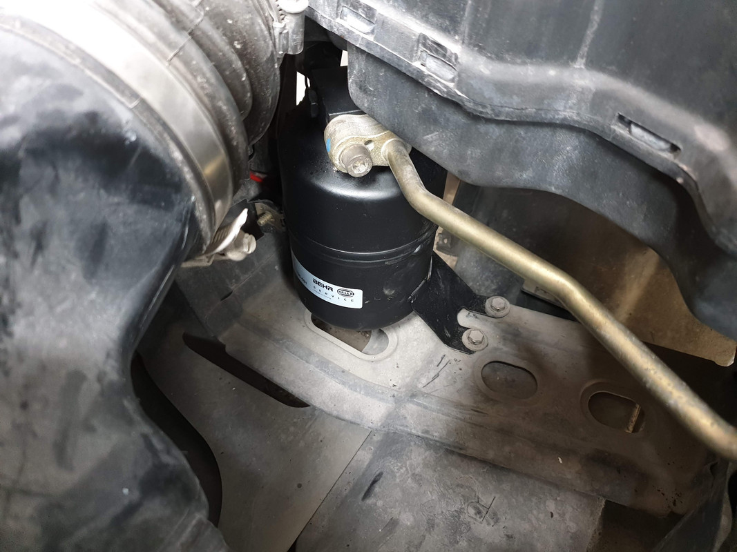

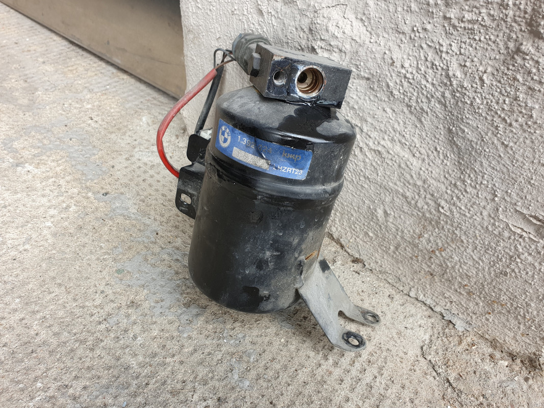

Dryer lurking underneath right headlight.
https://i.postimg.cc/zGcKY7Pv/20190714-152325.jpg

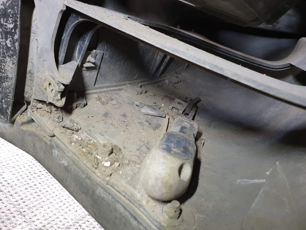

Then I found a screwdriver in the guts of the bumper, presumably dropped there by the incompetent imbecile who previously worked on this car.
https://i.postimg.cc/x8fczNFB/20190714-152546.jpg
Another look at the dryer from the wheel well.
https://i.postimg.cc/8zpggBf2/20190714-152938.jpg
https://i.postimg.cc/Lshdn9Tv/20190714-153808.jpg
New dryer in situ.
https://i.postimg.cc/X72QXwzS/20190714-161227.jpg
https://i.postimg.cc/wjZ2Q9zw/20190714-161233.jpg

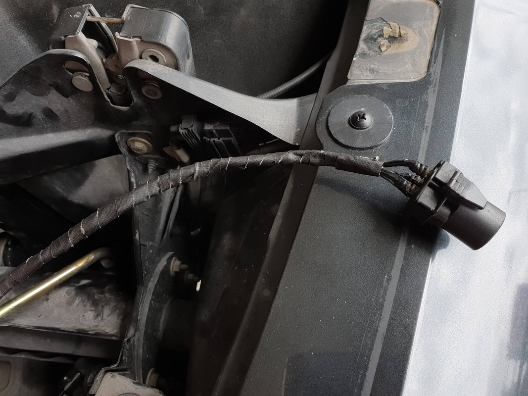

Replaced missing connector for the compressor.
https://i.postimg.cc/RZptcd79/20190714-124213.jpg
https://i.postimg.cc/N0Wrn0Cz/20190714-125654.jpg
https://i.postimg.cc/bvGtLngn/20190714-130331.jpg

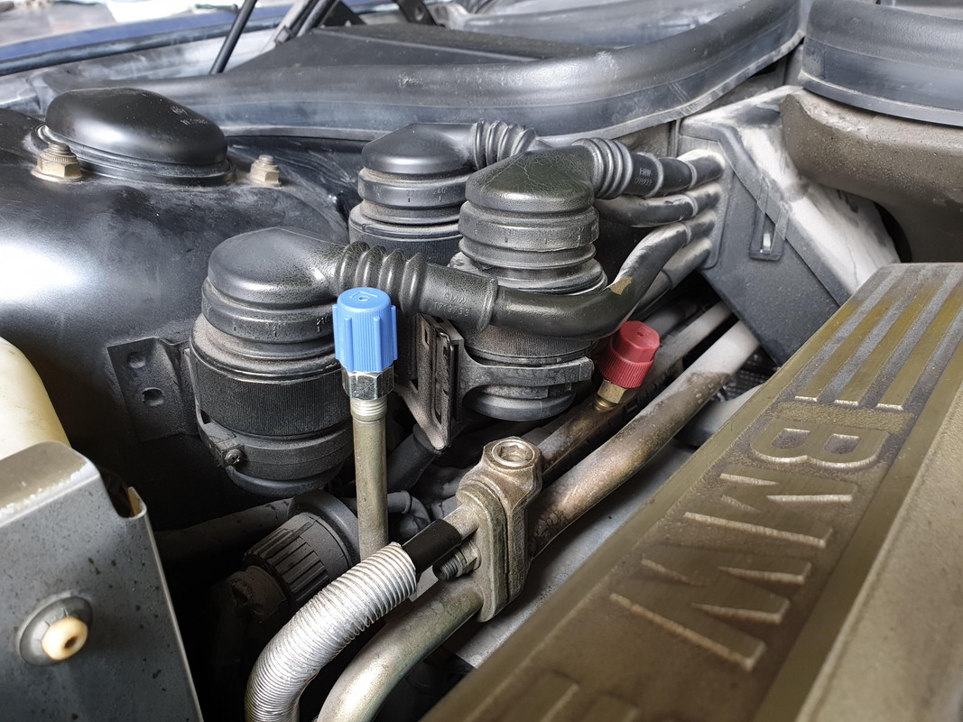

Installed R134a adapters.
https://i.postimg.cc/05JqxyWC/20190714-162502.jpg

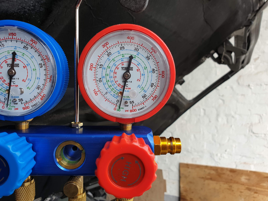

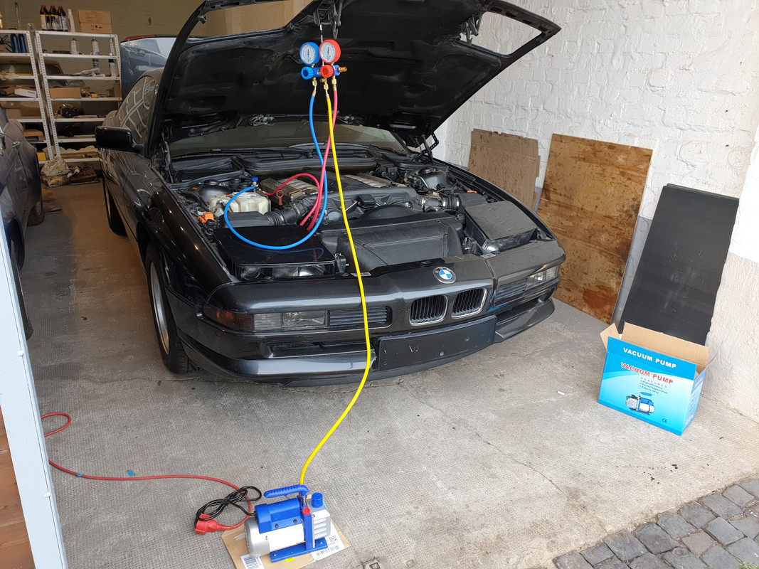

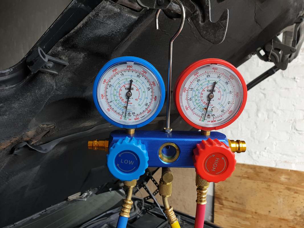

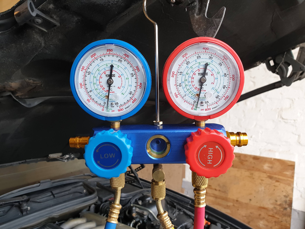

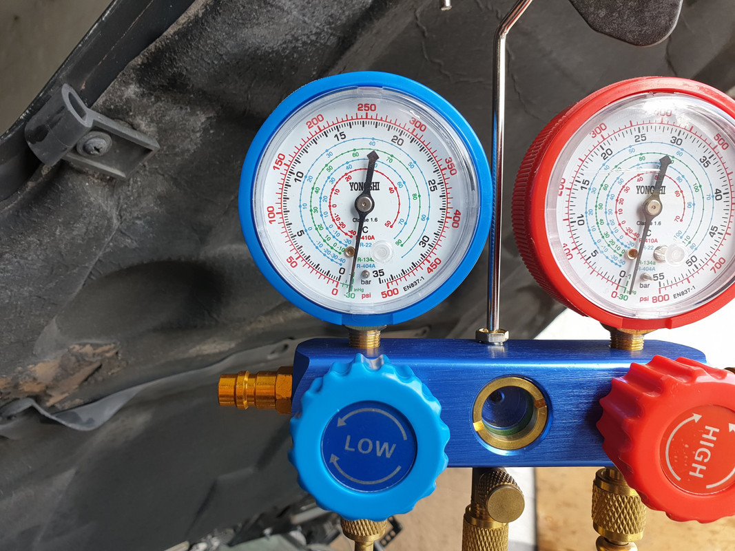

Then it was time to pull the vacuum and pray to God almighty that there are no leaks.
https://i.postimg.cc/gk8XwdJV/20190716-195915.jpg
Upon the first hour, things were looking good and it was pulling steady vacuum.
https://i.postimg.cc/15CTqxjz/20190716-203555.jpg
I left the system sealed and came back tomorrow and happily it was still holding perfect vacuum!
https://i.postimg.cc/mrNKhcxv/20190717-182433.jpg
https://i.postimg.cc/DwG9kjxy/20190717-182427.jpg
https://i.postimg.cc/bvjKzx50/20190717-182430.jpg

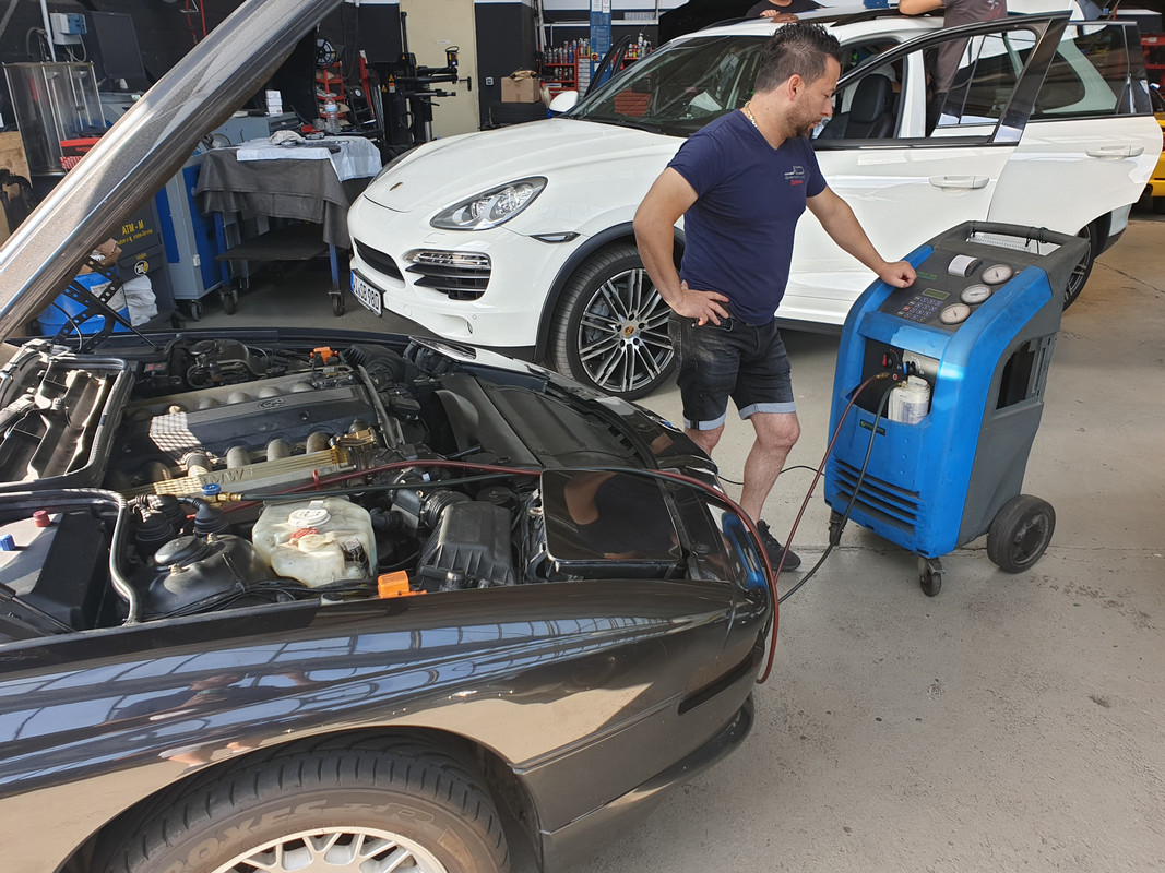

Since in Germany you can't buy cans of R134a to refill the A/C anywhere, I had to find a cheerful Italian to do this part of the job.
The 8er has a large A/C system and takes 1550 grams of R134a refrigerant.
https://i.postimg.cc/J7fnbgHR/20190730-101618.jpg
https://i.postimg.cc/vZMZKVvj/20190730-102156.jpg

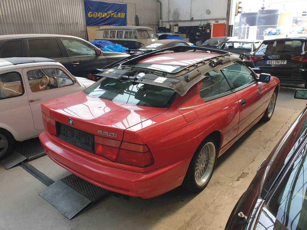

Another forgotten 850i sitting in this shop.
https://i.postimg.cc/4x5xRxL3/20190730-103139.jpg

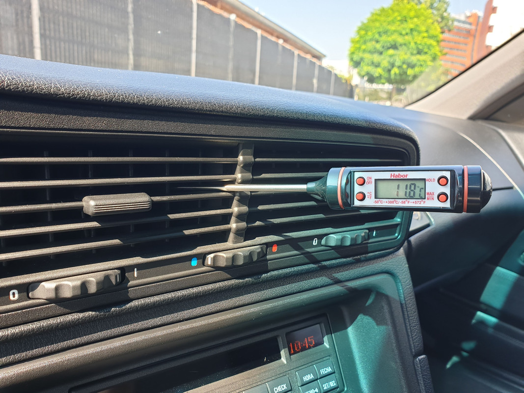

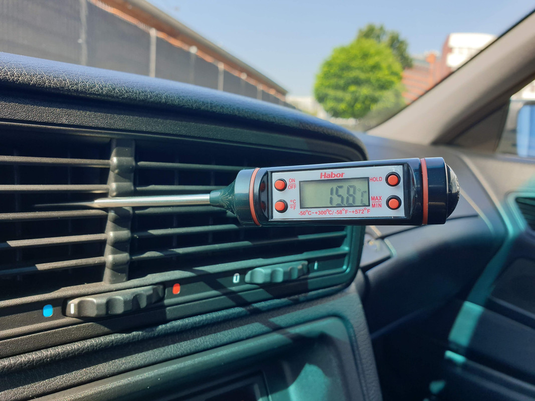

And for the moment of truth.
https://i.postimg.cc/zBMf22dS/20190730-104349.jpg
https://i.postimg.cc/hvdtk86F/20190730-104601.jpg
We have fully functional air conditioning! With this, I have fixed every single thing on this car, every button was working and the car was mechanically sorted.

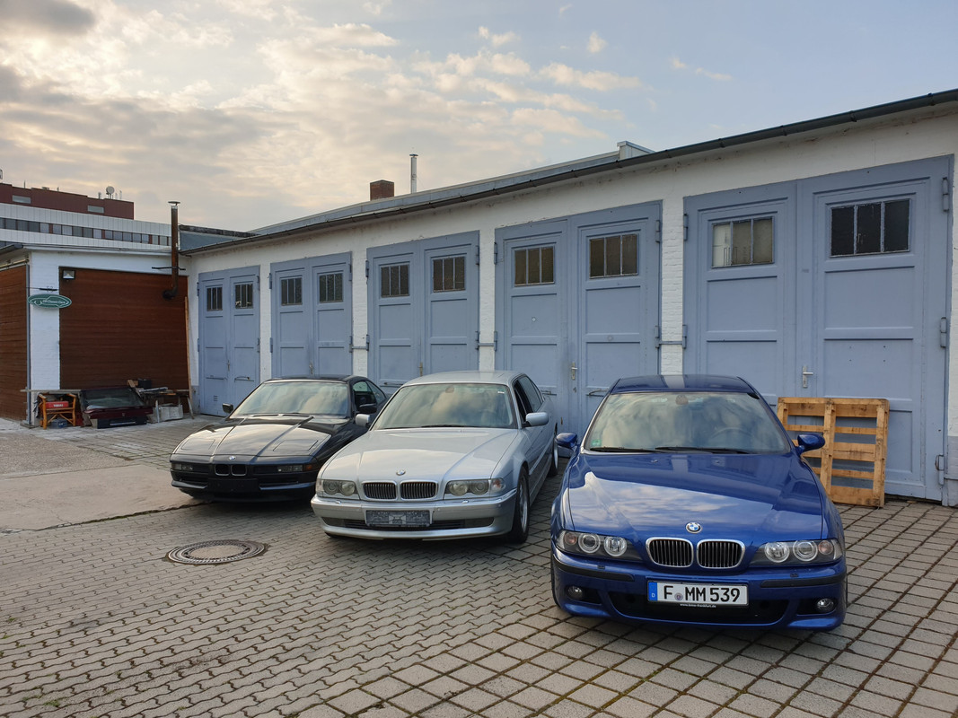

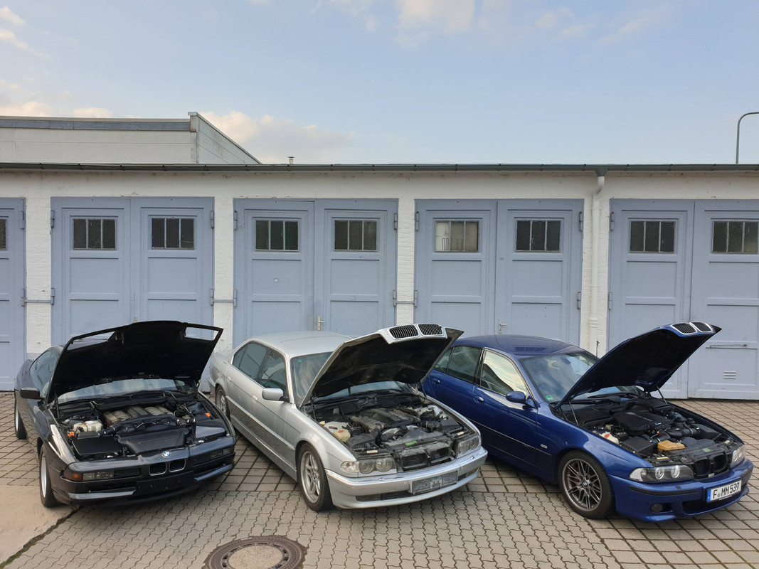

After a long 6 months of trying to sell the E31, I finally found a buyer 2 weeks ago. This is by far the longest I ever had a car up for sale.
I've never had so many idiots contact me and come by, I had a guy coming with 3 sheets of paper printed out with questions and things to test (front and back), I spent 3 hours with him that day and several weeks of emailing just for him not to buy the car.
I had another guy coming twice, 2nd time with his girlfriend and then sending me an email with the list of demands he wants me to guarantee, e.g. that the water pump will not fail in the 50.000 km, that he can safely drive the car 250 km/h, that there will be no oil leaks in the future, that I should guarantee that the km is accurate and the car had no accidents, etc... All of this on nearly 30 years old BMW. I told him he must be smoking something and should go to BMW and buy a new 8 series. After he came to his senses and understood that the car is sold as-is, he had different requests which I'm not going to bore you with.
All of the potential buyers were only hung up on one thing - the cosmetically condition of the exterior, dents and scratches. Despite paint being good for an old car and front and rear bumpers, hood and most of the body panels were actually in original paint. Everyone wants a concourse condition car and pay as little as possible. You can imagine how frustrated I was when everything I've done to the car is overlooked and dents and scratches are used as the main argument.
Anyway, all of that is behind me now and this car was a great learning experience in every sense. I found a very nice buyer and the car will join his collection of 7 cars with this being the first BMW. He is also only an hour away so hopefully I'll get to see the car in the future. Just goes to show you have to be patient and wait for the right buyer. The car was in my custody for around 9 months and I am very happy how it turned it and that I put in the condition it deserves to be.

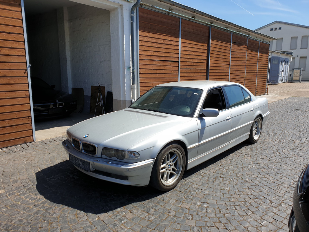

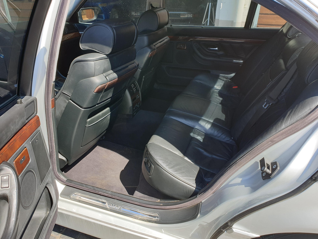

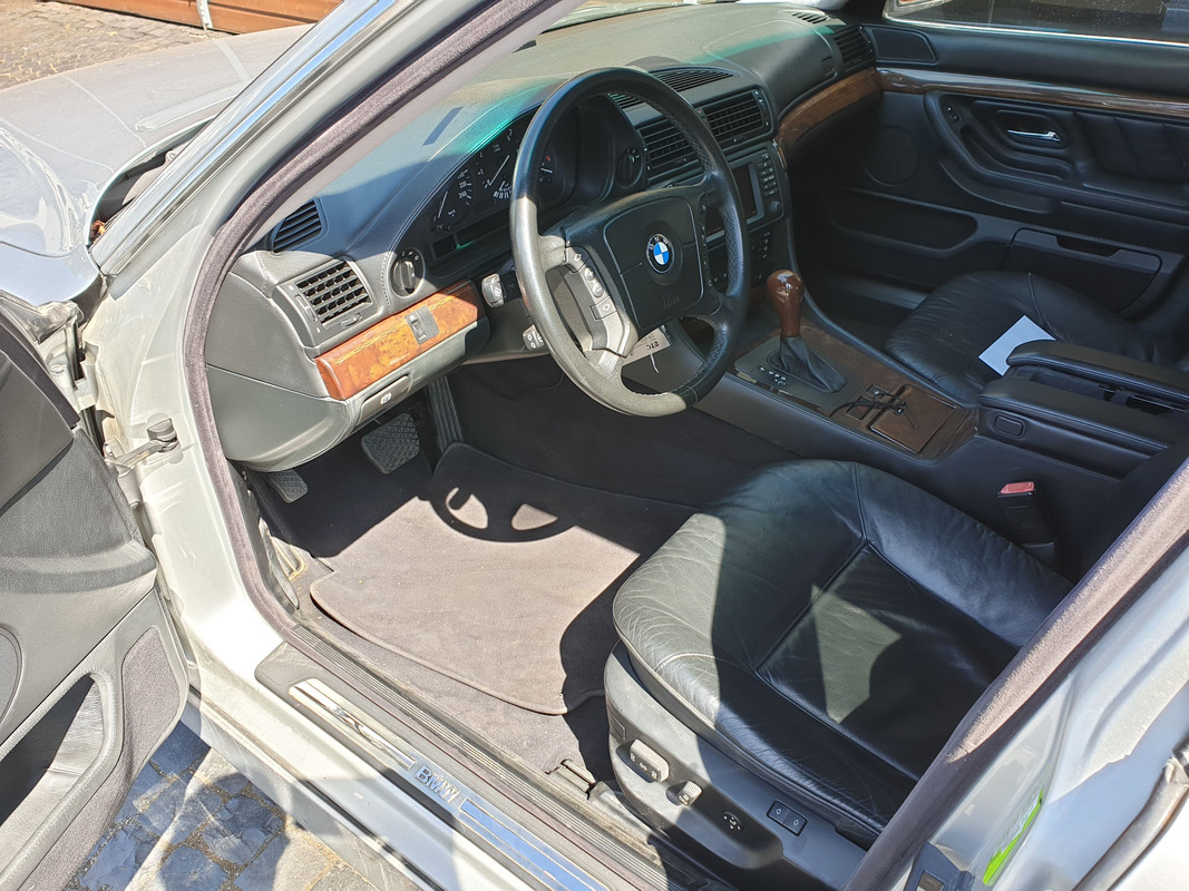

2000 750iL, Titanium silver (which is one of my favorite colors) with black soft leather interior and fully optioned with goodies that I wanted and 125k km on the clock (77k miles).
A very important thing to note about the car is that it is in fact a Euro-spec car with first delivery being Japan. As some might know, Japanese cars are generally very well kept cars (this one isn't anymore) and Euro-spec means it will be easier to get it to register it in Germany with probably some necessary tweaks. Here's a VIN if someone wants to look up its extensive options: DG50835

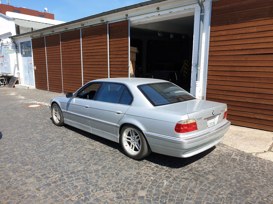

Pulled it into the yard for a first look.
https://i.postimg.cc/wMG5QRb4/20190723-113856.jpg
https://i.postimg.cc/1tyKmQqB/20190723-113844.jpg
https://i.postimg.cc/dQH9YgtR/20190723-113911.jpg
https://i.postimg.cc/vH4tHXcJ/20190723-113925.jpg
https://i.postimg.cc/KjzrTDQg/20190723-113933.jpg
I'll talk about the condition of the car in the next update. For now, I give you 32 cylinders and 1.026 hp in one picture!

Yeees, that's a normal occurrence, but we don't go around with wire cutters and start cutting everything in our way which is what someone did, so I had to express my displeasure.
