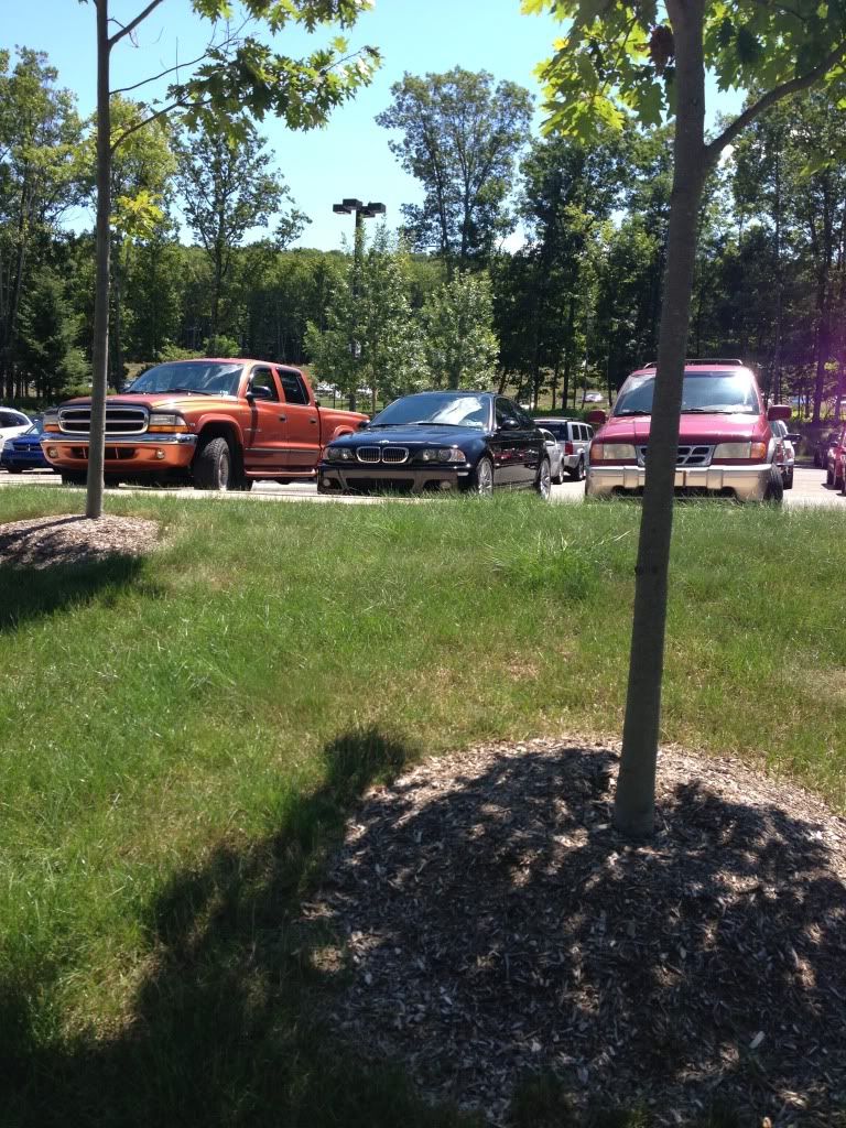

Drove the ///M to work today...
http://i864.photobucket.com/albums/a...06/null-64.jpg

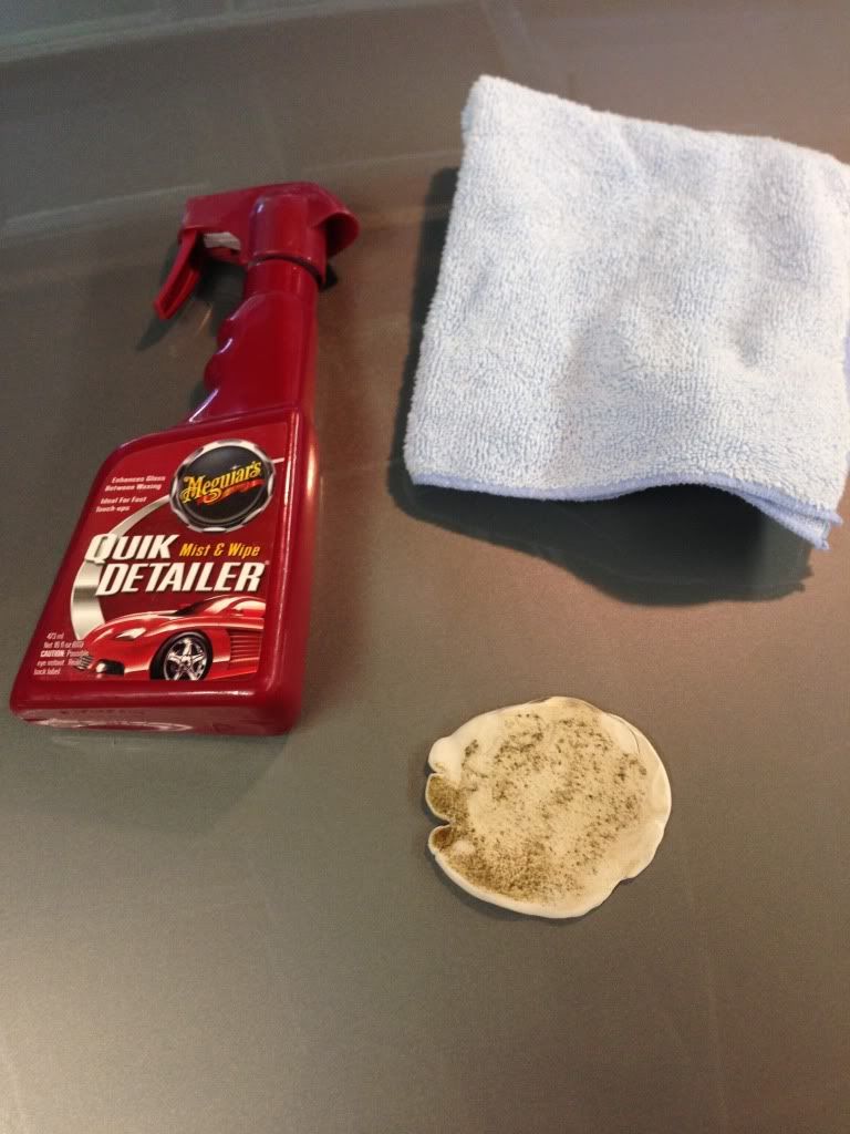

Also spent the better part of my morning detailing my mom's SUV for her. This is what my clay looked like after half of the hood. Yikes...
http://i864.photobucket.com/albums/a...06/null-63.jpg
