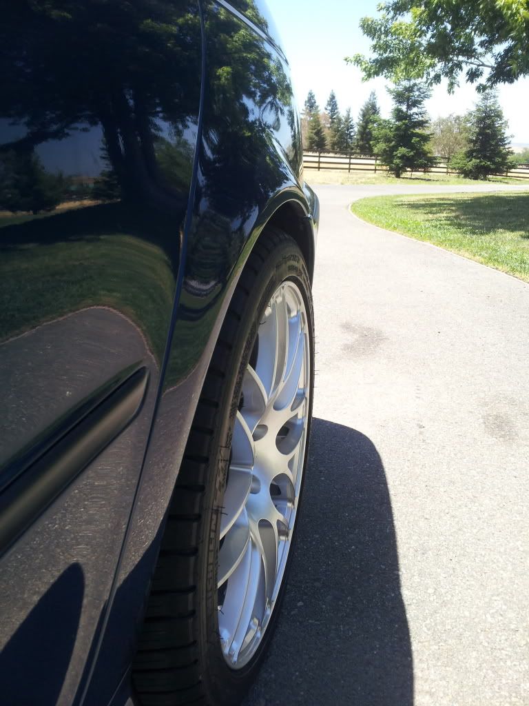

I've been getting a ton of rubbing. I'm thinking a fender roll may be necessary here pretty soon...

Avetiso is too high to rub! What tire/wheel/spacer/suspension setup are you on Dimitri? My ZHP rubbed with ET45 265/30/19 rears while tucked on coils and fenders rolled. The part where it still rubbed was the front side of the fender arch (driver side @ approx 10 o'clock) because as the car's suspension compresses the wheel/tire moves up and forward. I rolled that out and everything was perfect.
I'm on stock springs with Koni adjustable's. The wheels are 18x8.5 et35 and my tires are 255/35/18. No spacers...
I made my suspension as firm as it would go and I still got rubbing on bumps and hard cornering.

ET35 is aggressive for an E46 sedan. I tried running that on my lowered height but it was impossible to move the car out of the driveway. LOL. You'll need some aggressive rolling. On the driver's side, as far as you can go down in the front 9-10 o'clock to 2 o'clock or further. :)

Actually... My last set up rubbed. 8.5" ZHP wheel on a 15mm spacer rubbed on my car pretty consistently. Same tire I have now. I am rolled in the back already, however, but I don't think I'd rub with 265 in the back. Again, ARC8 was made for my car. Offset is perfect. 9" ET42 square.
Just run not so wide rears. 255 would normally be too much for ET35 at least on my previous setup. PM me for more info or create a new thread as I don't want to thread jack.
