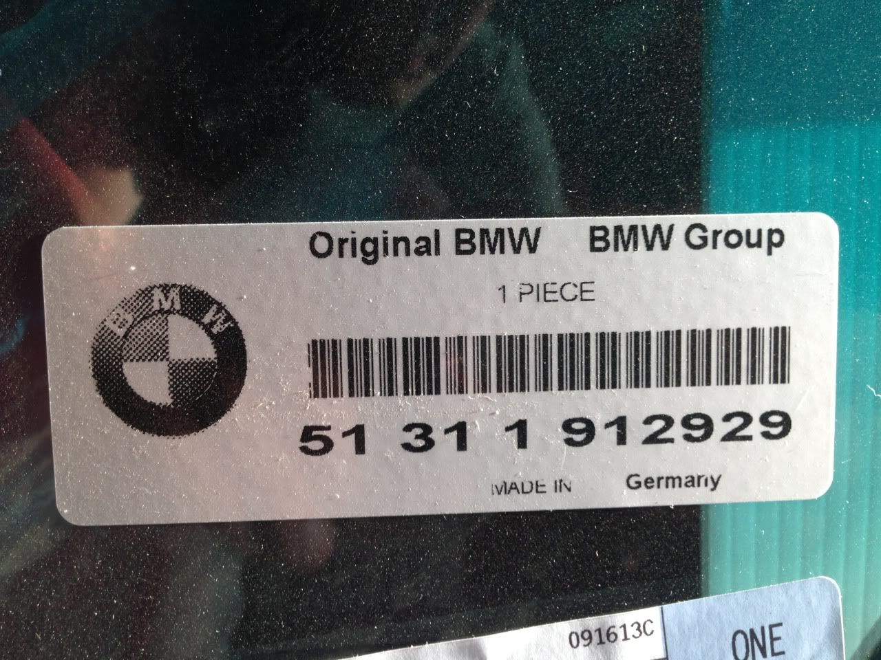

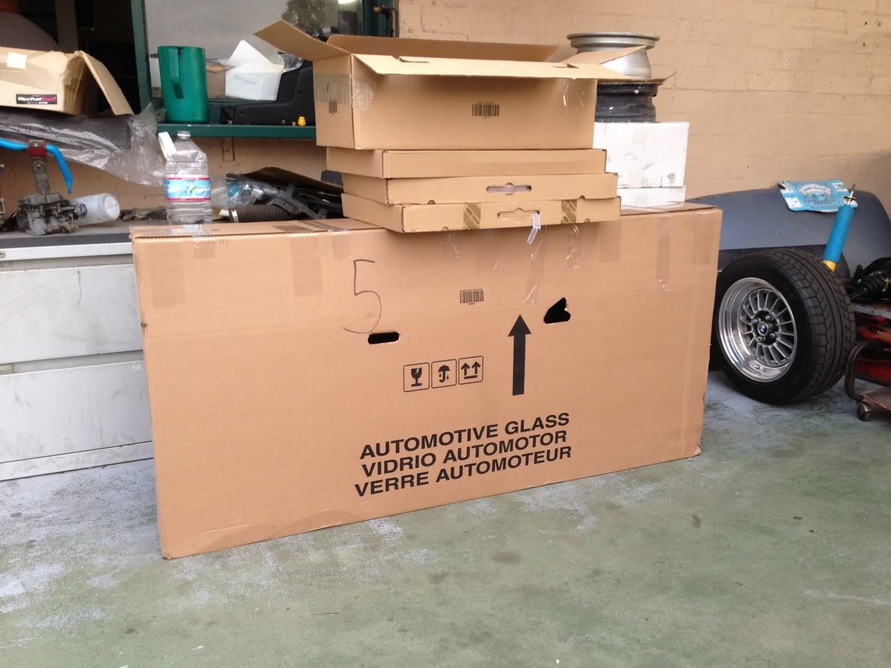

New windshield arrived for the 320, will probably have it installed next week as I don't have time to drop it off this week since I am taking the zhp to autoX this weekend and need it ready.

How does your Cowl cover look? May be a good time to replace it.
Good deal on that OE windshield Hermes. Where did you buy it from?
