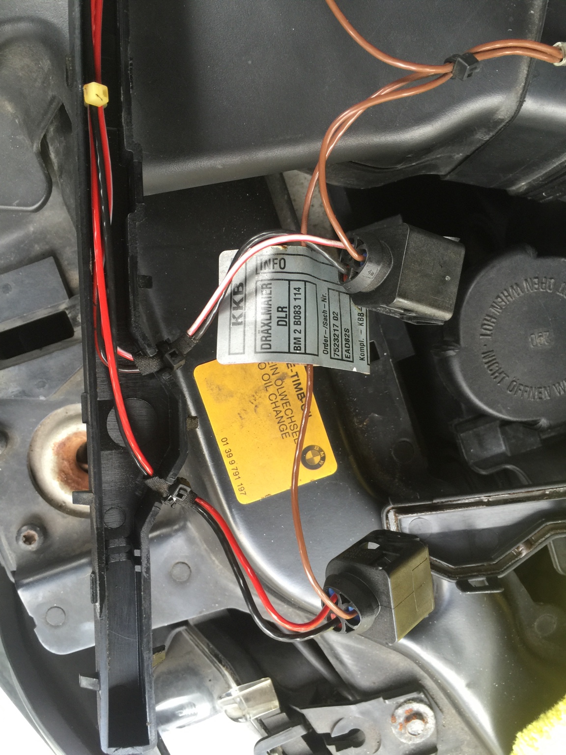

Upon visual inspection they seem fine but I'm going to pull the railing thing off and check under there (if that makes sense). Anything in particular to look for?
Edit: could a leaky VCG be the problem? There seems to be oil coming from the VCG right above cylinder 1...
Make sure the wiring harness for the #1 coil isn't damaged in any way.
Attachment 23529

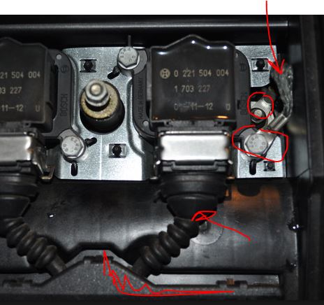

Check the harness where the red arrow is pointing and make sure you have good connection on the two circles.
BP suggests to check the wiring harness as well, that is the red wiggly line at the bottom. Might want to remove/unclip that plastic cover to ensure everything looks normal.
Harness and connection seems ok albeit it a little oil under either the long plastic holder thing. Going to do the VCG while I'm this far.
Attachment 23530
Yeah, that all looks good. Might need to do a compression test.
