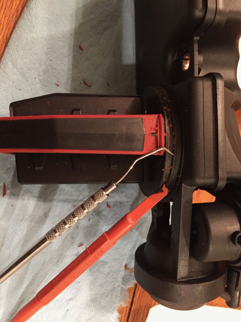

Originally Posted by
SaltyNC
This is what transforms the DISA upgrade from a 10 minute job to an hour job. My "o-ring" was not deteriorated at all. The entire unit looked brand new. It took forever to scrape away all of the existing silicone from the channel. It isn't really an o-ring, but rather the silicone is molded directly on the unit. I used some Harbor Freight picks I had purchased earlier from working on an aquarium CO2 regulator. I also had an old 66-block telecom pick. I use that thing all the time to remove o-rings. It worked great to wrap the plastic end with some Scotchbrite pad and scrub out the channel. Still, it was a very tedious job and took a long time to completely clean up.
Salty
