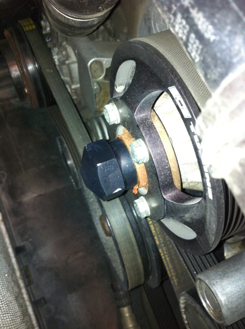

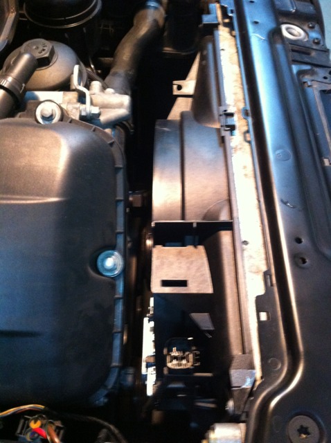

All Done! Just swapped the Mechanical fan with the new BEHR Electric fan. Super easy! I will remove the bumper this weekend and take out the Auxillary fan. The weather is only in the 80's so I should be ok. The car is so quite without that dam Mechanical fan!
Attachment 7726
Attachment 7727
Attachment 7728
I wonder if there is a way to leave the front pusher fan in and wire them both in?
It's funny you say that. I actually noticed it right away, it felt like when I installed the Sprint Booster.
Thanks for the heads up on the Painting, will do.
I was thinking about wiring up the Aux fan on a switch. The only concern is the load running both at the same time. Thought about wiring it for a backup (just in case) but without it running it is a huge restriction in air flow.
The BEHR fan works really good, I was suprised how much air it moves.
I see you are in Vegas where it gets extremely hot. Please post back how you are doing after the ambiant temp goes over 100. My only concern about this (which I'd like to do) is how well it handles those extreme situations like sitting idling at a stop light on a really hot day.
Guys from e46F who originally did this conversion all have positive feedback even during summer season, I read somebody from Arizona and went thru the whole summer fine running just one fan on his e46.... I believe KPeng is from Florida and never reported any issue as well...
