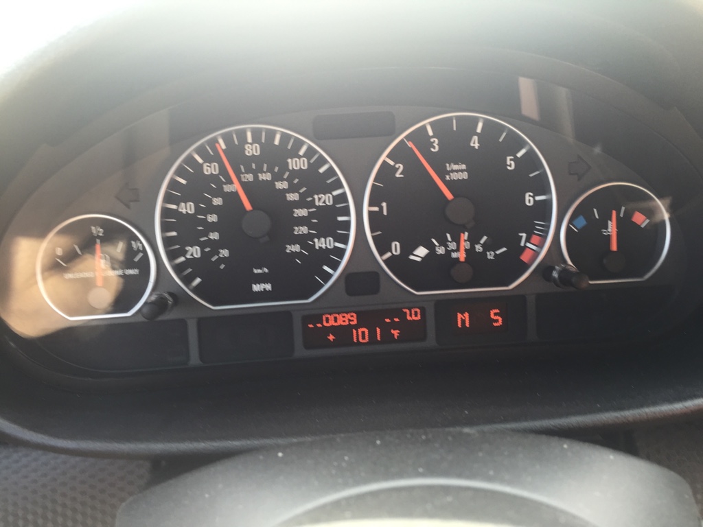

I didn't check the software number but it flittered between 97 and 98:
http://i.imgur.com/szlCa9J.jpg
