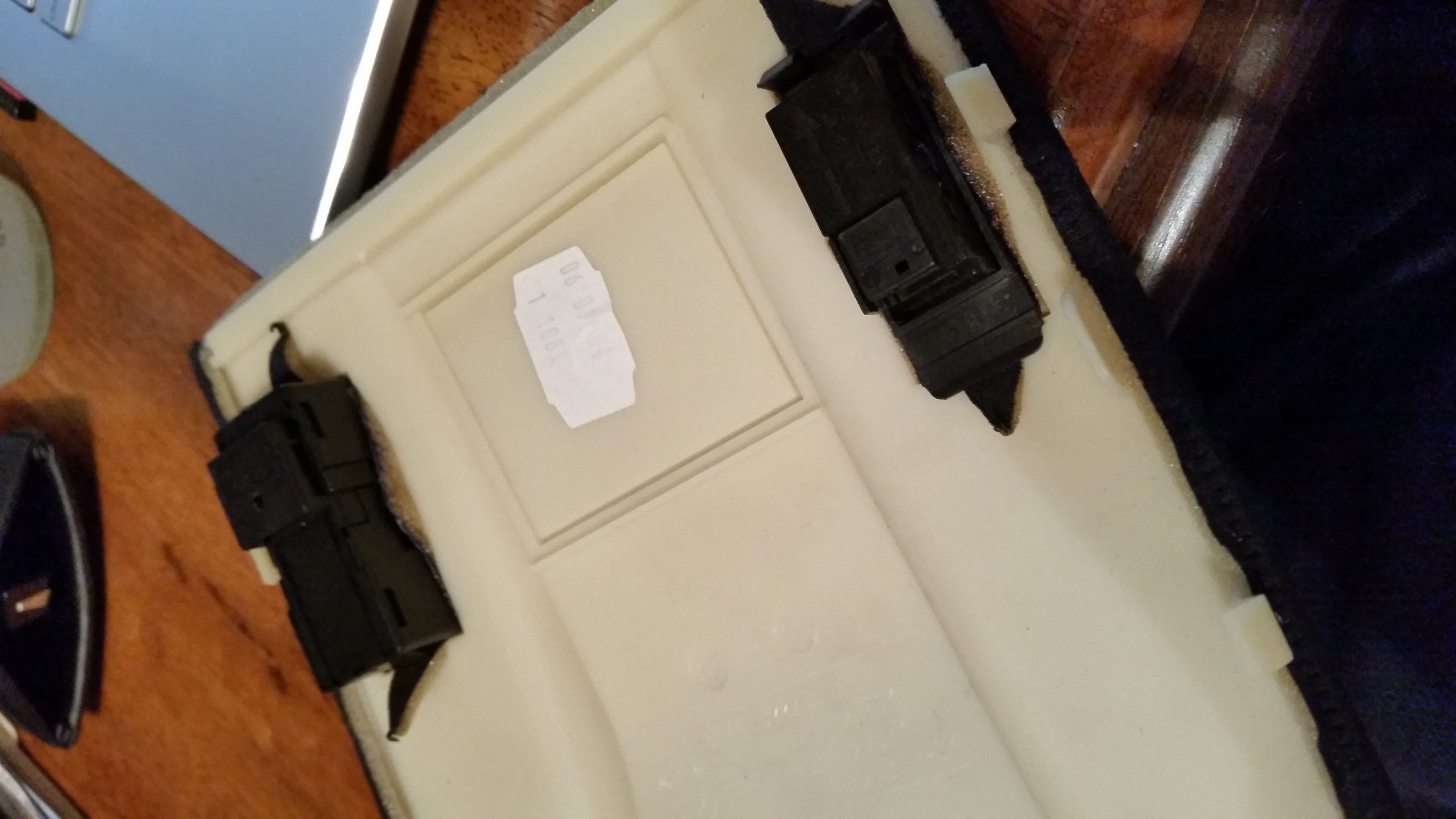

Is this the mic at the top of the picture already installed? Do all of our cars have this? If not, why would this be in there unplugged? Looking at installing oem bluetooth because useless buttons drive me crazy! Will be tearing into trunk when I have more time to investigate. Attachment 20782
That's where it would be but not all cars came with. In fact, if you don't have factory Bluetooth I would guess you wouldn't have the mic.
