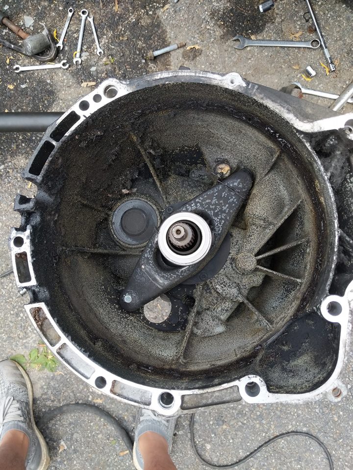

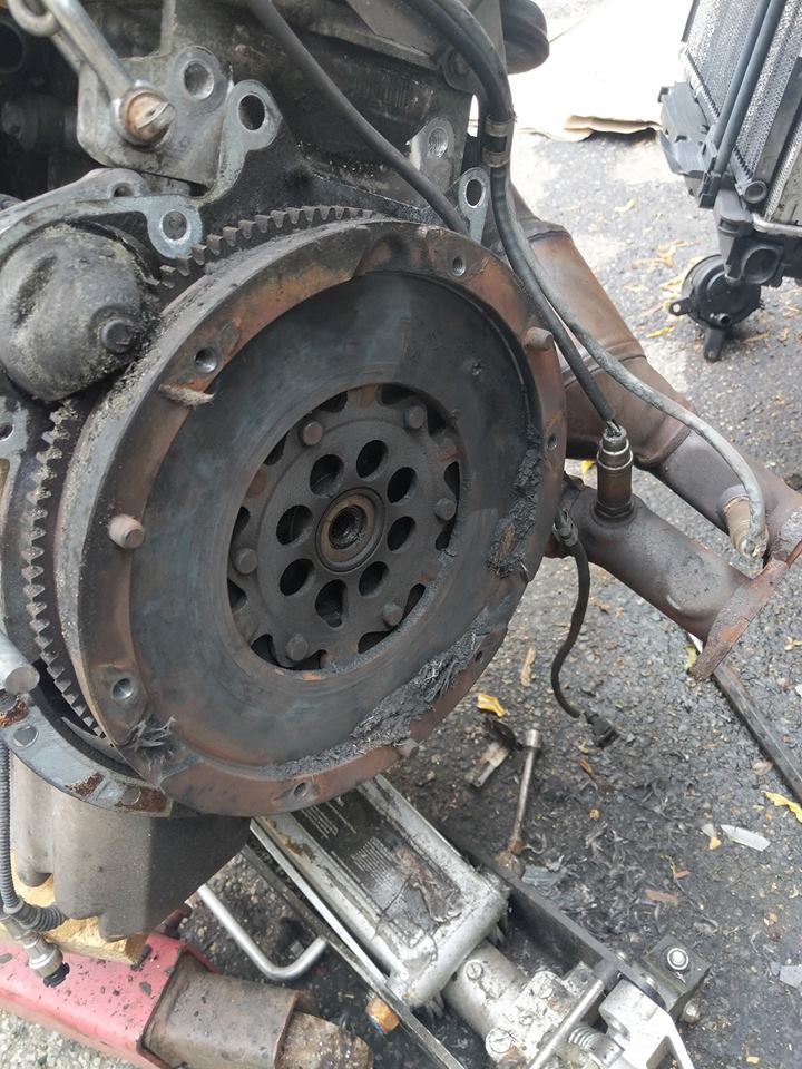

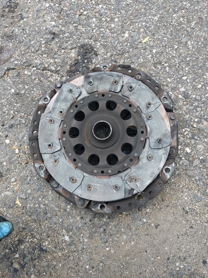

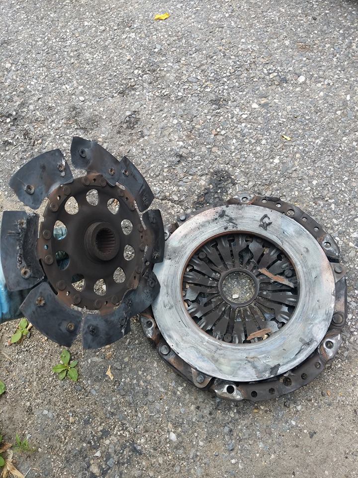

So my clutch went out about 6 months ago while I was on my way driving back from NYC. I had to get the vehicle towed off the highway and then towed all the way home. It was an easy 6 hour day with towing and waiting. I had originally tried to take the transmission off and couldn't get the tranny bolts off without applying way too much force as I didn't have the right tools to brace the transmission and align it with the engine while trying to take it off. I ended up burrow an engine hoist to actually remove the front end of the car and pull everything out altogether. It was much easier imo to do that as it only took about an hour to take off and remove the engine/transmission from the car. The vehicle had about 186500 miles on it when the clutch went.
Attachment 34372
Attachment 34373
Attachment 34374
Attachment 34375
Attachment 34376
As you can see I eventually got the tranny bolts off and had to rethread the holes to make sure the bolts went in and out smoothly. The clutch was completely toasted. I ended up ordering parts from FCP euro. It was my first time doing a clutch job and honestly, it was a great time to get a better understanding of how the transmission and clutch worked. Total cost ended up being around $900 dollar in parts including some other additional stuff I needed to do to the vehicle.
