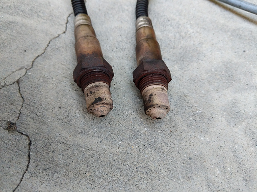

Changed Pre-Cat oxygen sensors 192500.
Attachment 35058
Daily is the zhp right now. I didn't really see any difference with the o2 sensors as I'm still getting secondary air system faults.
