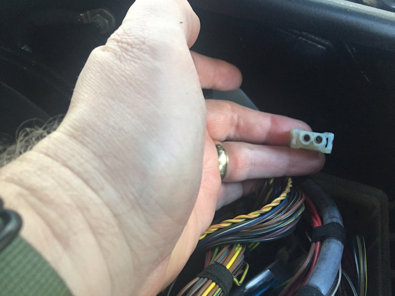

Can you post a pic of where the connector is?
It's a two wire connector on my 2005 330Ci auto. Hope that helps.
Attachment 32033
And in this first photo, that's the other side of the connector that clips to the side of the DME enclosure.
