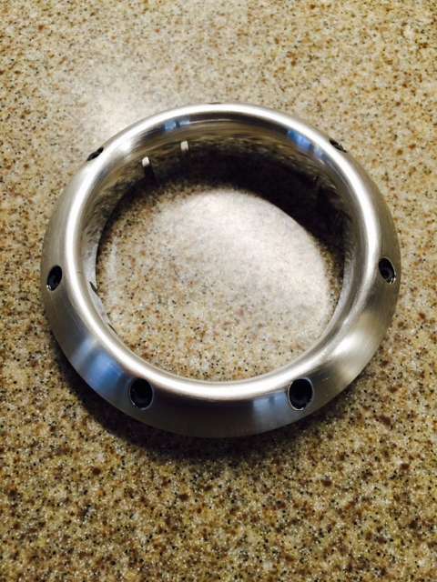

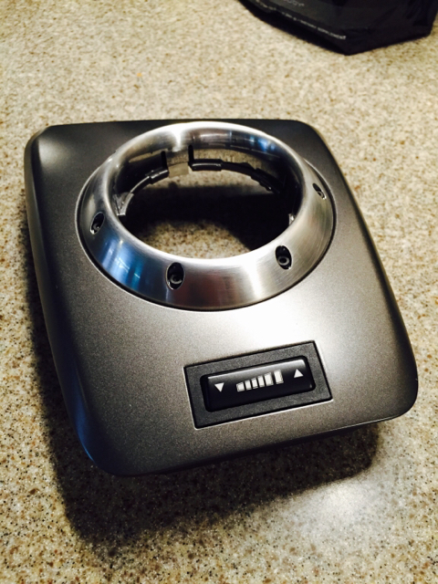

Commencing M5 shift knob upgrade! Sanded down the gator ring with a scotch pad to give it the brushed aluminum look. Man it turned out perfect! [emoji106]

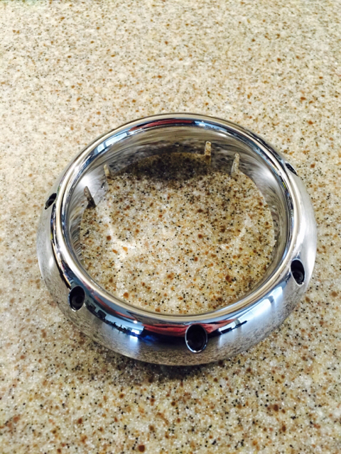

Swapped the plastic ring from my old boot to the new one. Will let it dry until tomorrow and start the install. [emoji41]
That ring looks great! How easy is the wiring? Plug in play or soldering involved?

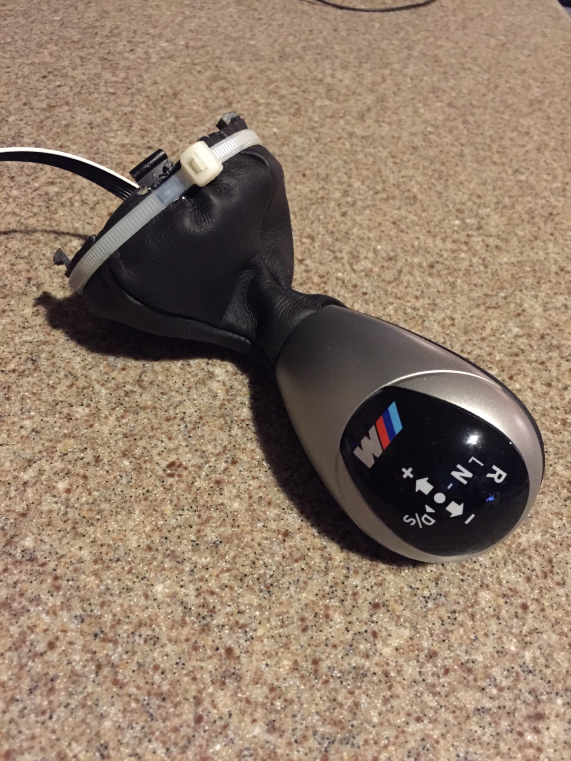

I purchased the connector that plugs into the plug on the shift knob and six wires that extend from that connector. Two get wired into the shift selector and then just tap into the reverse and neutral wire down on the main plug. Doesn't look hard, I will find out tomorrow when I go to wire it up.

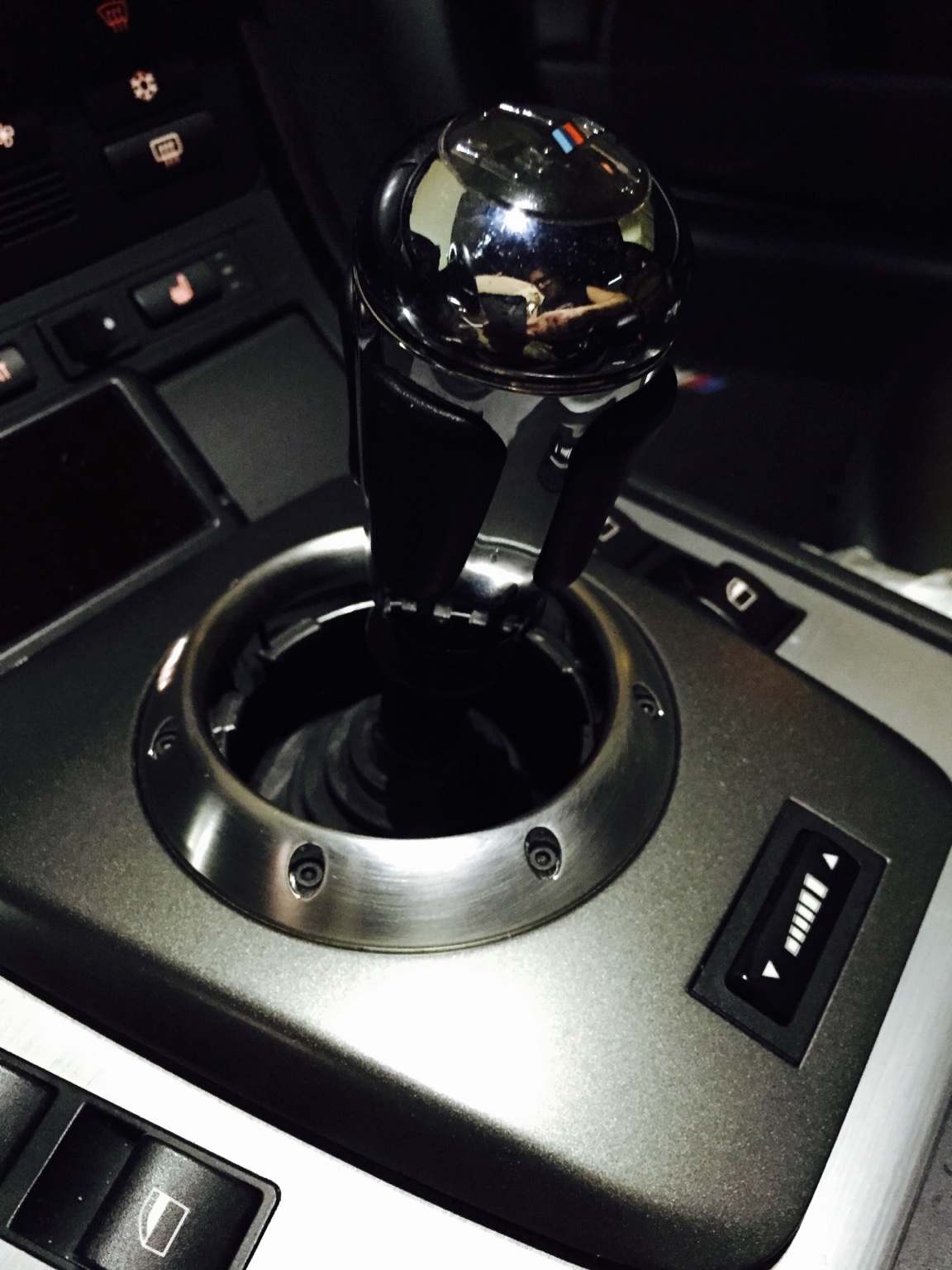

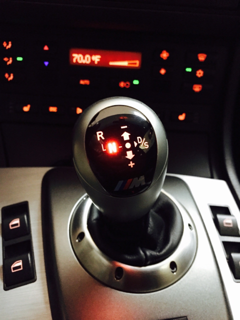

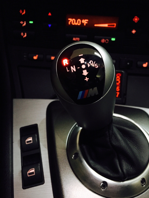

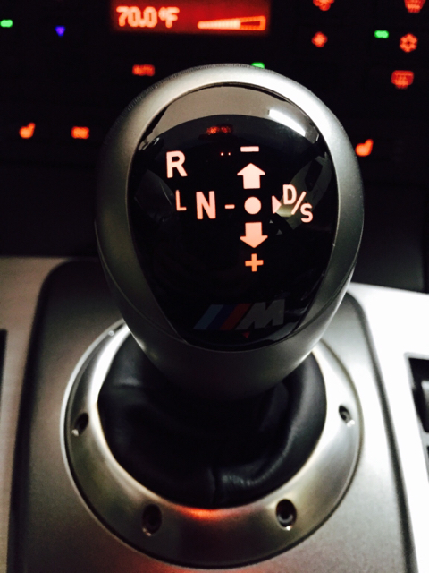

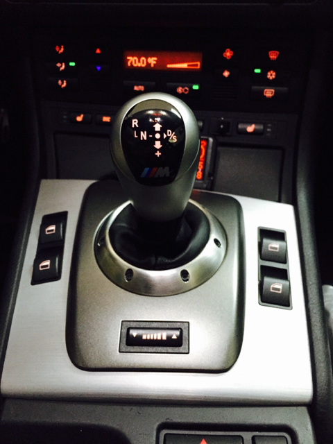

Got the M5 Shift Knob installed. What a difference in the way it looks and feels! Bye bye chrome! Wiring was pretty easy after finding the proper diagram.
Here is the wiring info if anyone needs it. I wired up the background illumination, neutral and reverse. I didn't want the drive/shift because it was too bright at night.
SMG M5 Shift Knob
1 = Zone Reverse (GND)
2 = Zone Neutral (GND)
3 = Zone Drive A/S (GND)
4 = Night Illumination (GND)
5 = Switched +12v for Night Illumination
6 = Switched/Constant +12v for zone lighting
SMG2 Control Module
1-(Reverse GND) to 3 (White w/Green stripe)
2-(Neutral GND) to 7 (Yellow w/Blue stripe)
3-(Drive A/S GND) to 8 (Green w/White stripe)
4-(Night Illumination GND) to Brown w/Black stripe (SMG Switch)
5-(Switched +12v) to Grey w/Red stripe (SMG Switch)
6-(Switched/Constant +12v) to 1 of the Red/White wires.
Awesome, looks much much better!
Looks really good Gary!!
Thanks guys! It's funny how some of the easiest mods can end up being your favorite ones. This one is one of those mods. Just love how it looks and feels, and the lights are just icing on the cake.
