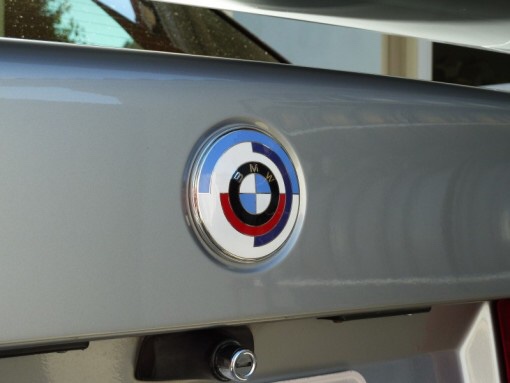

Has any one ever seen these roundels before?
Attachment 22411
-Holden
I've seen them before, probably on ebay. I remember the description said they were "really old" roundels.
These are listed as Motorsport roundels. $140 for front and back
