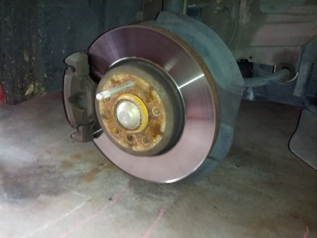

Brake wobbling, have replaced everything that could have possibly contributed to it minus the bearings and hub assembly.
When I took the rotors off and shook the bearings, they were visibly loose.

Go to AutoZone and get two Timken-branded hubs for $45 each. Literally the cheapest you'll get, and they're identical to OE. Other than that, the only special tools you'll need are:
- 46mm socket
- 36mm impact socket (for whacking the hub on - bonus: if you don't have one yet, this also works on the oil filter)
- 250 ft/lbs max torque wrench
- 10mm deep socket
- Mallet
- 2-jaw puller
If you've been doing car work for a long time, you've probably got all these. In that case, pick up 2 new hub nuts, 2 new hub dust caps, 2 new rear hub dust shields, and both of those wheel bearings. You'll be done in a few hours by just taking your time. The longest part is the cleanup.

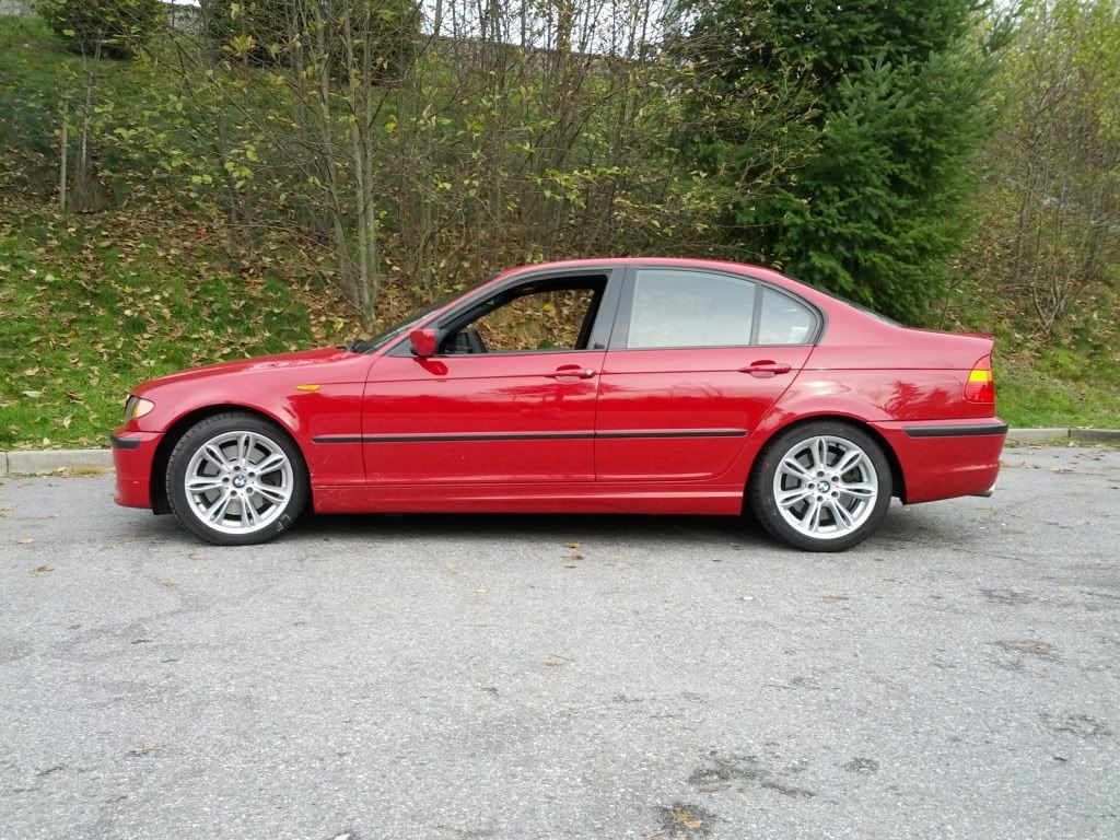

The finished product. Somebody was asking for pics of these wheels mounted after I posted a post cleaning pic of them a few weeks back. They're not bad, but I miss my 135M's already. :)
http://i1254.photobucket.com/albums/...ps38babb55.jpg
Still need to clean the chalk marks off! :)
