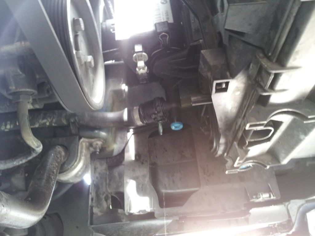

Is this the correct belly pan? I was on real oem and it was being excluded from the parts list I was looking at. Does the Zhp have a different belly pan to accommodate our aerodynamic brake cooling ducts?
http://images.tapatalk-cdn.com/15/12...93774f8a80.jpg
http://images.tapatalk-cdn.com/15/12...8a255ec6d5.jpg
That is the correct one. Check out fcp euro might have better pricing
