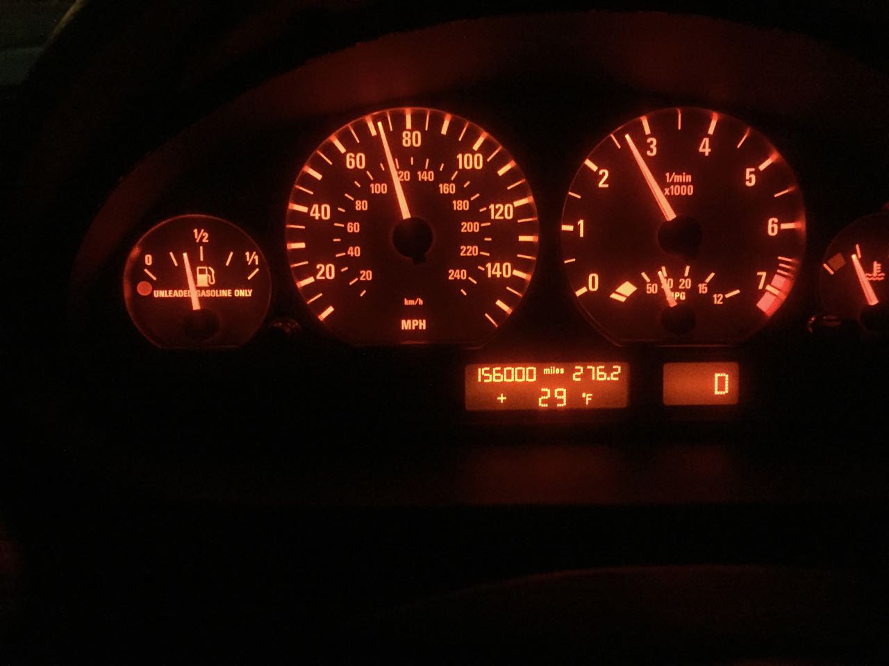

It felt so good today compared to the cold weather we have been dealing with, so I decided to swap out the thermostat. I didn't really want to do it, because I also plan to do a complete coolant system refresh, and I also need to remove my front bumper and take out the aux fan, and it would make so much more sense to do everything at once...except, I didn't have time to do everything, and didn't have all of my parts in, though I had most of them. On the hidden menu under test 19-7, my temps were staying in the 45-55C range, and my temp gauge was leaning toward the cooler side. You can see where the temp gauge was running in this shot on my way back from picking up the car:

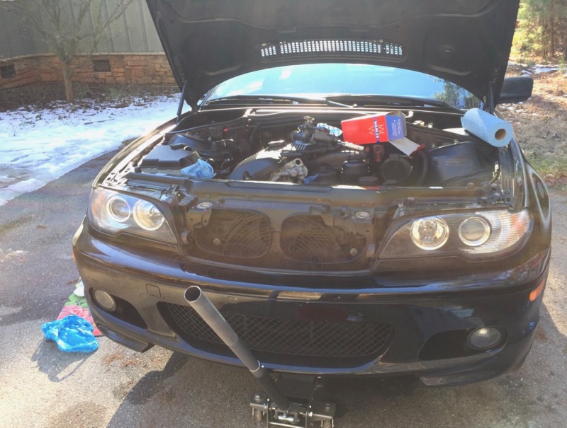

I placed one of those rubber jack pads used for the plastic jack points under the front reinforcement plate in the oval recess, and jacked the car up to lean it back, so I wouldn't lose as much coolant, and put a couple of jack stands in the appropriate jack points on the front sides, and scotched the wheels with rubber tire chocks. Even though it was close to 60F today, the snow we had earlier in the week is still sticking around. Our house is back in the woods, so it's always about 10 degrees colder that the surrounding area. I went with a Wahler thermostat, You can see the Wahler box on the engine. It comes with the required gasket.
Attachment 31809

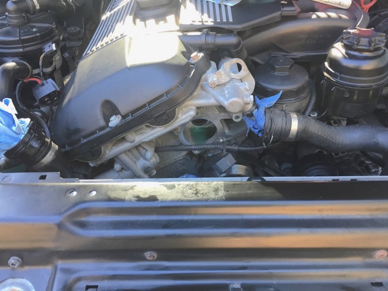

I was able to release both hoses from the thermostat without losing a lot of coolant. I had wedged a couple of aluminum baking pans under the hoses to catch most of it, and then was able to transfer it to a bucket. I probably could have re-used it, but I played it safe and refilled with fresh coolant.
Attachment 31810

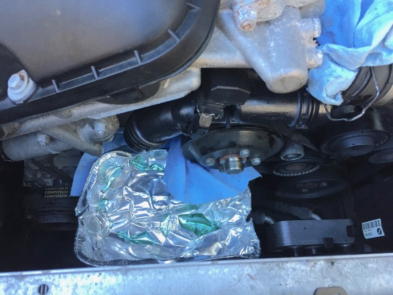

Here you can see the makeshift coolant catch pan.
Attachment 31811

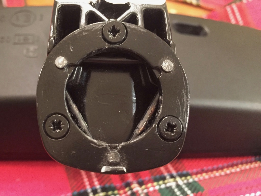

Here is the back of the attachment point. You can see the three bars that provide the tension on the window mount.
Attachment 31832

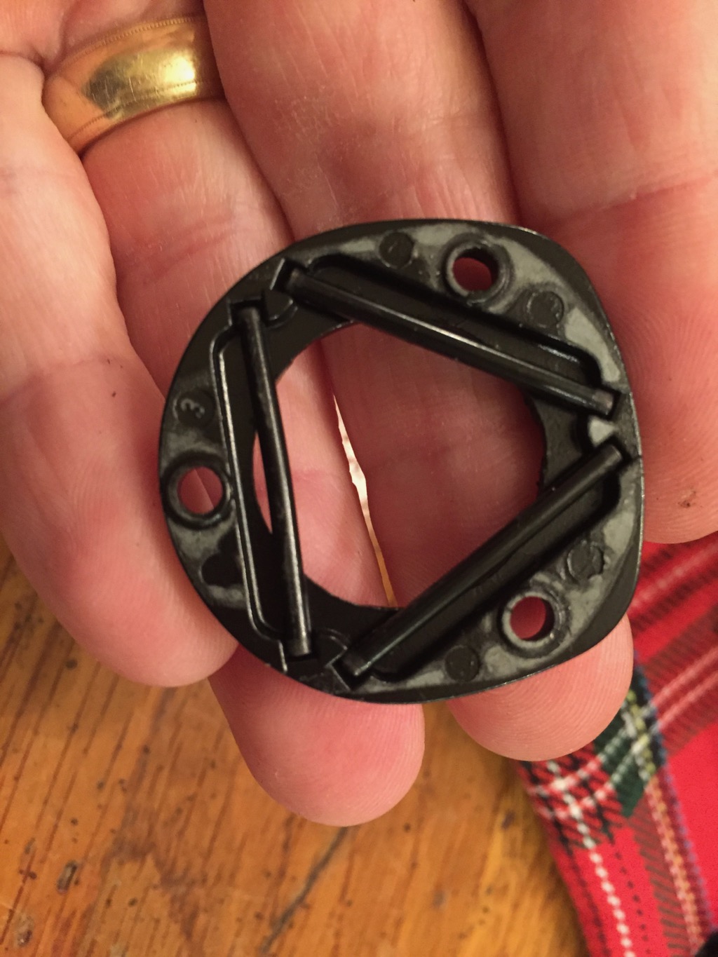

With the three screws removed, the rods can be removed:
Attachment 31833
The rods weren't bent bad, but enough to make it loose. I drew a straight line and placed the rods against the line to determine how bent they were. I lightly tapped them straight with a hammer, and re-assembled them.
Attachment 31834
