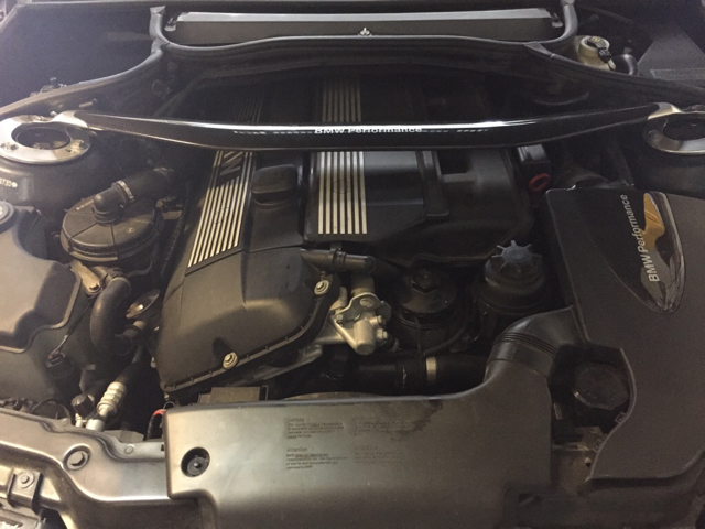

The 'no grill' grill. Looks good (I guess, since I can't see it. lol)
Oil and filter changed at 95,346.
And strut bar reinstalled.

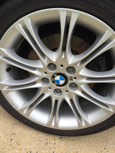

Colin installed new OEM center caps today. No more ghetto look.
Attachment 20804
Thumbs, iPhone, TaT.
New gas OEM cap installed as PM.

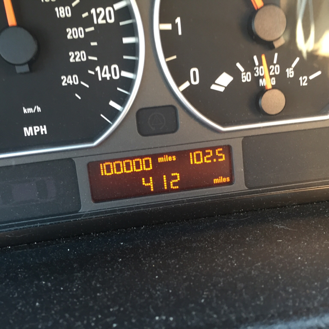

Milestone. 100k
Attachment 21421
Soo young.....lol
Congrats on the 100,000 miles! My car is sitting at 158,900 Kms so it will soon turn to 160,000 Kms and I get to celebrate the 100K miles :)
