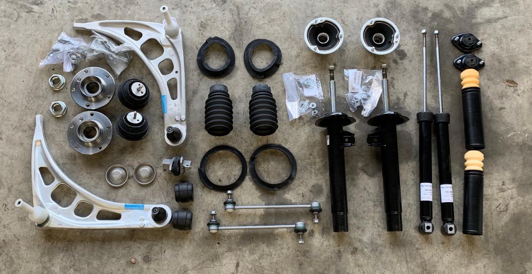

150k miles update : suspension refresh. I have most of the service recs since day #1 and only these 2 items were previously addressed:
90k miles: control arm bushings
126k miles: rear trailing arm bushings
Mafia member GeorgeH completed the job last week. I didn't have chance to drive a new ZHP back in the day but this must be very close to it. I decided to go with Sachs struts/shocks and find out why these cars got their fame. This is the list of parts :
31312282459 (1) LF strut
31312282460 (1) RF strut
31122341297 (1) LF control arm
31122341828 (1) RF control arm
31126783376 (1) CA bushing kit
31302290313 (2) F bump stop kit
31352241448 (2) Strut mount kit
31331091867 (2) Spring pad, F upper
31331096664 (2) Spring pad, F lower
31356780847 (2) Sway bar end link
33556751269 (2) Sway bar bushing
31106774714 (2) Suspension nut
32216769539 (2) Suspension nut
41114287198 (2) Shock tower reinforcement
33522282461 (2) Rear shock
33502290347 (2) R bump stop kit
33526754096 (2) Rear shock mount
33531136385 (2) Spring pad, R upper
33531094518 (2) Spring pad, R lower
George also replaced engine mounts, steering coupler, and front wheel bearings. I'm very happy with the results ! :thumbup

Awesome!
That's a good overhaul
Shitskins! That's like driving a new car again I bet!
Fantastic!! What are your initial impressions after the refresh?
Nice! Bet she's nice and crisp now.
