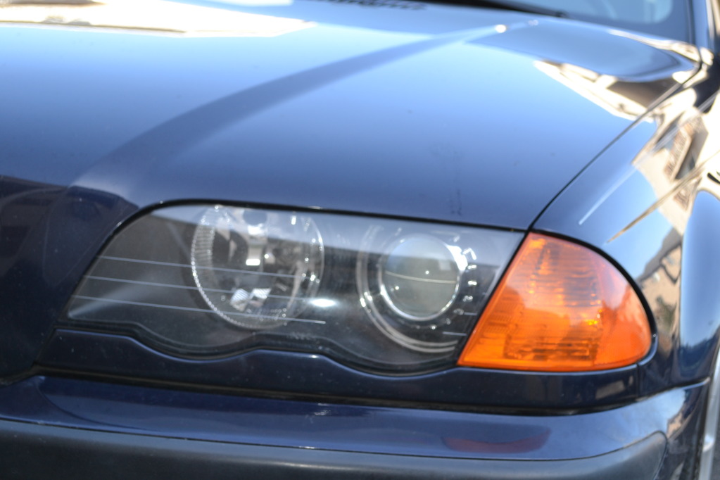

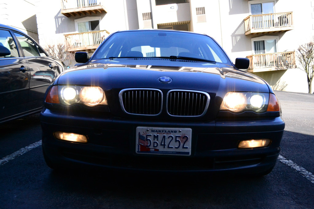

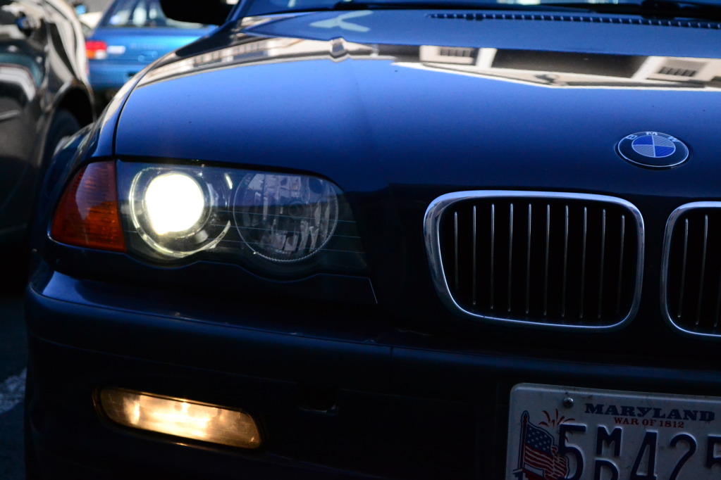

Got the FX-R retrofit done :)
Re-installed the lights today.
I'm absolutely impressed with the results. I can actually see now, and they still have a nice cutoff.
Dropped them off at Lightwerkz (very close to me) yesterday, and got them back today.
Big thanks to Caesar over at Lightwerkz!

That cutoff is baller.
HTC Thunderbolt+TT
Thank you. It's very close to what the ZKW's (were supposed to) look like.
