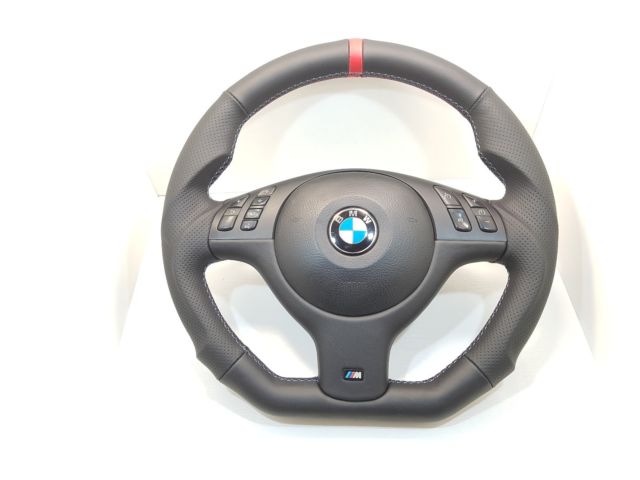

I can tell you in a couple weeks. I bought this one from the same seller a week or two ago (same one minus the witness mark at 12:00)
https://uploads.tapatalk-cdn.com/201...3289abdc5a.png
