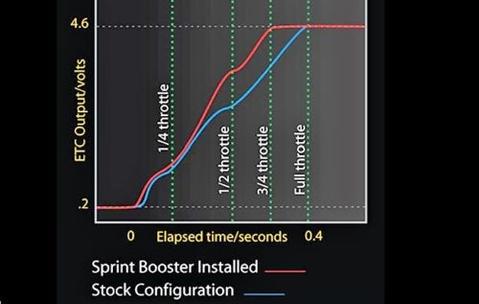

Yeah I've tried it on a 3.07 diff car and hated it. The throttle is way too touchy in all modes, and doesn't actually do anything that your foot can't solve by just pressing down on the pedal more.
Definitely not my experience either. I really liked it with just the tune and mild diff ratio upgrade. I left it on the second setting

I've driven your car, remember? :)
'Putting your foot down more' is really all the unit does according to all the graphs. It just takes the full pedal range and condenses it to a smaller pedal travel zone. But, its behavior is essentially the same as 'putting your foot down more'.
Here's the proof:
https://www.google.com/url?sa=i&sour...34015660907488Attachment 33654
