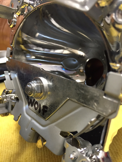

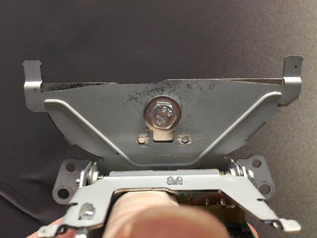

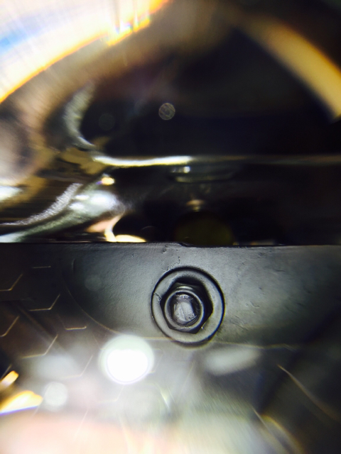

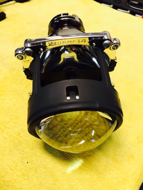

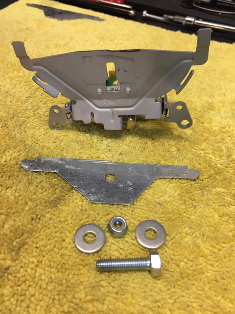

So the OCD kicked in and I decided to take my lights apart again and tweak the light pattern.
After installing the ZKW lenses the light output was way better but the pattern and cut off line was blurred.
I decided to make some WOLF industries shields. These took about 2 hours to make and perfect but in the end the cut off line was near perfect with a nice blue line!! Oh and that bolt is light weight aluminum. :cigar

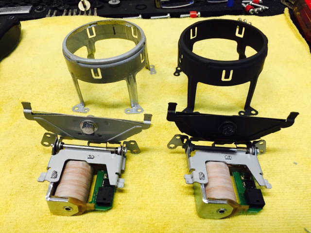

Painted the shields and lens holder with Hi Temp (2000 degree) flat black paint.
